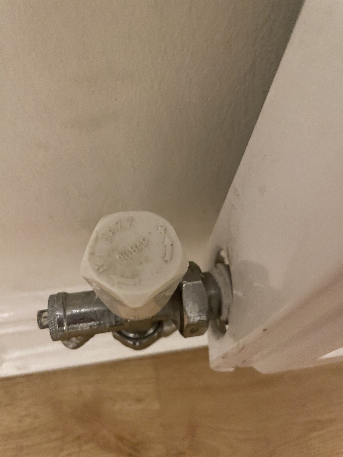

Problem seems to be that the upstairs and downstairs hallway radiators get really hot quick while the others seem to stay either lukewarm or barely warm at all.
Bled all the radiators but I’m suspecting a balancing issue. House is 2008 built so not old.
I don’t appear to have regular lock shields to do balancing however, I’ve got ones that are as my picture on all the radiators:
All these seem to be completely open on all the radiators, is this correct?!
I’ve got Drayton Smart TRV’s on most the radiators and the pins seem to be moving freely enough.
Appreciate any help
Andy
What valves did you replace with the Drayton’s? Is this a new issue as in it worked ok before? If all those are fully open I’d suspect it to be balancing too.
Was a mix of Siemens ones and Terrier. To be fair no I don’t think it was really working that well before either but I’ve only moved in fairly recently.
Crank down the lockshield on both hallway rads until they are barely open ,but still heat up. See what the resulting effect is it on the other rads.
