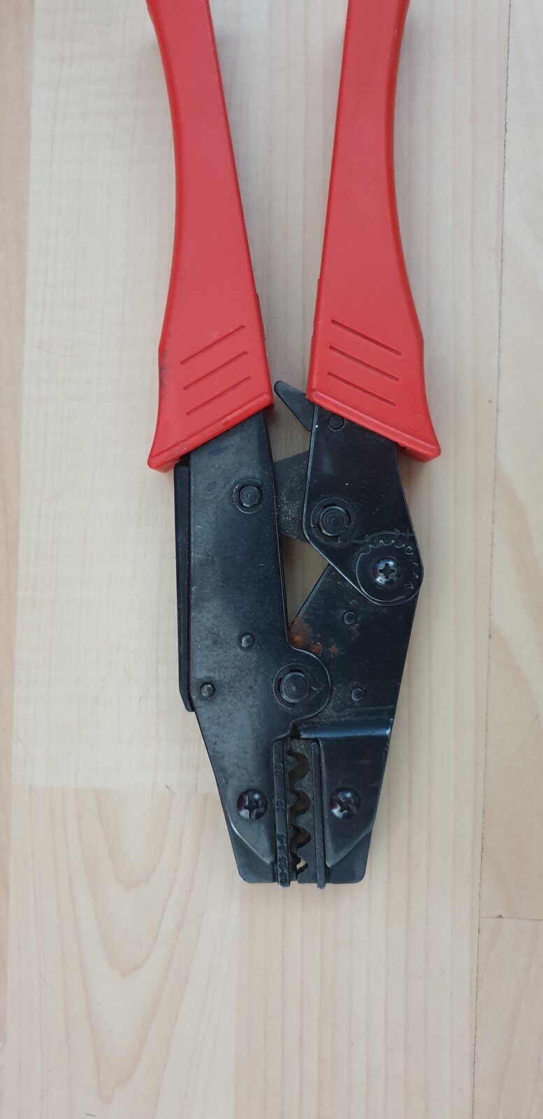

My two questions are, which size equates to my red spade connectors and will my ratchet crimper be suitable?
My crimper has a rounded receiving profile, others seem to have squarer profiles (what are the different usage applications?).

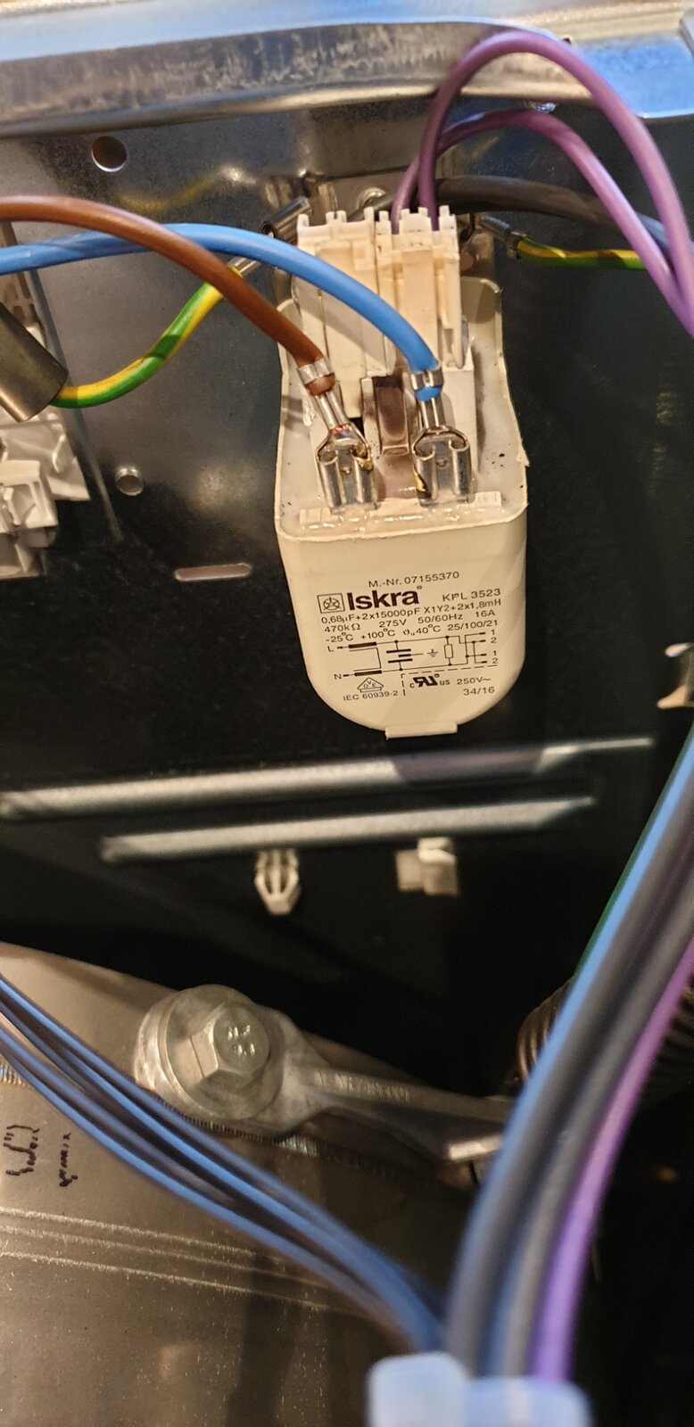

Here is a photo of the current flex entering the WM.
At some point in the past, the machine was pulled out and the flex slightly popped out. That resulted in the neutral spade connector coming off the male connector and hitting the live connection. You can see the arcing if you zoom in on the photo above.
I did purchase a 3m length of 1.5mm flex and fitted the insulated female connectors that I have to hand. The first connector that I crimped on passed the tug test, the next 3 failed, denting my confidence in the reliability of my crimping skills. I eventually fitted all 3 crimps but decided to leave the old flex in place (using pliers to squeeze the fittings tighter).
The original factory fitted crimps look like they crimp to both the stranded wires and the insulation. My primary question is whether my crimping tool will work with them. I am happy to buy a new crimping tool if need be.

If you have a crimping plier for plastic coated crimps, use plastic coated crimps.
Red insulated female spades will fit.
When you have crimped it on give it a good solid tug, if it comes off your crimping tool isn't up to the job.
Uninsulated crimps require different crimping pliers.
I've got a few sets, one cost £40 and another £70 odd but you need the right tool for the crimps.
