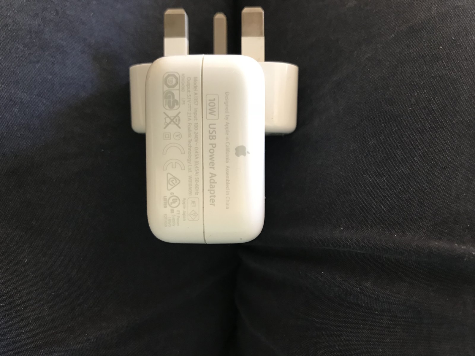

The outermost usb adaptor (both outermost units are one unit although they look separate) is a standard UK three pin iPad charger. Anyway, it’s worked fine all week and I’m going home today so winston1 can sleep safely tonight.

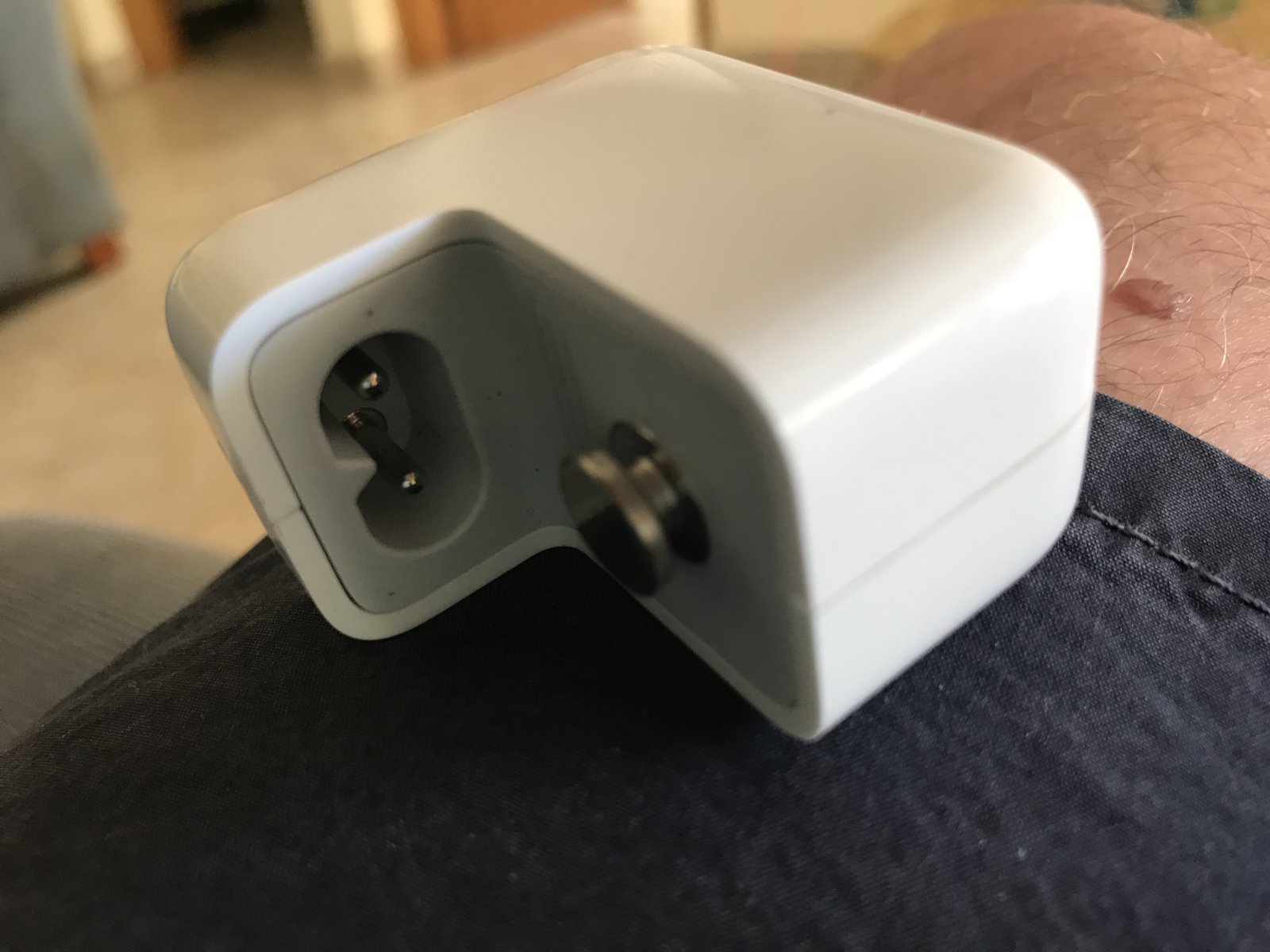

No they are separate. They will slide apart and a Euro or US part can be fitted. The Euro part is often supplied with the charger.
That’s why I said BOTH outermost units. Haven’t had anything other than a UK adaptor with the last half a dozen iPads we’ve bought - mini's, iPad Air 2 and iPad Pro so they must do special editions with UK/Euro/US adaptors just for you.
It does come apart, and although it is a 2 pin into a UK adaptor, it is not suitable for plugging into a euro socket.
It is a Chinese replacement product, not an OEM iPad/iPhone product, even though it is advertised as one.
I cannot see how it can be used with anything other than the supplied adaptor.
https://www.ebay.co.uk/p/Genuine-OE...m=152989371829&_trksid=p2047675.c100005.m1851
You’re half right. It is made in China but it’s a 100% guaranteed OEM Apple iPad charger.
