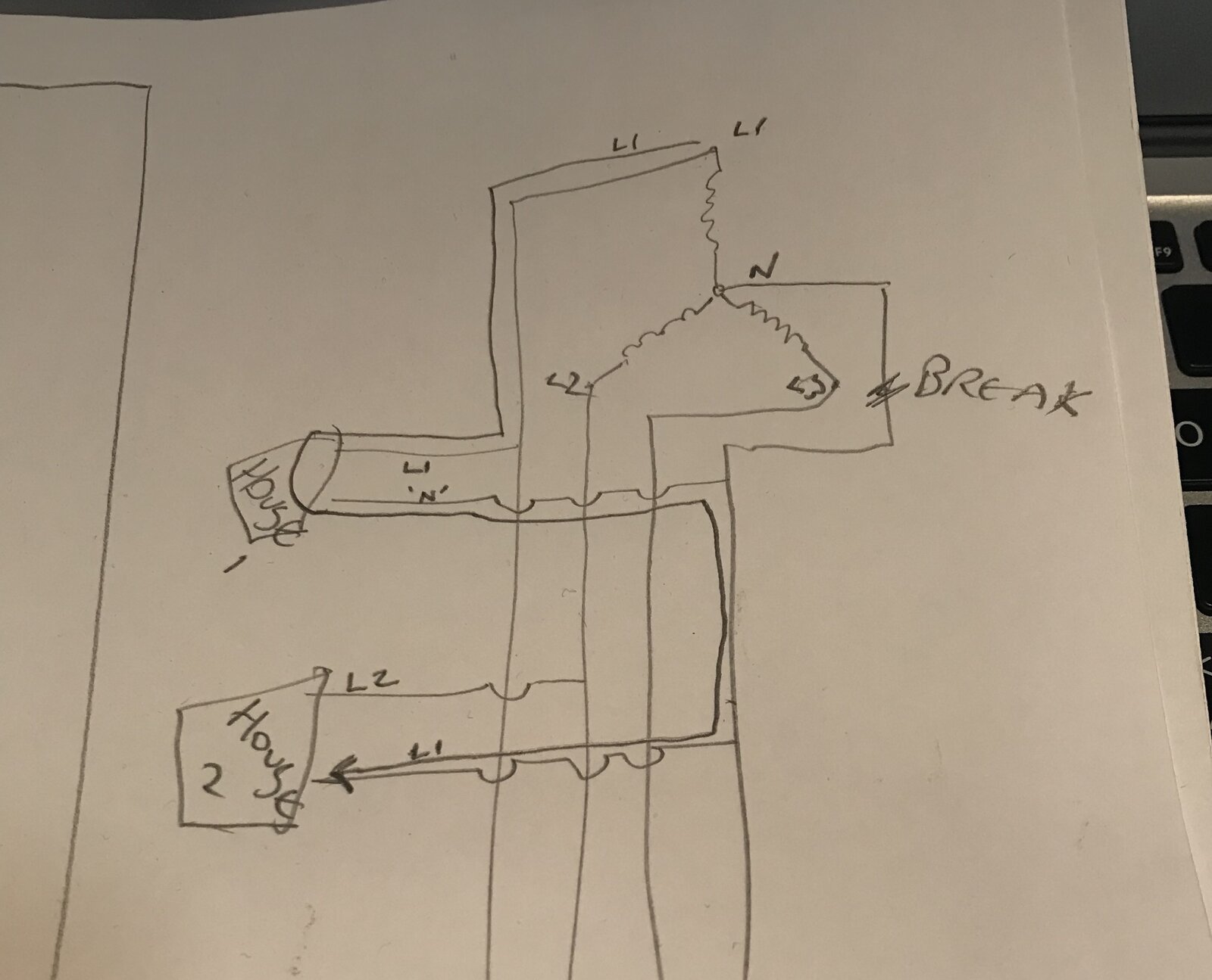

A lost neutral is often due to a castrophic event on the network, in one event I had some involvement in it was caused by a chiller unit incorrectly wired and when a contactor operated two phases were shorted together which blew only one 200A fuse in the dis board feeding the chiller and the 300A fuse in the other phase feeding the board. Additionally it took out the neutral bar connexion link.
The high load on the remaining unaffected phase pulled the failed neutral very close to it leaving the other phase to neutral very close to 400V, actually in those days it was far mor likely to be more like 420V.

Apologies for the crude drawing but hopefully it makes sense. House 1 is fed by L1 and N and has a heavy load connected. As the neutral is open circuit it will rise in potential to L1 voltage.
House 2 has low loading and is connected to L2 and the shared neutral which is now at L1 potential which will have a voltage of up to 400V depending on loading
House 3 has zero load as they’re on holiday.
If each of the houses were using exactly the same power then the neutral drops to 0V and the more out of balance the phases become the higher the neutral voltage.

Lost PEN situation is unrelated, SPDs will be of no use there or in any other situation where the supply voltage is too high. Overvoltage detection devices already exist and can be installed if required.
, I don't see how a voltage as great as that could appear in any (single-phase) installation, since the only pd of ~400V within the LV distribution network will be that between two phases.
Single phase supplies to dwellings are typically from a 3 phase transformer with a 3 phase cable in the street, one phase and NE tapped off of that cable for each house.
A break in the NE part of that cable before it connects to a selection of dwellings is disconnecting the neutral in a 3 phase system that has unbalanced single phase loads (each house), and the neutral point will shift depending on the loads connected. Some may get a lower voltage, some might get a relatively normal voltage, others could be significantly higher. The various voltages are likely to shift as multiple devices fail and disconnect from the system. Fire and destruction is inevitable.
