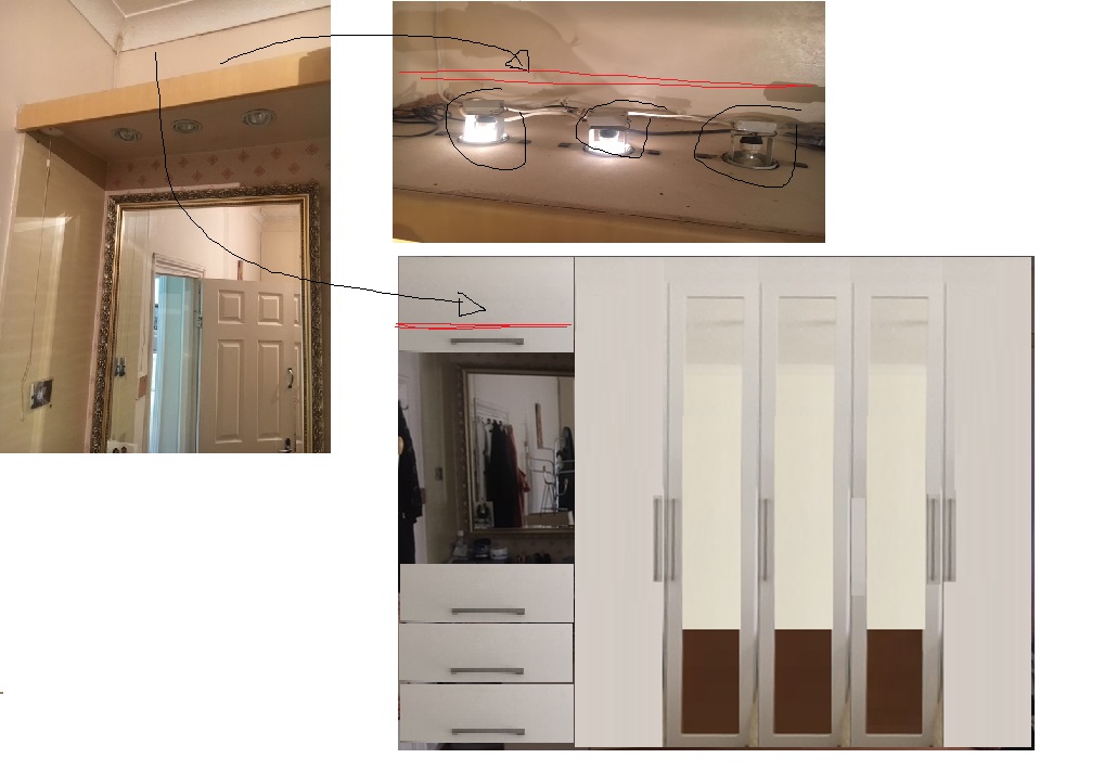

Hi all,
Im going to replace the creamish looking cupboards in my bedroom with white design as per pic.
as you can see there are some spotlights on top of current setup
new setup will be floor to ceiling
i wanted to know if its ok to have those spot lights as they are......but just cover them by placing a shelf (as per red line) in the new cupboards?
this will cover the spotlights basically - and still allow me to use some of the space in the pull out door i plan to have......
just wanted to know if it was risky - as they can get hot and currently have completely open air - but would be slightly enclosed in new setup....

Not recommended..
there are minimum clearances and so on..
plasterboard lining with fire hoods and a fan for ventilation?

No reason to think that the space he shows will not provide enough clearance.
F rated ones would be a good idea, the use of LED or CFL ones even better.
Halgen spotlights in wardrobes have burnt clothes that were piled up too high in the the wardrobe.
So if those are halogen lamps then there is a risk
so if i can get LED spotlights bulbs to fit on existing fitting and then ask the wardrobe fitter to leave a reasonable amount of space there - it would be ok?

well where the lights "Shine" of course is clear open area with just mirror as per pic.
above it is my worry......i just dont know how safe it is.........you can see from the pic i attached theres a lot of wires...i dont know if there is danger of over heating etc.....
any conclusive yes or no on safety of this would be much appreciated.....not sure i have that atm,......
