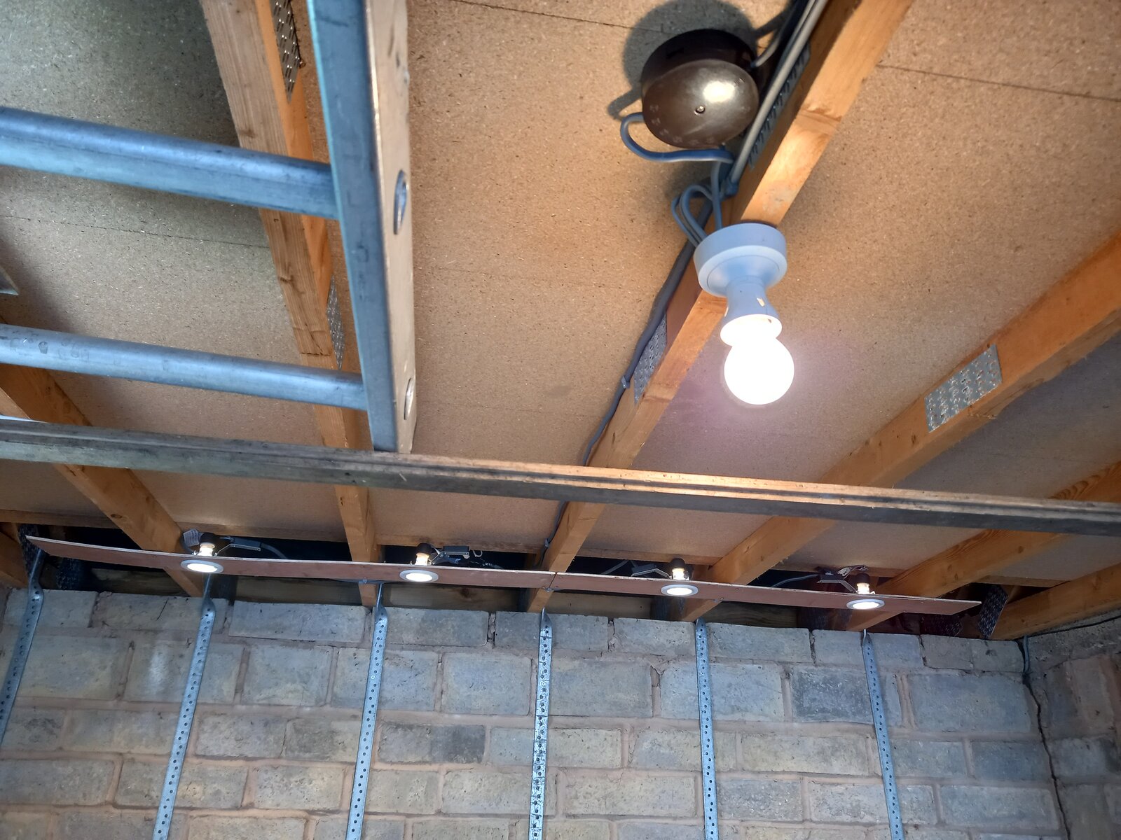

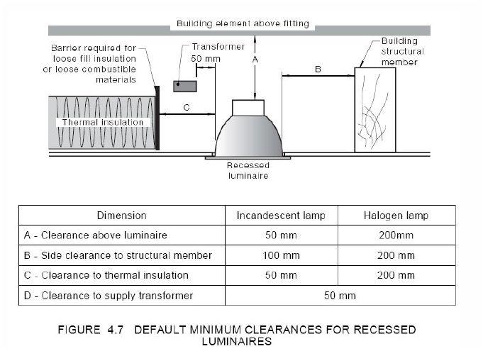

There is insufficient space bewteen the top of the lights and the wood above. Halogen lights get crazy hot. You may get away with that distance if you changed to LED lamps, but you stand a change of needing the fire brigade as they are. Do not turn them on and turn your back.
Useful tip. Thanks. The instructions that came with them said 100mm. They are admittedly, about 80mm.
I'll move them a bit further back. There is no overhead boarding at the wall edge.

You’ll not get replacement halogen lamps. So start with those and replace with LED GU10 bulbs when they blow. And they will.
We kept the halogen ones in and, as you predicted, that have blown one by one over the past few months. We've replaced with other halogens that we already had lying around and, some Led ones. Unfortunately, the Led ones have also blown again.
Any ideas why this would happen?
The Leds are presumably a lot cooler running. Would the blowing of an adjacent halogen one cause a 'surge' or whatever and cause the adjacent Led to blow?
In the meantime, we're simply replacing the blown ones with Leds and see how it goes.
Possibly.
In any case, using halogens is costing you 10x more in electricity.
Dispose of the halogens and replace all with LEDs.
