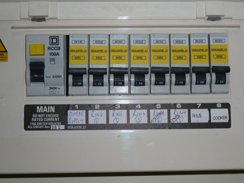

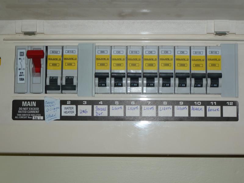

Perhaps you are getting RCBO's consused with MCB's, pictures of your boards would help here no end.
Cant you get RCBO's for the board?
The board already has RCBO's fitted, it was just the switch I wanted to replace with an RCCB.
Why? If there are RCBO's on the lighting circuits, what difference will and RCD upfront make? This will make the installation more dangerous.
Maybe I am getting confused, they must be MCB's then...
Yes, those are MCBs.
