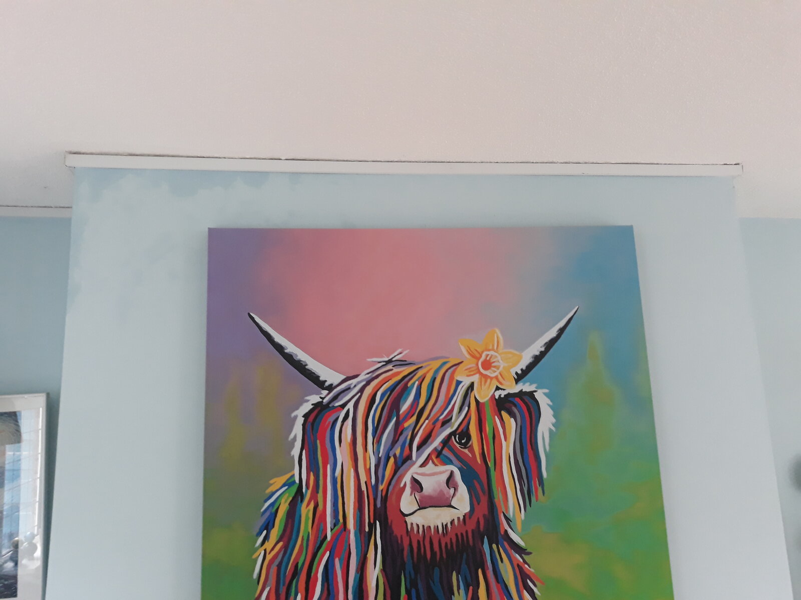

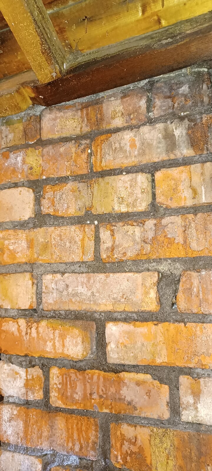

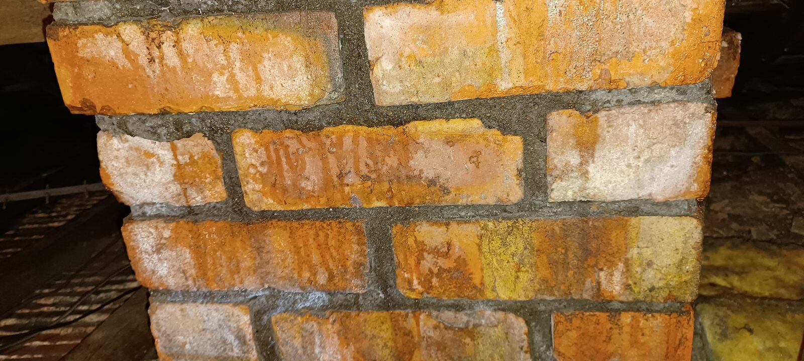

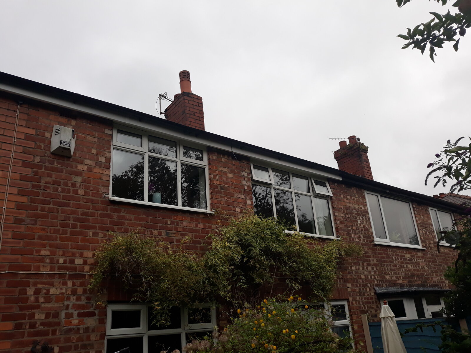

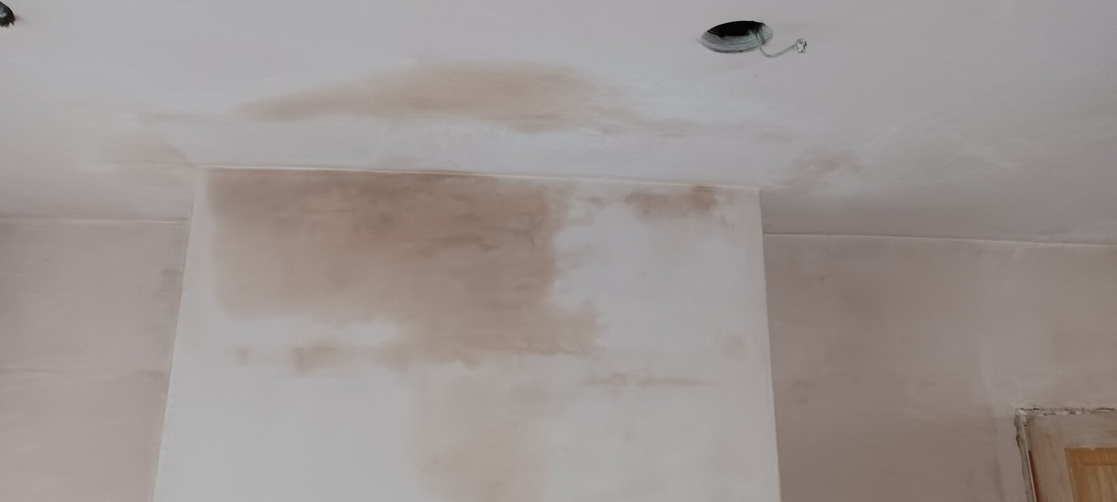

Some Pics. Let me know if anything more required

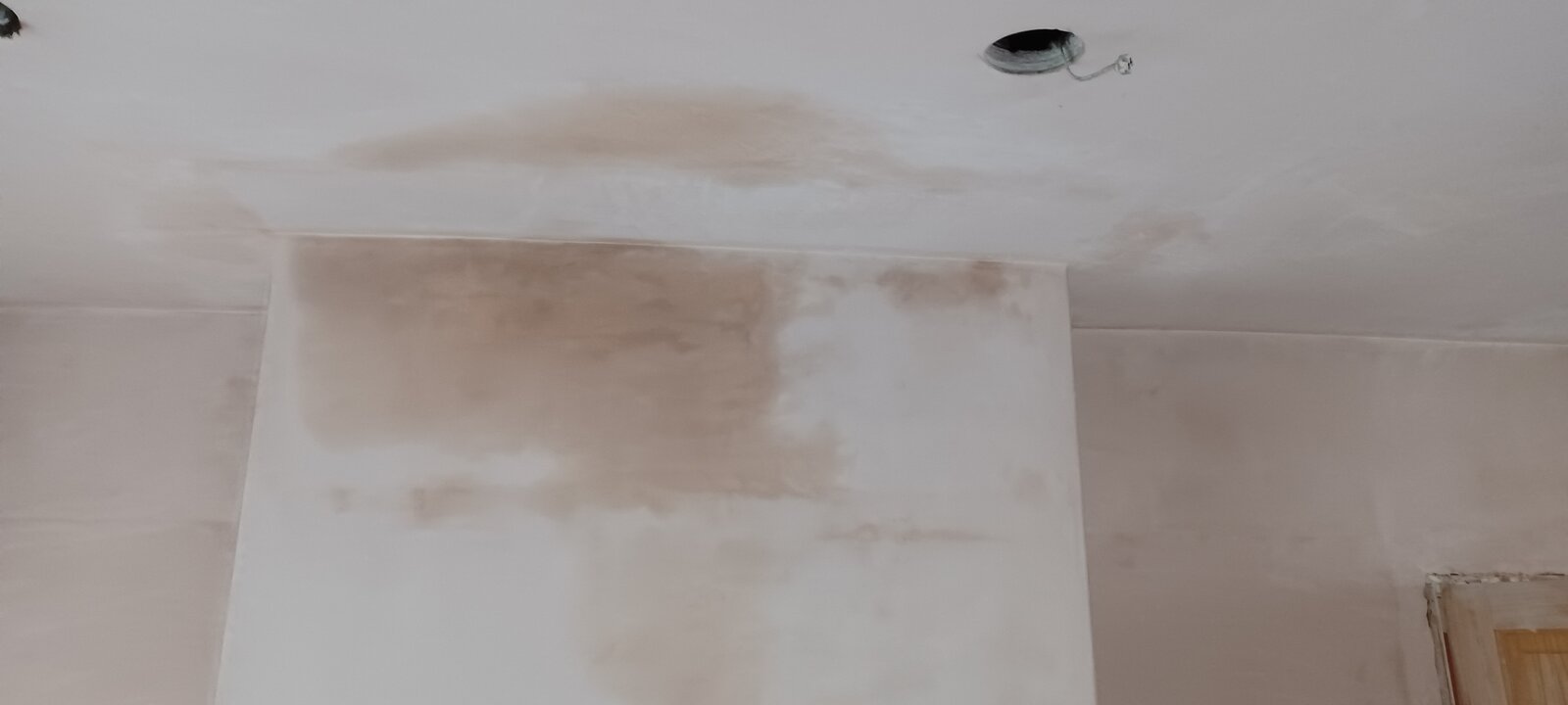

Wall is after being skimmed. Took ages to dry compared to other Parts of the Room

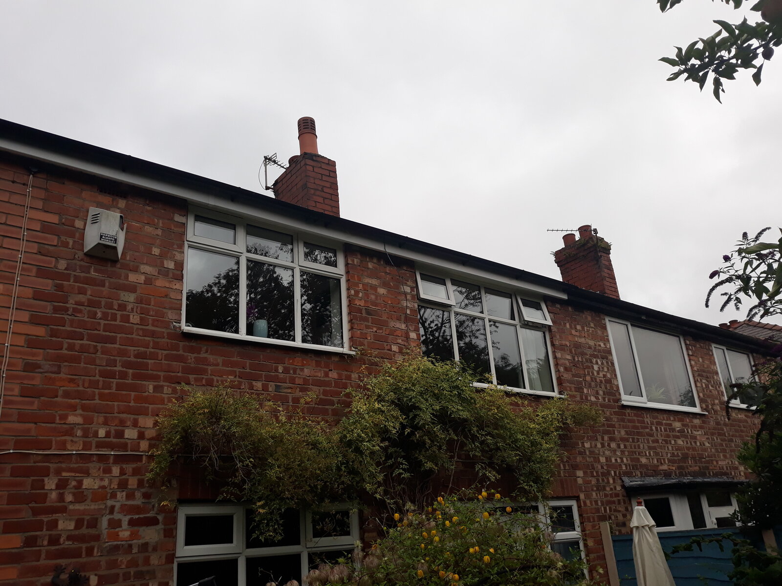

My Chimney is on the Left

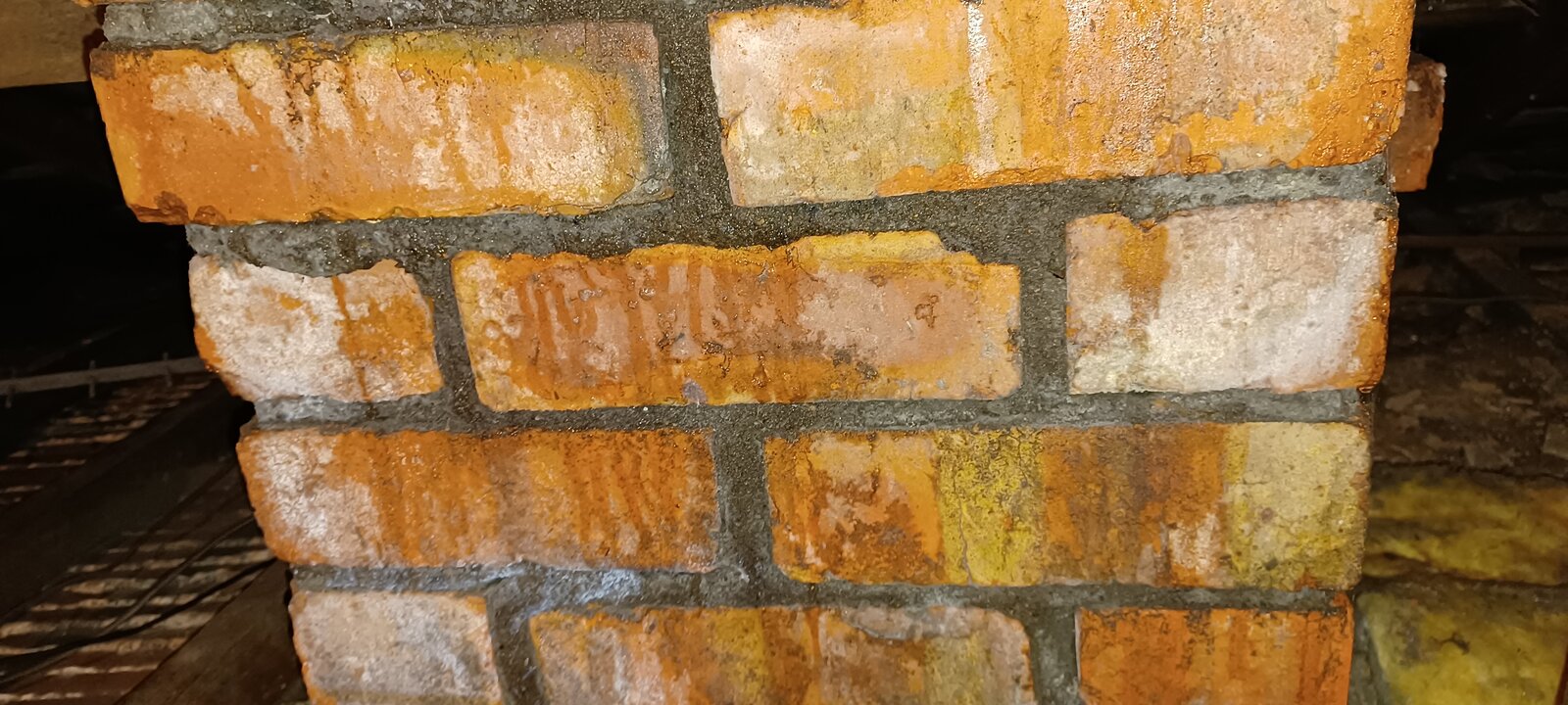

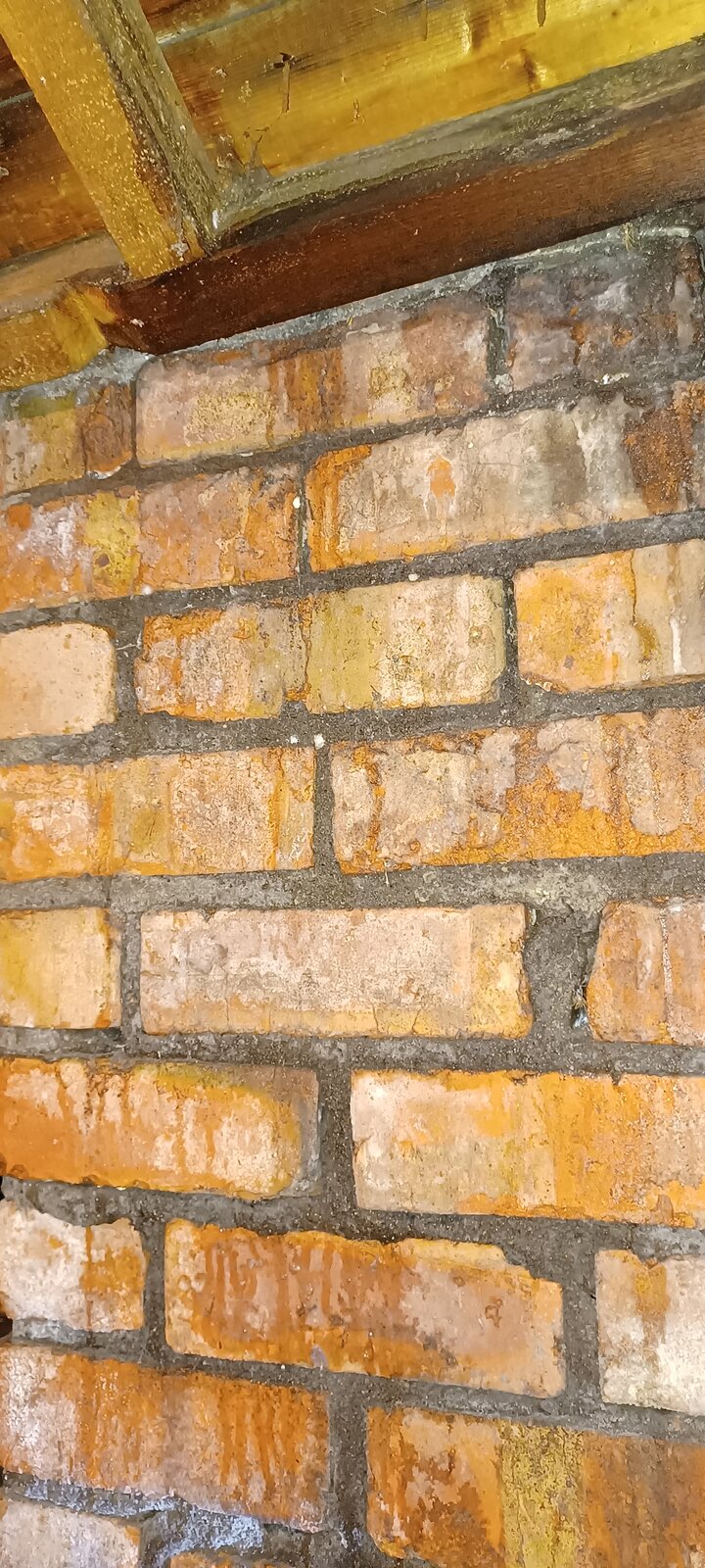

Brick Pics are from the Loft when it was rain very heavily

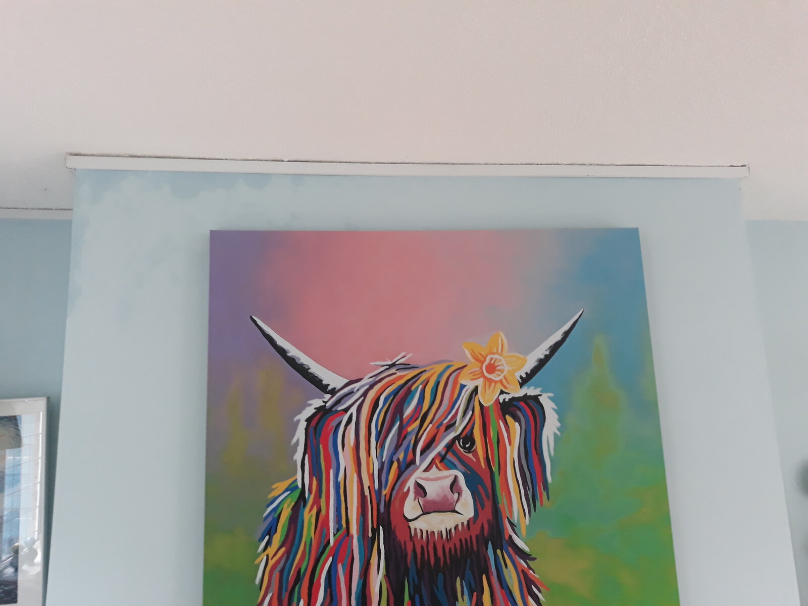

Blue Wall is downstairs before any Chimney work was done. Still about the same

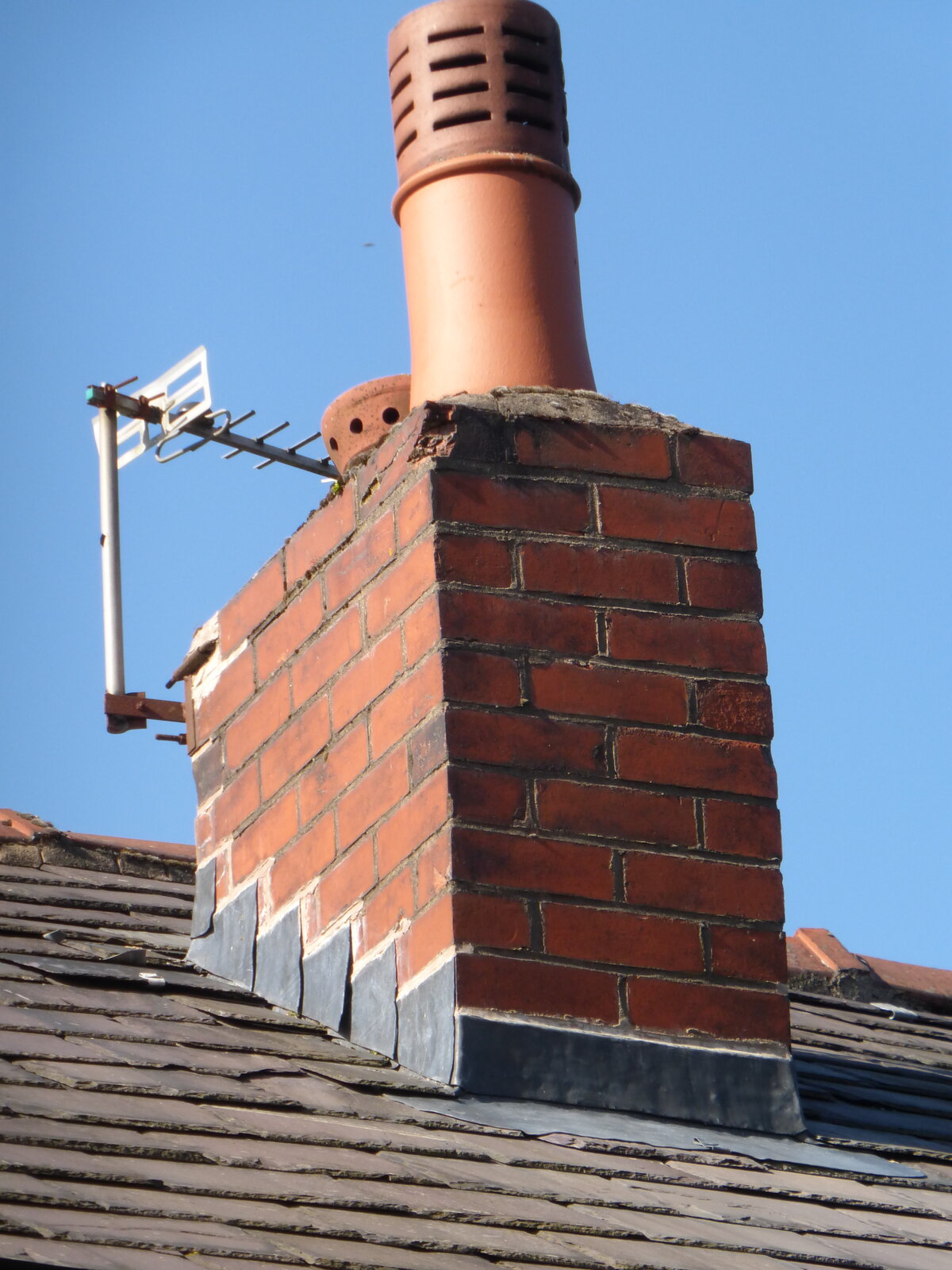

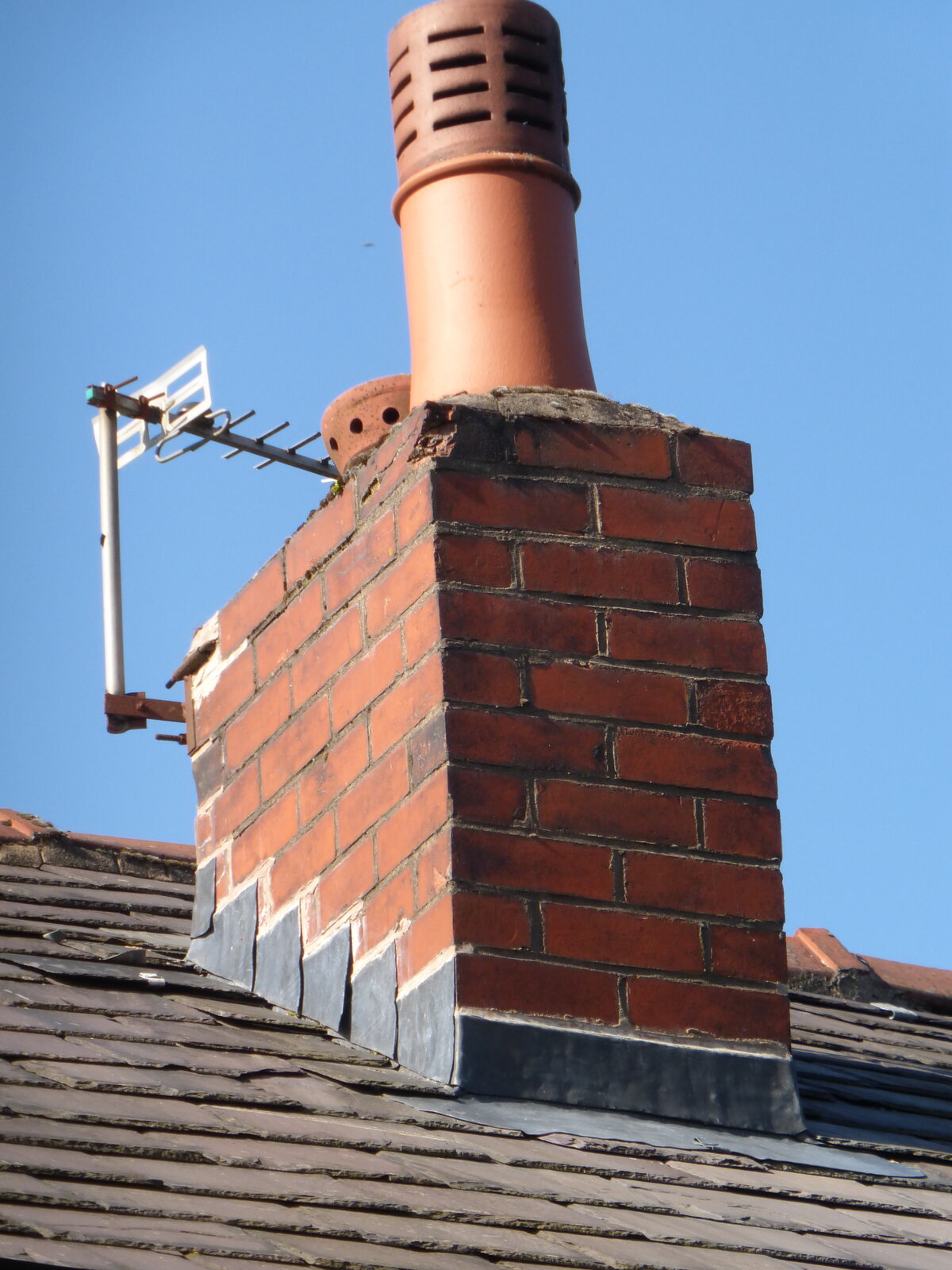

Is your chimney the nearest one in the pic with one big pot on it?
If yes, I have 2 questions;
Where did the person who repointed it tie up their horse?
How did the roofer who said it was fine get his Labrador up there?
Pic is from before any Work was done.
Raining but will try to get to get a current Pic
What can you see?
Very murky photo but there's half a brick missing on the top corner of the stack & the haunching doesn't look very solid.
There's at least 10mm fresh air between each brick, ideal for allowing water to soak the structure.
Can't see the flashing.
