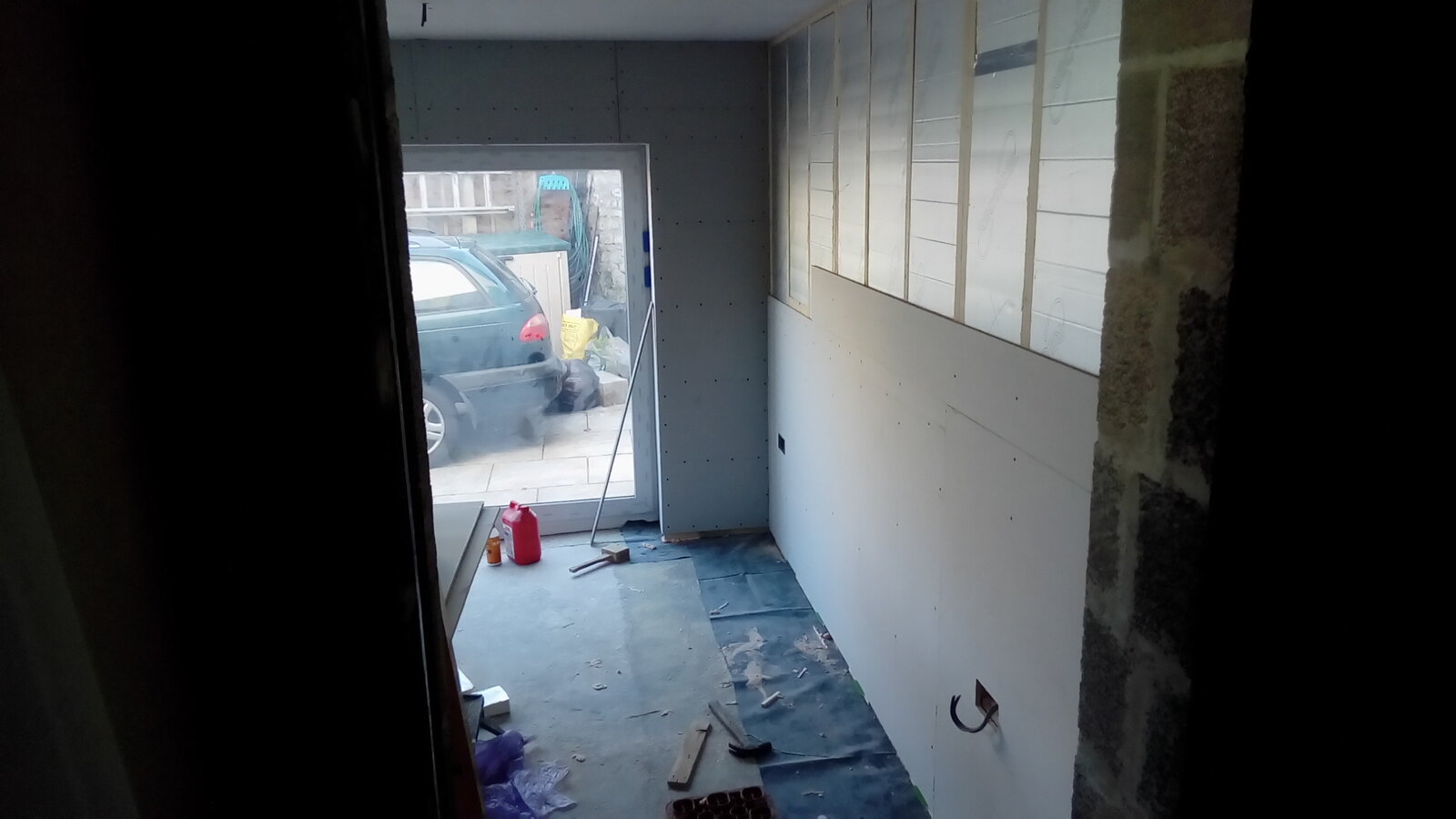

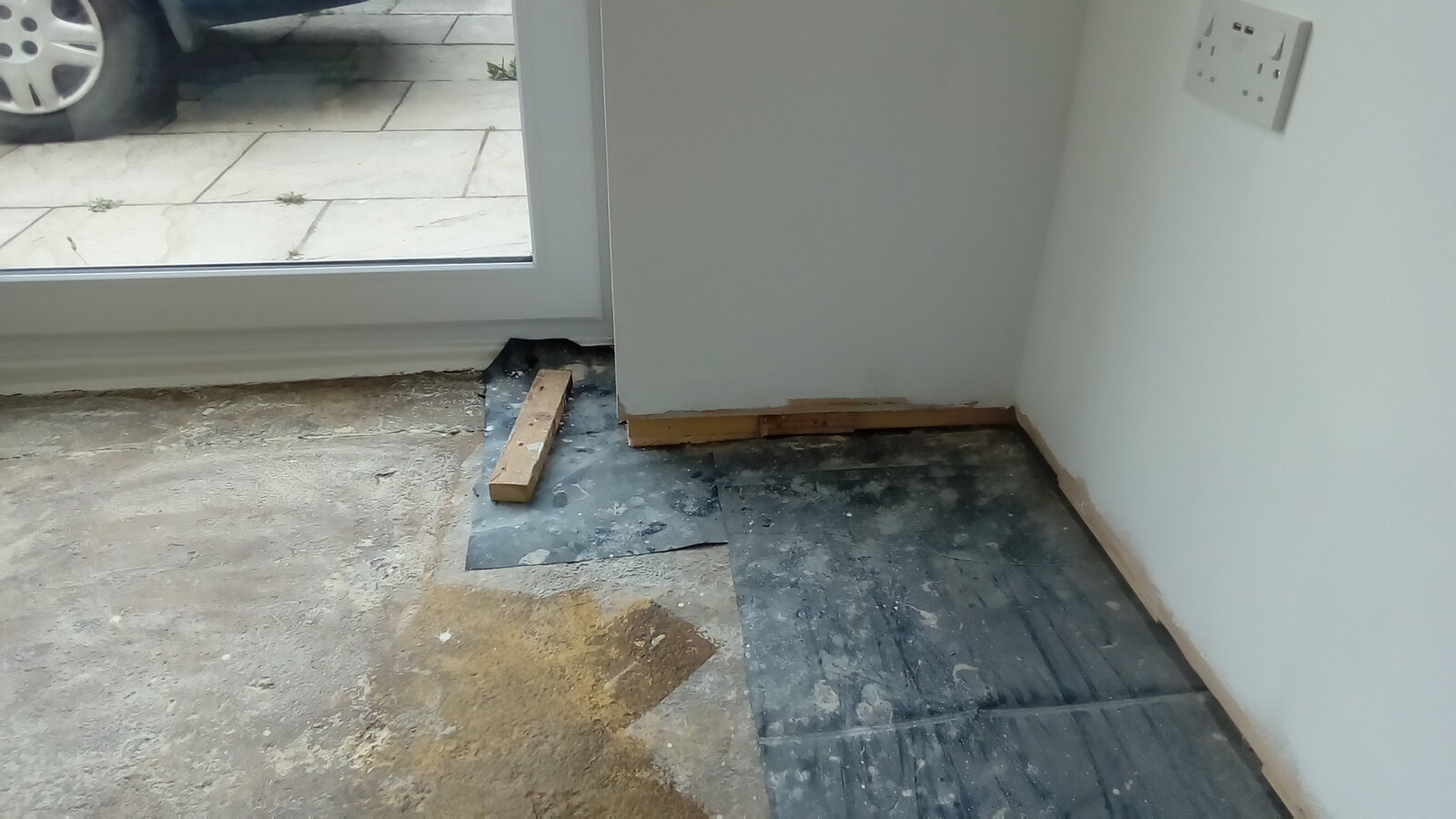

In the UK, that is. Easily available in the US and Oz but I can't find the right search terminology to source any in the UK..
To fix sub floor cls, on membrane, to conc. base. I sealed with Sikka rapid dpm and will completely cover with membrane too.

For your job, where there is not much force and it is just to hold steady, a stainless coach screw in a plasplug would do.
It's more to stop it springing up adjacent to where any significant weight might be applied, that's why I wanted the threaded option.
