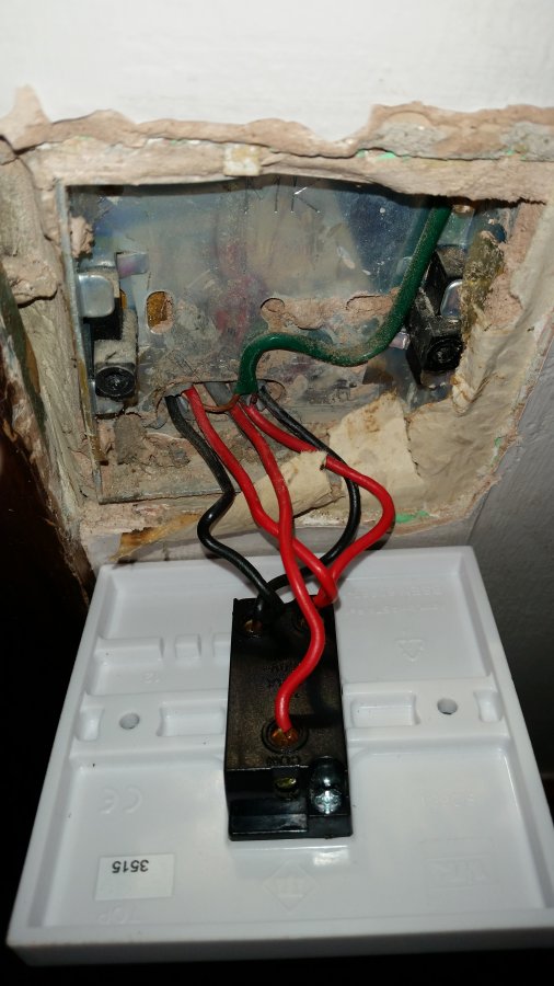

Here is a picture of my downstairs and upstairs switches after making the changes suggested by spark123, the upstairs light works correctly but the downstairs does not at all,
