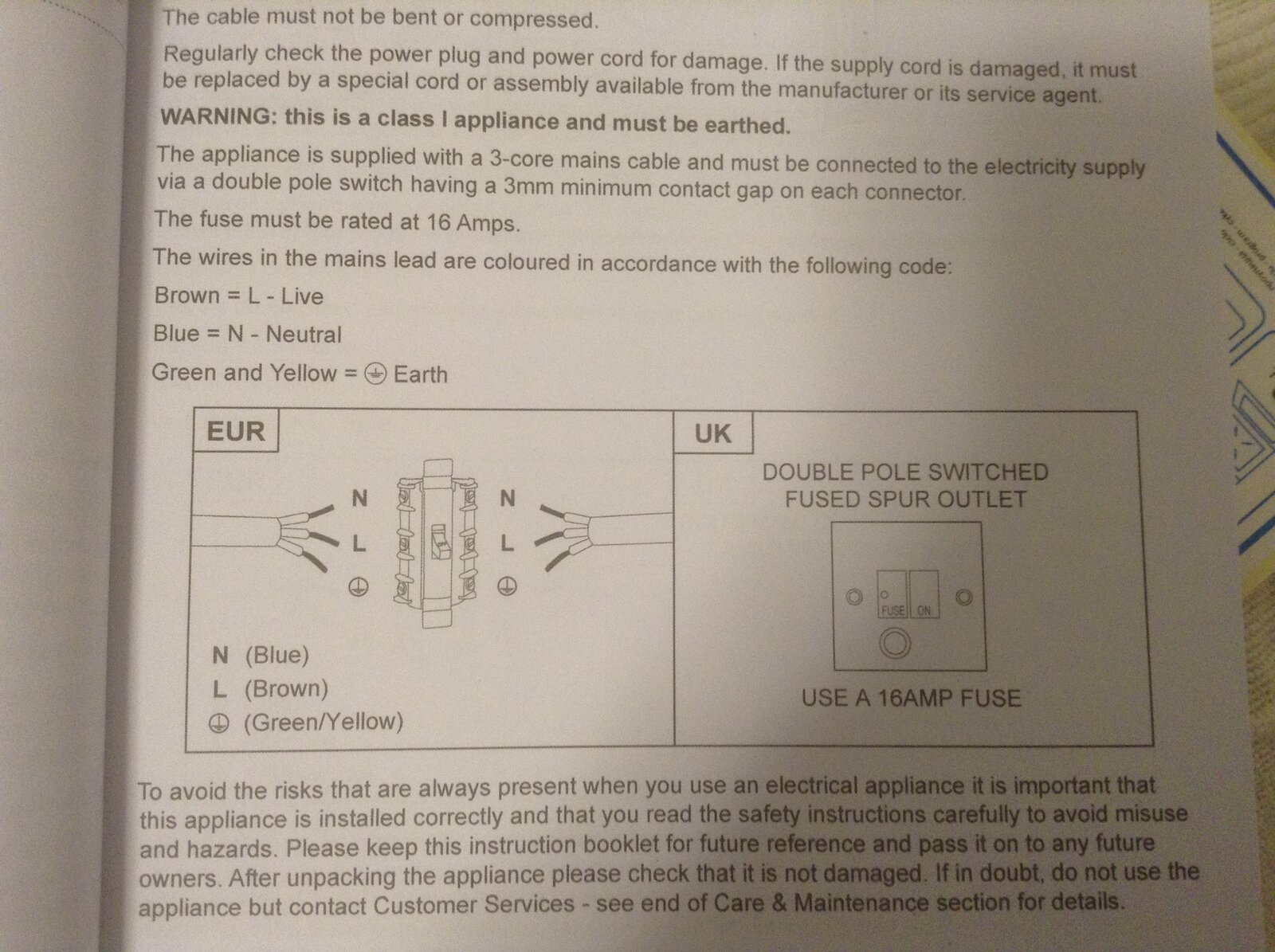

pretty sure that when I installed mine, the instructions clearly stated that an isolator was needed.
They might have but The Electrical Regulations do not require one.
In what way do you think it would affect the fan?
Manufacturers instructions override the regs
They don't, and they are frequently wrong.
Here is an example of wrong manufacturers instructions.
Readers should be aware that the notes relative to 536.4.203 state that if the assembly deviates from the original manufacturers’ instructions, then the person introducing that deviation becomes the manufacturer. So if you have an installation that requires non-standard arrangements, talk to the manufacturer about how to provide this in a compliant manner. Using unapproved parts will invalidate manufacturer guarantees and may result in an unsafe installation.
That is essentially for building consumer units out of parts from different vendors. It has nothing to do with whether you must use an isolation switch.
