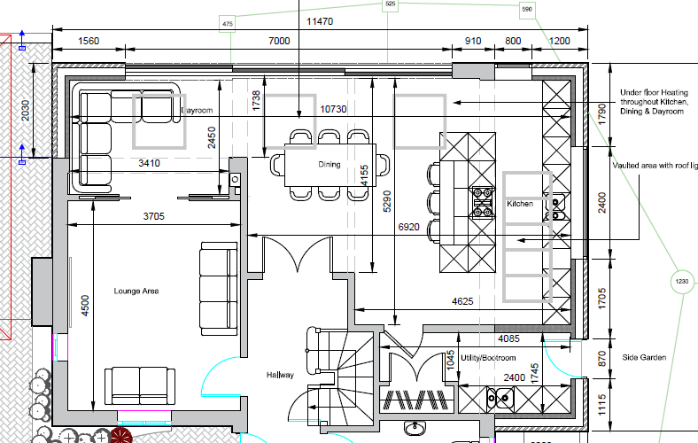

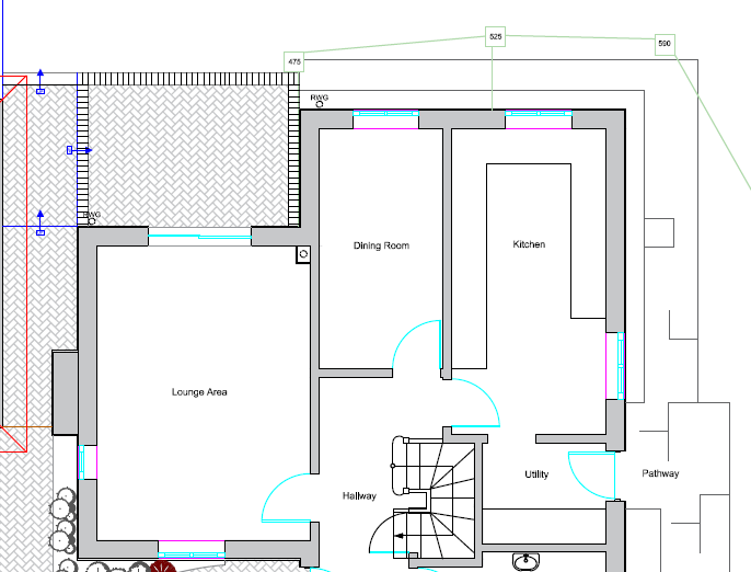

We are planning on an extension and remodel of the back and side of our house (Please see plans attached).
We have received a few SE quotes where the beams to be used are different in number.
1. The first SE quote has been for 4 internal beams and 1 beam over the sliding doors.
2. The second SE quote has been for 1 goal post and 7 internal beams.
The first quote SE has sent a sketch of his proposals but I cannot seem to get one from the SE of the second quote.
Would any one have an idea of why we have been quoted over 7 internal beams for the extension?
Could they be double beams and sould that be the best way to go?
Also would there be a need for any columns to support any of these beems or are the masonary calculations just fine?
All advice is appreciated
Before:-
After:-

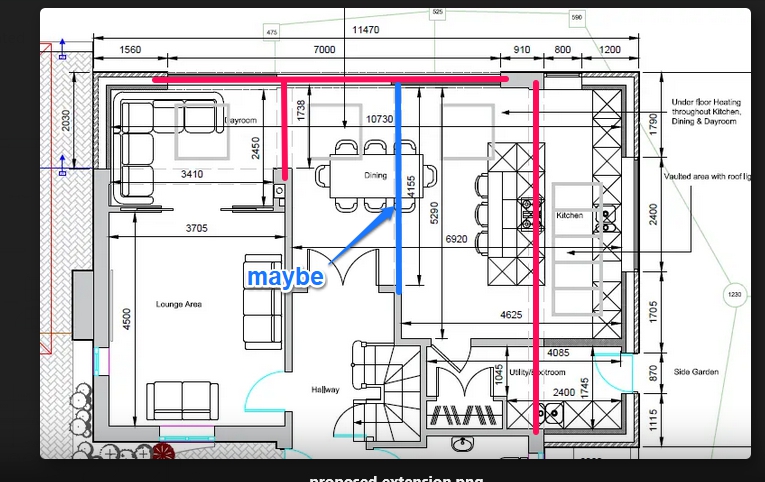

I've never had an SE quote where the SE specified how many beams would be required, let alone a sketch.
I can't make head or tail of those drawings. Where are the beams supposed to be?
Normally, whoever draws the plans works out where beams are needed and then if he is not able, he gets an engineer to design those beams. You don't give a drawing to an engineer and ask for random beams!
In engineering terms, a beam is the thing that spans across an opening and that beam may be made up of one or several steel beams, boxes or channels, or timber. It's still one "beam" and one calculation and one price for the "beam"
You'll need a beam in the red locations and maybe the blue, depending on the floor joists above.

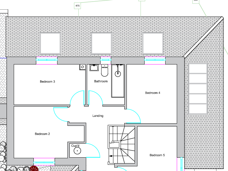

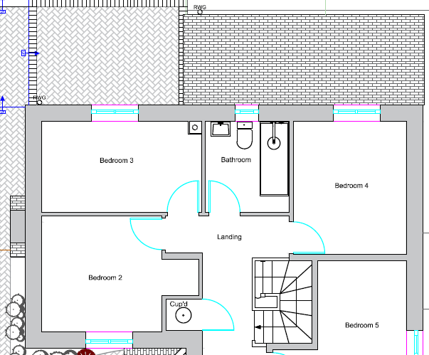

I should have added the first floor current plan (attached) as it is not changing so might affect the direction of the steels.
Existing first floor
Final first floor
We were hoping for the internal steels to be positioned horizontally.
Will the longer steels (just over 7m and just under 8m) require steel columns or is 910mm stated sufficient to house the piers that hold them?
I'm confused now, is that the existing first floor plan? It's helpful is you post all four plans together, existing ground & first, proposed ground & first.
