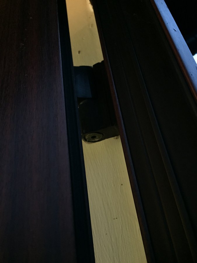

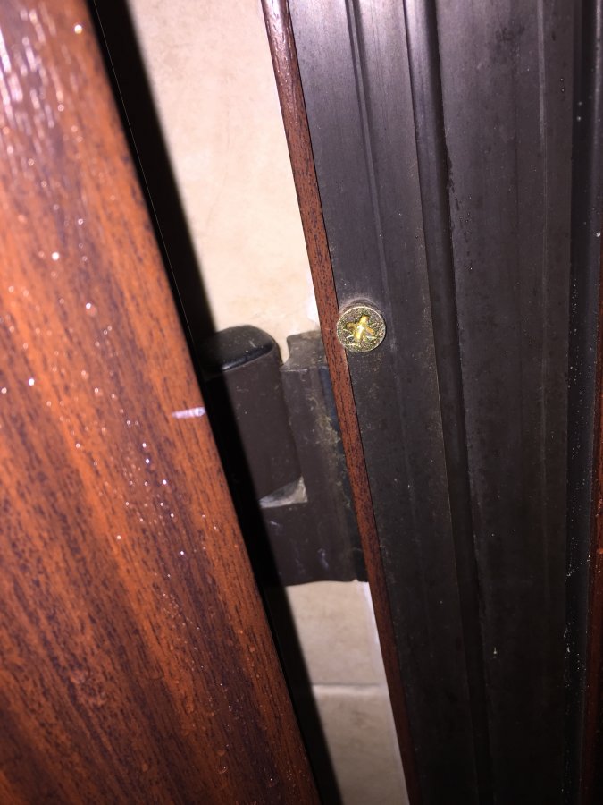

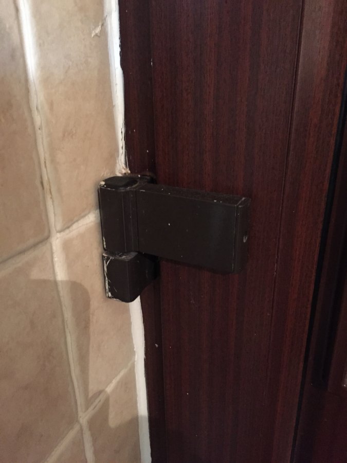

If its just a little adjustment needed then you may get away with just adjusting it on the hinges. We will need a pic of your hinges to work out which ones you have.
Here are some photo's of my hinges

Should be a nice easy one.
In your 2nd pic you can see an Allen key hole under the hinge, Should be a 4mm Allen key. Just wind them clockwise.
Do all 3 equally so count how many turns you do. Raise the door 2-3mm and see if it gets easier to lock
Thanks so basically each time I wind them clockwise, the door gets raised slightly?
I tried it out, I noticed some of the hinges were more loose than others. The resistance whilst lifting the handle up is still there a tiny bit but it's much better than before!
