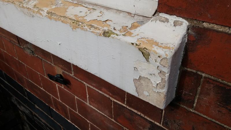

We have stone window sills and need to.sort them out properly. Here's what we have....

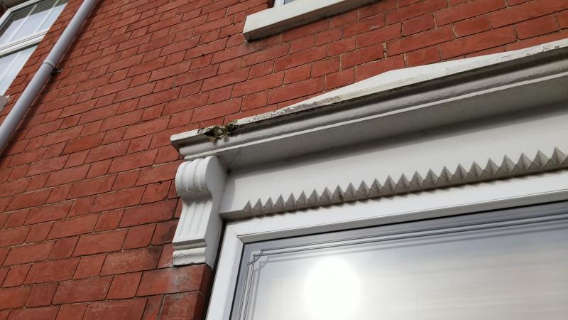

Here's the too of the window and you can see some damage from a falling tile..
First. What's the best way to repair the damage to the sills and the broken bit above the window? Second, what shall we do to repaint them in a way that will last?

Toupret or Bonda 2 part works well.
Bonda is my personal favourite for minor repairs, seam filling and dinks caused by careless window cleaners. It's very similar to plastic padding and sets in an hour.
Toupret is a water add cement based filler, it sets soft and allows sanding, shaping and reworking for about 36 hours. Then it fully cures to a hard finish.
Unfortunately the paint I'd suggest comes in 5 litre tins (duplex weather shield all seasons oil base). Since you don't need anything more than a litre I suggest any trade quality external gloss and uc system.

Is this the bonds stuff? http://www.decoratingdirect.co.uk/viewprod/b/BONDF/
How quickly can it be painted over and will it blend in to the stone? Can it be used ok in the large chunk missing from the top of the window in the picture?
It is the item I suggested.
Anything under 20mm thick will be rock hard in 2 hours, over that size it needs half a day or so.
Once set you sand back and or shape it then undercoat and top coats. After sanding it's a light to mid grey finish and is easily obscured via uc and top coats.
