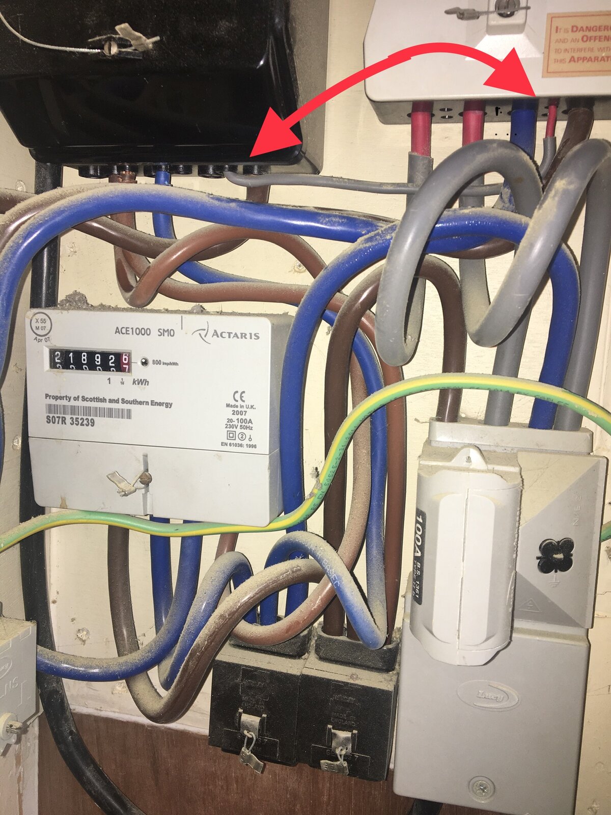

I’ve kept an eye on what the meter is up to at the point the tarrifs change for the 24hr circuit - it seems to be clean switches of the whole load between ‘normal’ and ‘low’ (that’s how the meter is labelled).
So it’s one or t’other (unlike Total Heating Total Control which has the additional circuit/tarrif for 24hr heating)
Now I'm confused on how your system works as the Teleswitch seems to switch the power to the NSH CU on the flexible rate and also control the E7 which seems to feed the 24Hr CU. I don't know enough about Teleswitches to know if they are capable of doing those two services at different times.
I was confused too as there didn’t seem to be enough tails for the teleswitch to be controlling both meters. But I just noticed an additional smaller cable connecting the teleswitch and 24hr meter (picture attached). It’s too small to carry much load so I assume it’s used for triggering the 24hr meter to switch between ‘normal’ and ‘low’

My apologies. When I said “one or t’other” I only meant the two rates on the 24hr meter. The storage heater circuit is independent of those. Both meters appear to be controlled by the same teleswitch but their schedules are independent. I probably confused matters by dropping Total Heating Total Control into the conversation earlier.
If you have a look at my previous post with the tarrifs/ times you’ll see that there are many times of the day that the storage heater circuit is available during 24hr peak rate. Even during off-peak, the storage heater tarrif is a bit cheaper.
It might be penny pinching but it’s irksome to think that if I wire the panel heater only to the 24hr supply then several times a day there will be electricity available behind a blank plate a few centimetres away that costs about half the price! :)

There are 2 meters and a Teleswitch, this is the info supplied by OP
Below are the supply times, and the tariff details are in the attached image.
