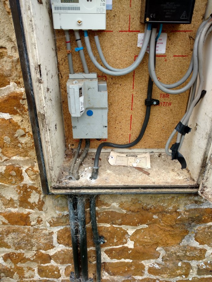

I live in a old house with a c.1920's meter attached to the side out the house. Despite my best effort, electricity bills seem unusually large. Please see picture attached - the first black cable on the left below what I think is a fusebox is (I think attached the streetlight - it goes underground and pops out again 8 feet away)
Might I be paying for this streetlights electricity? Image also here https://ibb.co/egLLmQ
The first black cable (from left to right) is the streetlight, the middle is (i assume) the main cable to my house, and the third is a new extenstion to an outbuilding.
Thoughts appreciated.

no, it looks like the service head is just being used as a junction box. The cable to the street lights is not coming off your meter. It is not a 1920's meter. More like 2000's
Street lights are usually "unmetered supplies" and the local authority pays a flat-rate based on typical usage for all their lamps.

The cable you say is the cable to the street light is connected directly to the incoming mains cable at the main fuse. Hence it is connected before the meter. The power to the street light is therefore not going through your meter.
As others have said, the streetlight is not connected to your meter.
Thanks. Sorry I meant a 1920's streetlight. The meter is obviously new. Cheers
Easy enough to show yourself that you are not.
After dark turn off all the main switches in all of the CUs in your house and outbuilding, and (with a torch if necessary) go and watch the meter, which will have stopped.

Could be a meter fault. Those new electronic meters have been known to over read.
There's an easier way. After dark turn off all the main switches in all of the CUs in your house and outbuilding and (a torch may be necessary), go and watch the streetlight, to see if it is still illuminated.

There should be an isolator fitted to that supply cable to you're outbuilding if it's more than 3 meters to the CU in the outbuilding. And why are there taped up cables coming from the house ? Where's the earth ?:confused:
DS
TT supply?
Taped up were probably E7 supply
Yes, could be. But in view of the lack of isolator i would want to confirm the earthing arrangement. :cautious: I never assume !
