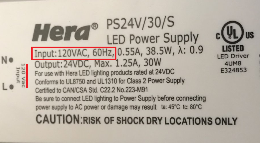

Putting 240 volts into this power supply may have damaged it beyond repair

Presumably the 120v version is for the continent and other countries supporting the standard. Could there be a use for this in UK residential market?

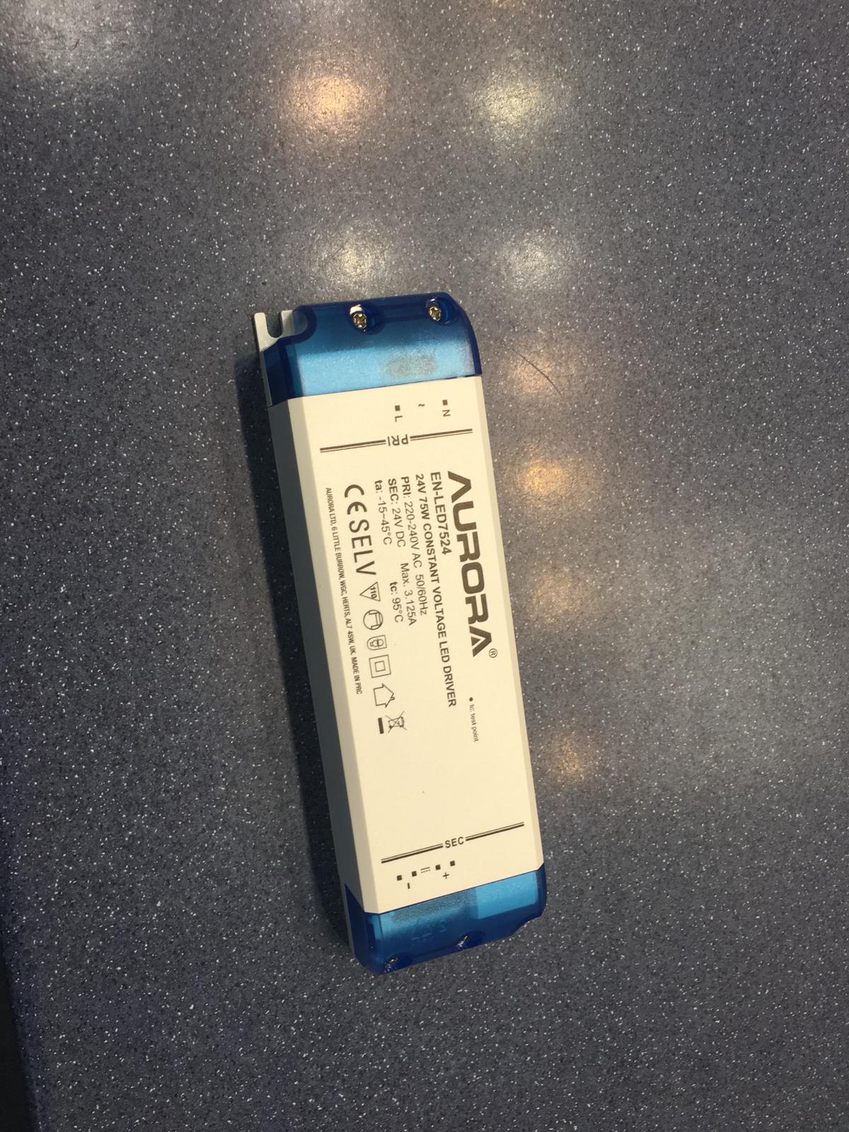

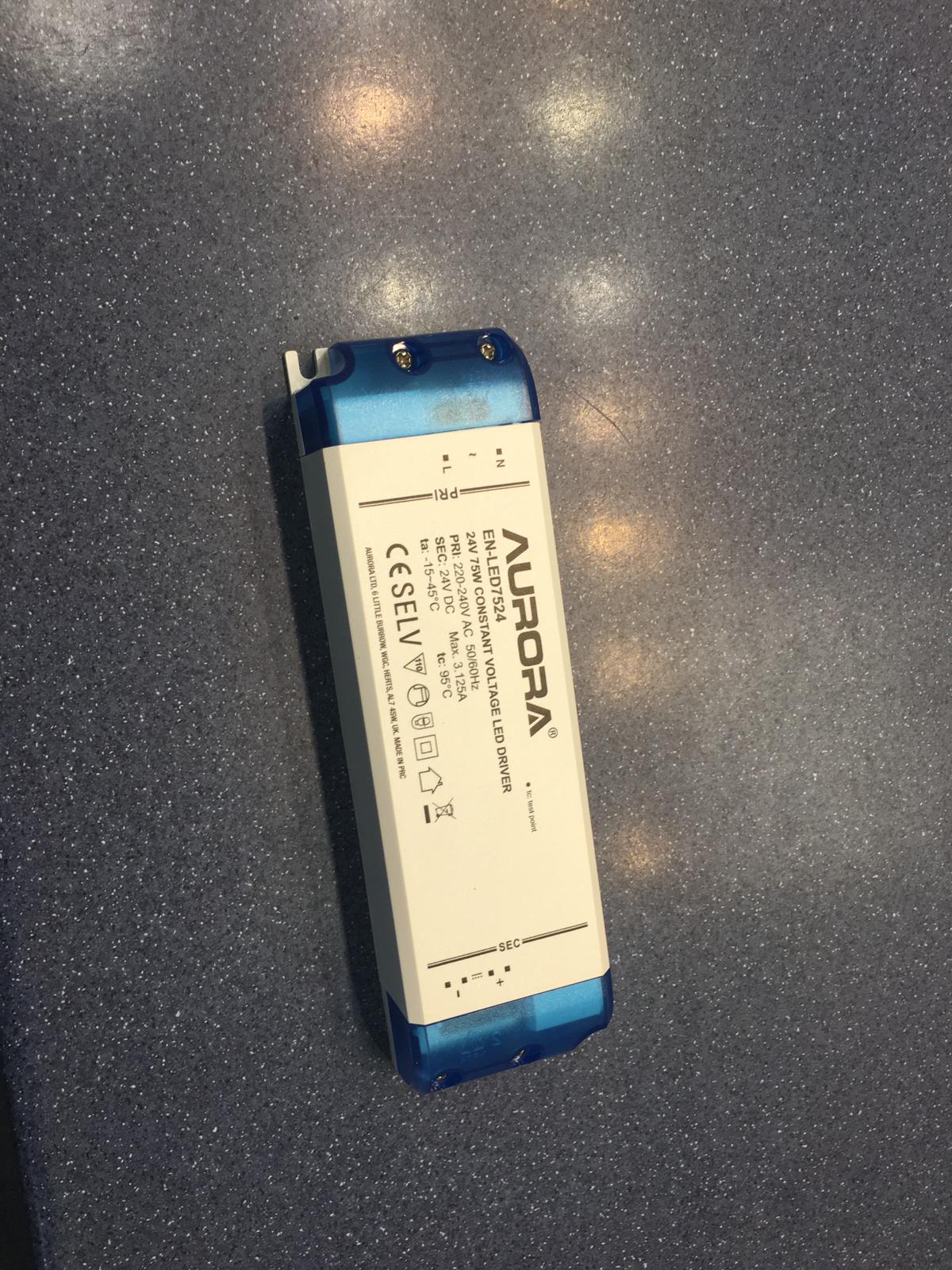

Can I not replace it with this? The led connection mechanism will just wire into the 24v terminals of this driver?
For the USA and Canada
The item you posted will be OK for the lamps as it is 24 volt DC. Take care to get the polarity correct.

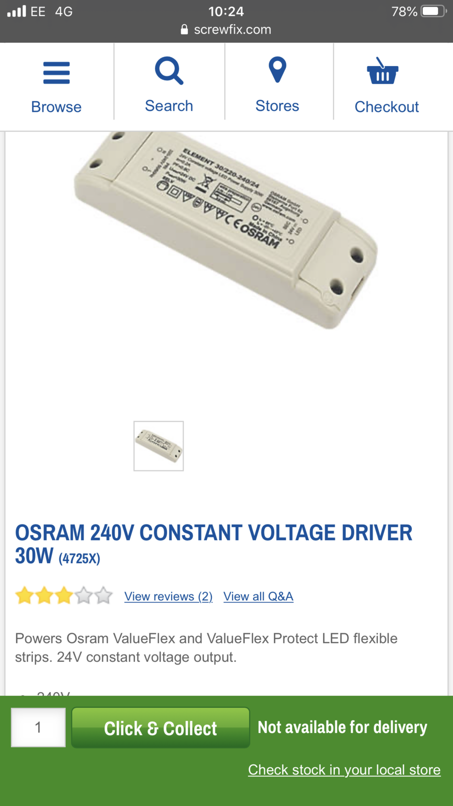

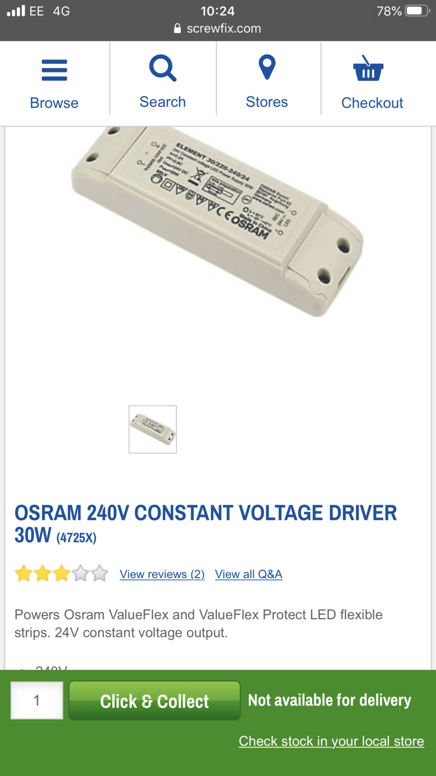

Thanks guys. There’s no mention of minimum current in here:
https://www.screwfix.com/p/osram-240v-constant-voltage-driver-30w/4725x
Just a couple of questions I wanted to clear up please:
1. Will this 24v adapter take care of the 3 strip lights that are connected together? Does this still equate to 24v?
2. The other light (currently working) also has the same driver (power supply?) I.e. 120v input but is still working. Is this expected and should I replace this too?

1. The power supply/driver is for 30W. So that's how much power it will supply. If the 3 strips add up to more then you would have a problem (though you could choose a higher wattage part).
2. It may or may not have a reduced lifetime - it depends on the design. I would expect it to have a shorter lifetime or they would have specified a wider mains voltage range like 100 - 250V ac.
The total wattage of the 3 lights does not exceed 30W. I was asking about the 24 volt requirement and checking that the three lights in total don’t exceed this?
The 24 volts would be applied to each of the strips in parallel, so each strip would be driven by 24V. So everything would be fine. It's similar to the sockets in your house all being in parallel so you see the same voltage at each socket.
