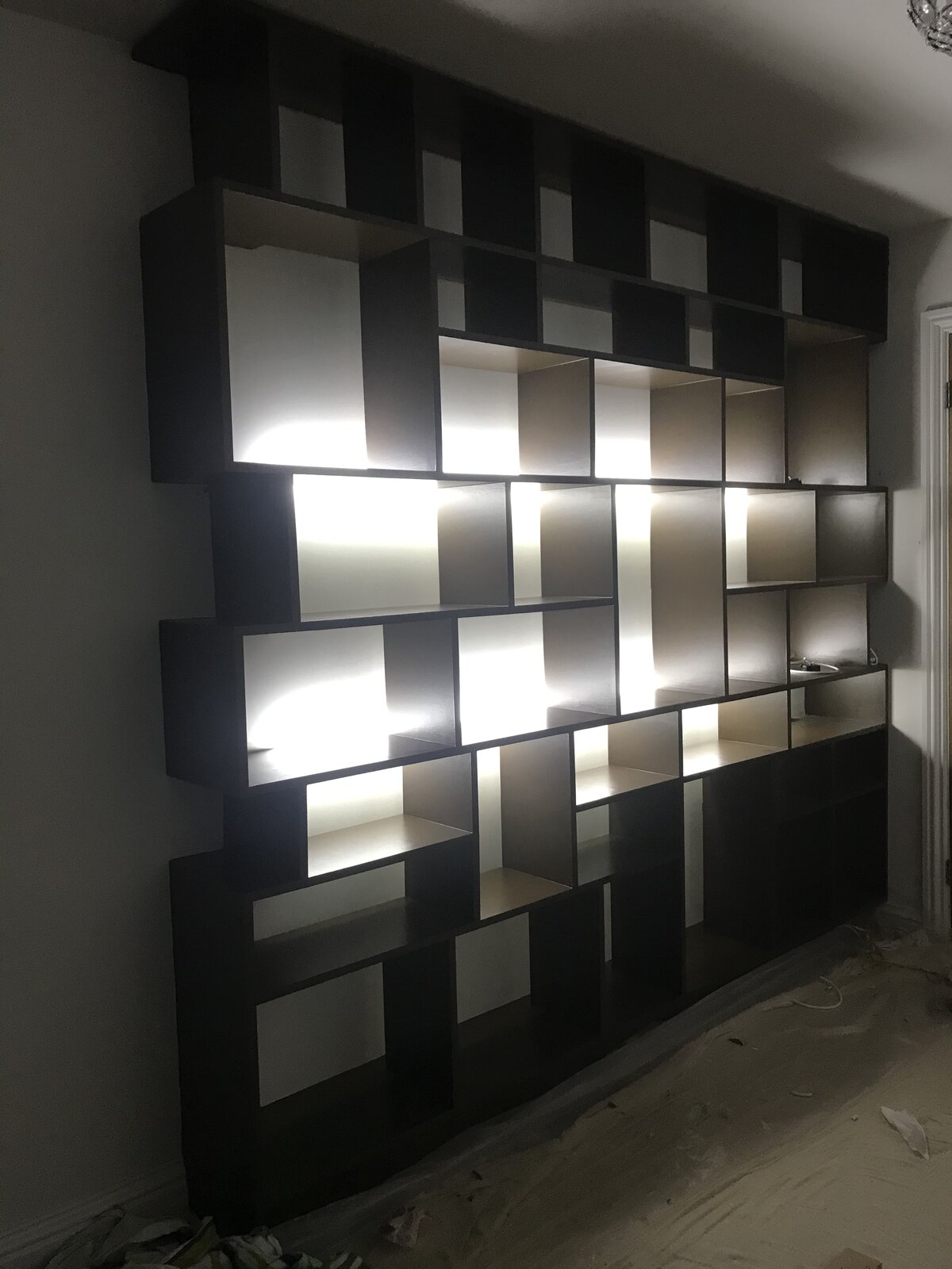

Striplight on bookcase

UPDATE: all rigged up with a nicely concealed switch. I didn’t have a 3amp fuse and used a 5amp instead. Is this adequate or should it be replaced with 3amp?
Also, the wires from the LED strip are very brittle. Can they be “thickened” somehow to provide a better connection under the junction terminals?

Omg Iam so sorry, you must be well made up. I've built matching mdf displays units either side of the fire place alcoves.We'd seen the design in house & country type magazines think they were about a £1000 each. Cost us about 200 in materials and eggshell paint, felt so proud when finished, like you, couldn't stop admiring them. I was in her good books for at least a week :LOL:
5 amp fuse will likely be fine, theres not a lot of cables sold that would not be protected by that size fuse, only 0.5mm should be 3 amp really,
1.0mm or 1.5mm are both fine with a 5amp fuse
If your good at soldering You can tin The Led leads To fatten them up, however what i would do is just strip them longer and wrap the copper round the other flex copper so the Two become One, then screw on to that.
