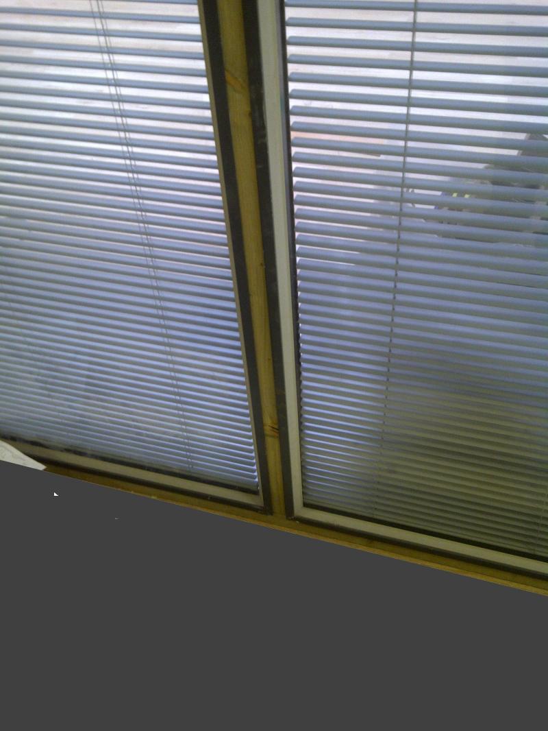

We've installed some second-hand office partitions that are metal rimmed and set into a timber (3x2") frame.
We're looking for an appropiate trim to cover the exposed timber and the metal frame which is a bit worse for wear. See pic at end of post.
We could use wooden beading or architrave and shave it to size but I'm worried it's too thick and won't look the part.
Ideally we'd like some lightweight metal trimming that would neatly cover the area - which is 64mm in most places and 56mm in some places.
Any suggestions.

Get some aluminium or thin steel strips cut to size.

So I got some offline advice to use thin MDF. Apparently these can be as thin as 3mm and hopefully even less and then we can glue these on with a strong glue (e.g. "no nails")?
We plan to cut the MDF in 64mm and 56mm strips and paint it, then glue on.
Would this work?
Also how thin can I get MDF for this purpose (we want it to look fairly flush)
MDF can/could indeed be used and (apart from the UPVC Trims), is probably the cheapest option if you wish to finish it by painting. However, UPVC Trim is available in grey. Try these links: CLICK HERE.
If you decide to go the MDF route, it's simple to cut to size and work to the finish you want and can be painted. It can be fixed with either a 'No Nails' type adhesive or pinned with wire nails, tap with a punch and the hole filled over with caulk or other filler, sand and paint.
