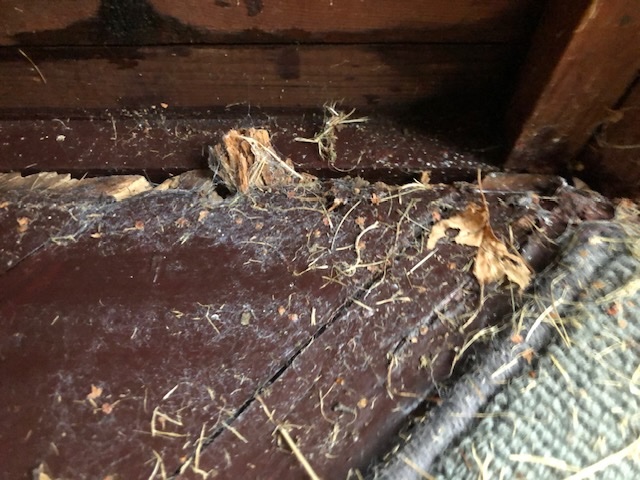

Warm greetings.
My summer house has rotted/separated where the wooden side meets the wooden floor.
The floor is supported under neath so the wooden side has slid down a bit.
The result of this is that the wooden double doors have parted by approx' 1.1/2" at the bottom and about 3/4"
at the top.
This has confused me as I would think the gap at the top would be bigger??
I was thinking of using a toe jack to lift the sunken side, but this would close the gap at the top
and enlarge the gap at the bottom?? I think??:unsure:
The rest of the summer house structure seems to be fine.
Any suggestions would be appreciated.

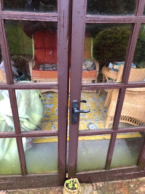

There is a double door at the front which does not meet anymore, and leaves a gap as mentioned above.

If the side dropped it will open up more at the bottoms as that’s where it’s spreading .The top therefore less affected .
Because of the drop, the 2 doors won't open properly and scrape on the flags.

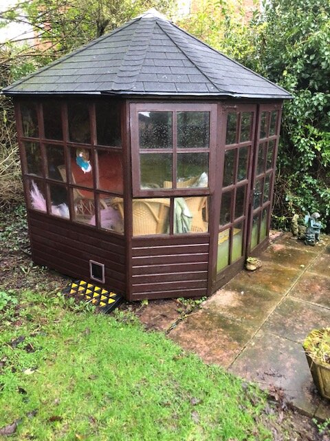

The summer house is 8 sided.
It is dropping on both sides front end.

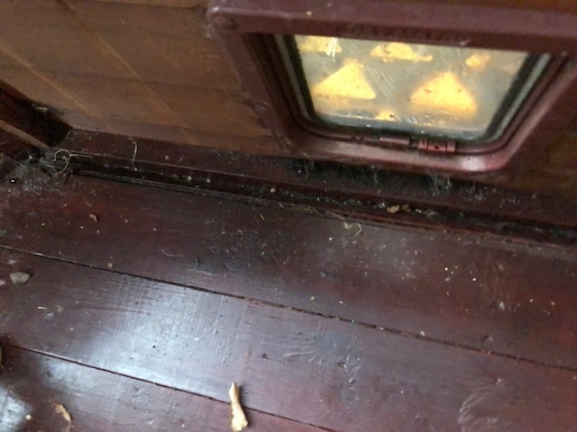

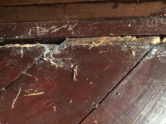

On the cat flap side it has dropped, cracking/breaking the floor board. 3028/3029/3033

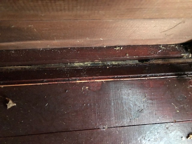

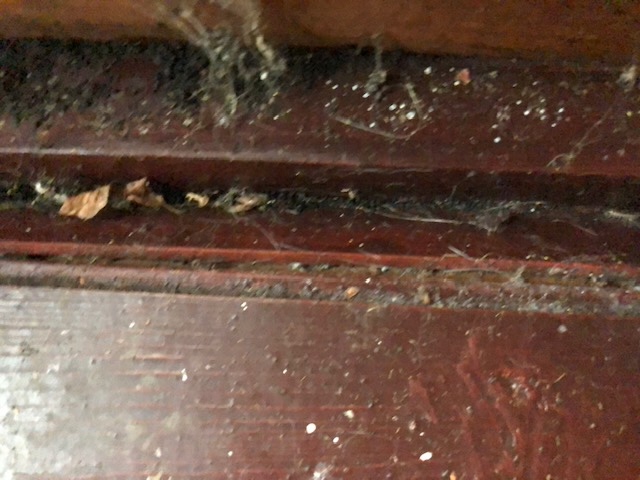

On the opposite side fig 3019 & 3025, it has rotted and dropped.

I would guess where the frame to floor is rotten it has both dropped causing the walls to spread which would create a larger gap at the bottom of the doors than the top and hence why when opening they are hitting the flag stones.
To repair you will need to support the apex of the roof, this will take the load off of the walls allowing you to remove and replace rotten timber and screw the walls back to the base at the correct height.
