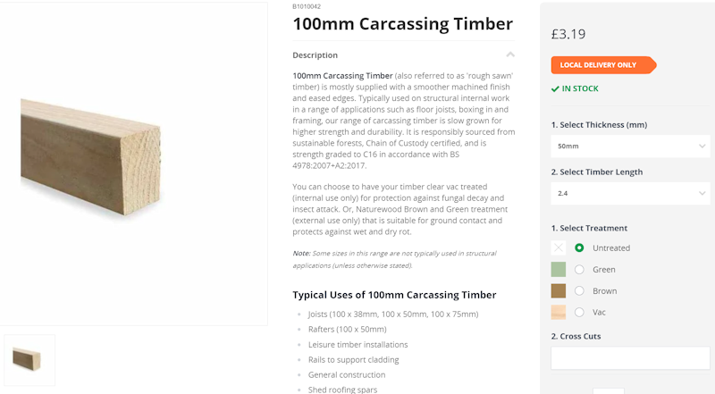

A 2.4m length of 4 x 2 in C16 is only £3.19 + VAT at my merchant so not much in it using scaff boards!
Pray tell Squire whom is your supplier, my supplier has quoted £4.34 + VAT for 2.4mtrs of C16...........
