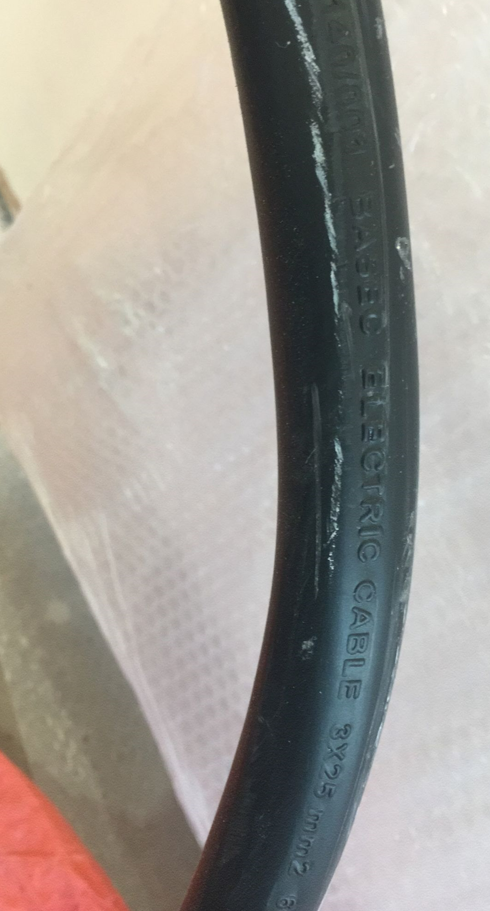

This is where I am getting this size from
That's clear enough - but, as I just wrote, by pure co-incidence I think you'll fins that the outside diameter of the whole cable is probably around, or fractionally under, 25mm.
However, as said, that cable is probably larger than one would usually expect to find in a domestic installation. In many cases, the DNO's supply cable to the entire installation will be smaller than 25mm².
