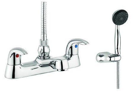

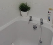

I'm guessing it's a pretty straight forward DIY job to swap off our two single taps and replace with the bath shower mixer?
Thank you.
If you can find a double jointed dwarf its very straight forward, for the rest of us its a right faff.
Should be relatively easy. Just make sure pressures are equal (fed from same source), if not you’ll need check valves. Also make sure pressure suitable for tap.
