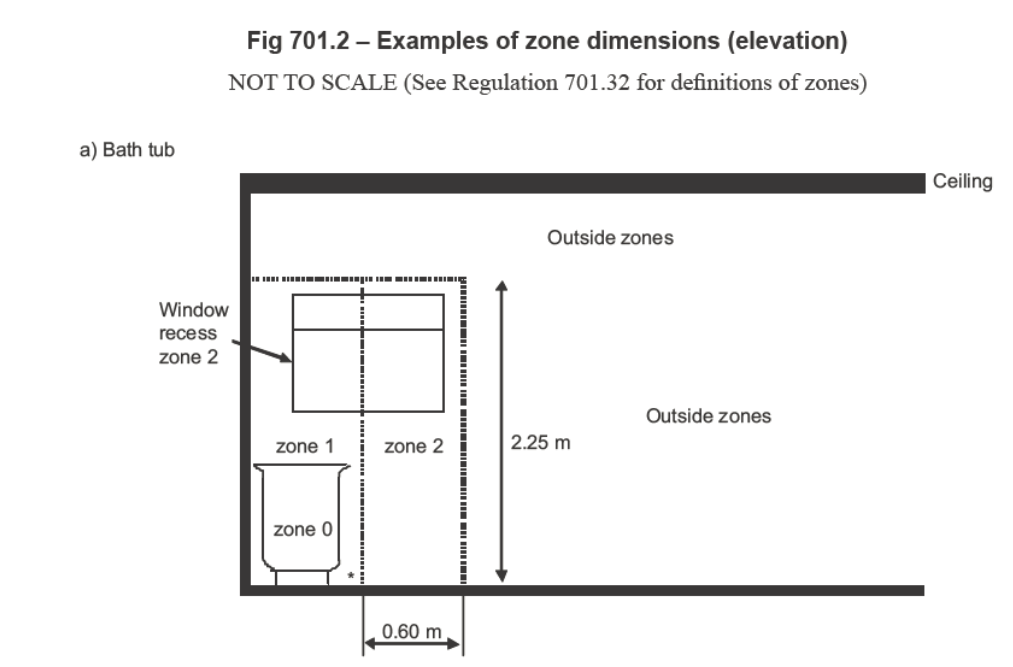

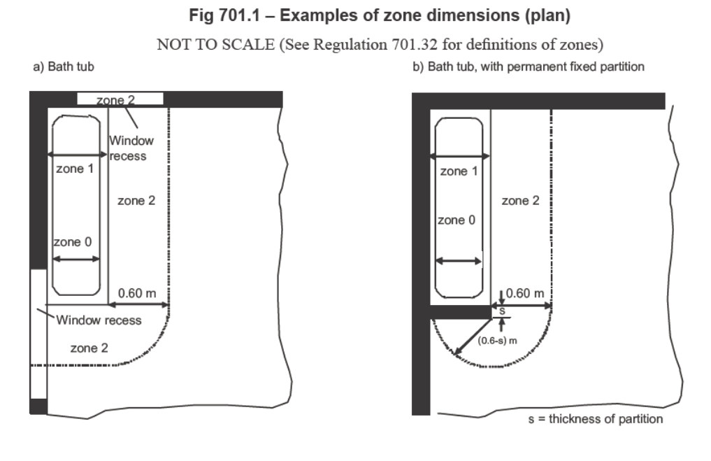

And here are diagrams showing the boundaries of the Zones:
That FCU is in Zone 2, and that hasn't been allowed for as long as anybody here can remember.
