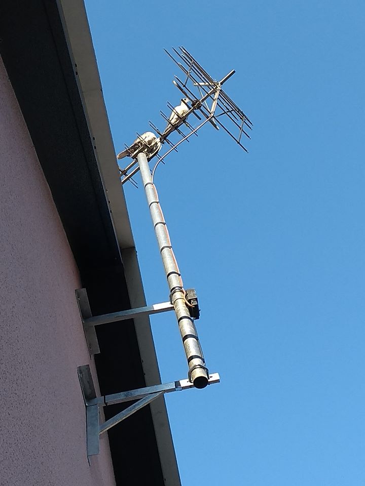

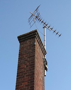

Chimney is coming down today. The idea is to either move that aerial to the back of the house, or get a new one.
This area has a booster on it, which is plugged in in the room. I did not need a booster in my previous house, or if I did, it was not attached to the aerial ...
anyway, would I be better off getting a new one? I know nothing about them so no idea if that is a good one or not.
Maybe I could just have something like this in the loft: https://www.screwfix.com/p/labgear-tv-aerial-high-gain-digital/60215
Do they work much better on the outside of a house?

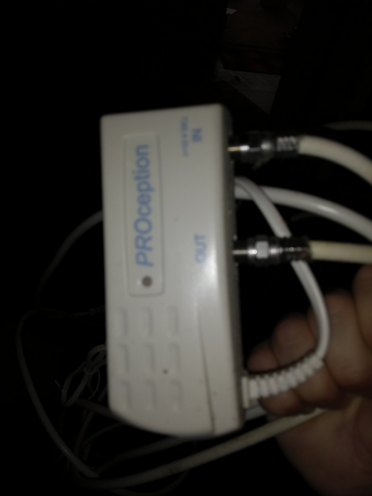

I think i get it now... .. the splittrr/booster is on the aeriel and powered via the coax?
Will be keeping existing. Big question is, how was the booster powered,?
Yes, the white ProCeption box in the fuzzy picture is the power supply for whatever masthead/masthead splitter amp is fitted to your aerial. Yes, the power goes up the coax cable in the opposite direction to the signal.
As a side note, the box on the aerial might not be a "booster" as such. It could simply be compensating for some of the signal loss that is inevitable when splitting the signal X ways. For example, ProCeption makes a 4-way splitter with 4.5dB gain per output, but the losses from splitting 4 ways would be to reduce each signal leg by roughly 7dB, so there's a nett loss in signal strength. You'll know for certain what you've got there when the aerial comes down. Flick the lid open and you should see a model and some descriptive text about the spec of the device.
Aeriel is down, on the lawn ... looks like a splitter to me, has a few sockets, two where in use. Guess I should put it somewhere dry ... this is all good news though, as it solves my dilemma of how to power the splitter - in my previous house I had a power socket in the loft that powered the splitter.
the proception unit is the power for the splitter, so the coax comes from the aerial to the IN on the unit and then the OUT goes to the TV. if using this make sure u dont turn it off or you obviously lose the power for the signal.

I was a common thing to call the aerial digital, what it did mean was wide band, so you got aerials with coloured bungs and the colour told you what frequency range it covered, and if you use a narrow band aerial it is lighter and has less air resistance so less likely to be damaged in high winds, so personally I would not buy a wide band aerial if not required.
Buying an aerial which does not state the frequency range I would be unhappy with, mainly as there are two wide band aerials, the old black code covered channel 21 to 68 but now we have lost the top channels so new white covers 21 to 60, as the frequency goes up the elements get shorter
and the colours change, however the broadcast frequencies have changed many times since analogue days, with masts once again keeping the frequencies within a group. It all depends on your local transmitters, even then Winter Hill for example has some aerials pointed in set direction so even if you know your transmitter is Winter Hill it also matters which side of Pennines you live.

Thanks for all the advice. Old aerial moved to new roof and gives an excellent picture, using the Proception box, now in the loft, rather than attached to the aerial.
Amazed how weatherproof that box is though, surprised it survived on that aerial all that time - it looked a bit knackered when the aerial came down!
