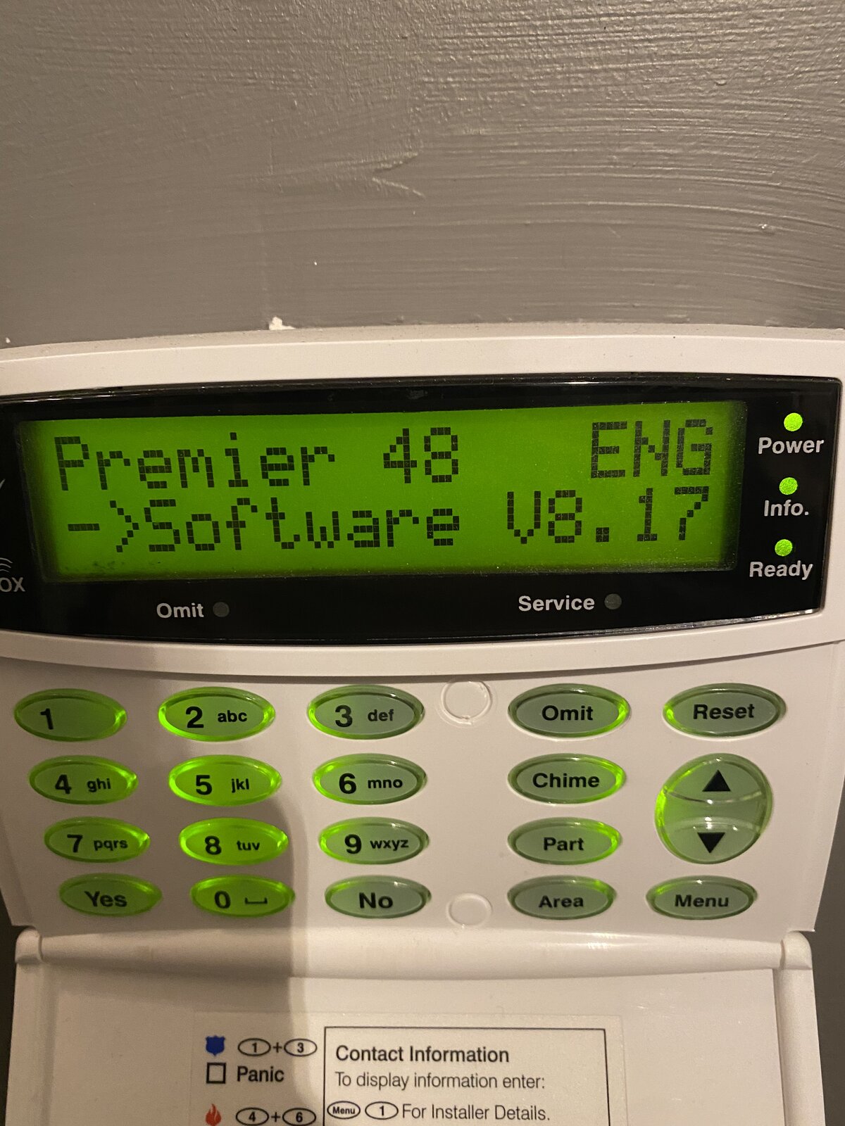

I have a 1 year old alarm system, large control box in the loft wired keypad. I can get specific model numbers if needed but does anyone know if I can retrofit a wifi module to it?
Post pictures , if it has an LCD ( English display ) press menu 4 on the keypad this will tell us what you have
Better late than never! Here’s a pic of the user panel.
This is an old premier 48, so realisticallly I would say not to bother.
Replace the panel and then look at smart com.
Unfortunately……you have been had …..unless they did it for nothing ….even that keypad is old …you can tell by the two round circles on the front the newer …..when I say newer I guess at least 10 years don’t have this as they slide on , not clip on …
I’m pretty gutted. Who stores a new 10 year old alarm in the shed. All wireless sensors, if I changed the panel could I use these?
There is a chance you have radio plus wireless devices.
In which case no.
In reality would need to see the expander or the aerials inside the wireless devicesbest case is the expander is being used in legacy mode, worst case it's radio plus.
