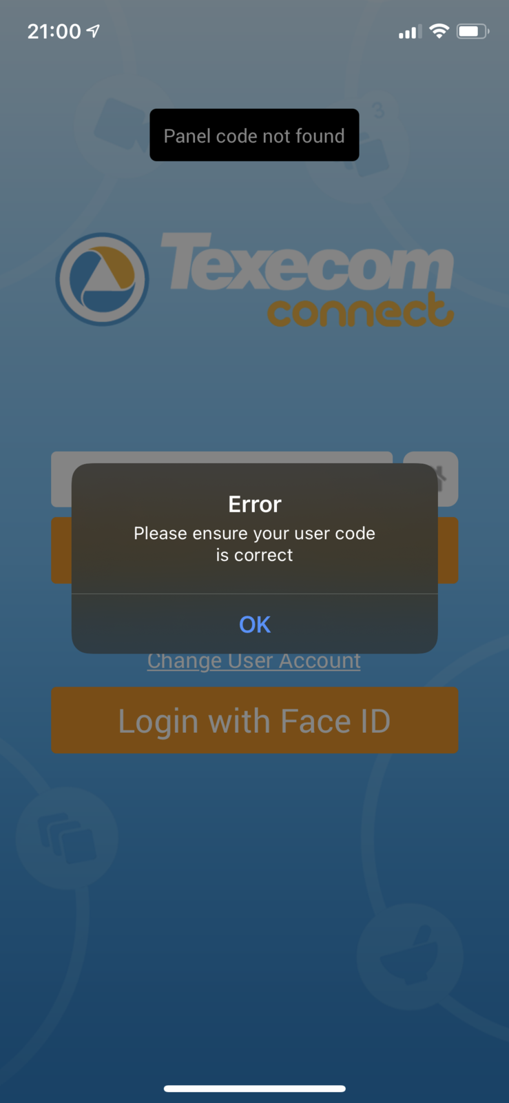

Hi,
I hae been using the Texecom app for around 1yr, recently upgraded to the new version 2, all was working ok.
Last night i added a few extra sensors to the alarm, did not change anything else.
When i now try and log in via the App, i get a "panel code not found" message with a "please ensure your user code is correct"
I am using the correct code and have tried other accounts, no joy. Also the same thing happens on my wife's iPhone too.
See screenshot, anyone else having issues?

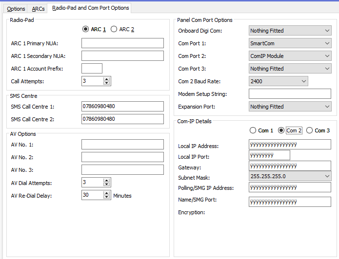

I still get notifications on my iPhone for things like when i log in via the front panel as an engineer, same when i connect via Wintex so some of the app is working ok.
I have looked at the setup of the panel via Wintex and all looks ok, i cant see anything that has changed. see attached.

Finally looked at this - got it all working again by generating a new app code on the panel and entering it on the iOS app.
On the ios app i added a new site using the code from the alarm panel i generated, it did not add a new site like i thought it would, rather it said something like 'success' and then just showed my exisiting site in the app. It all then worked ok from then on, i did a sync panel on the app just in case afterwards. Been working fine since.
