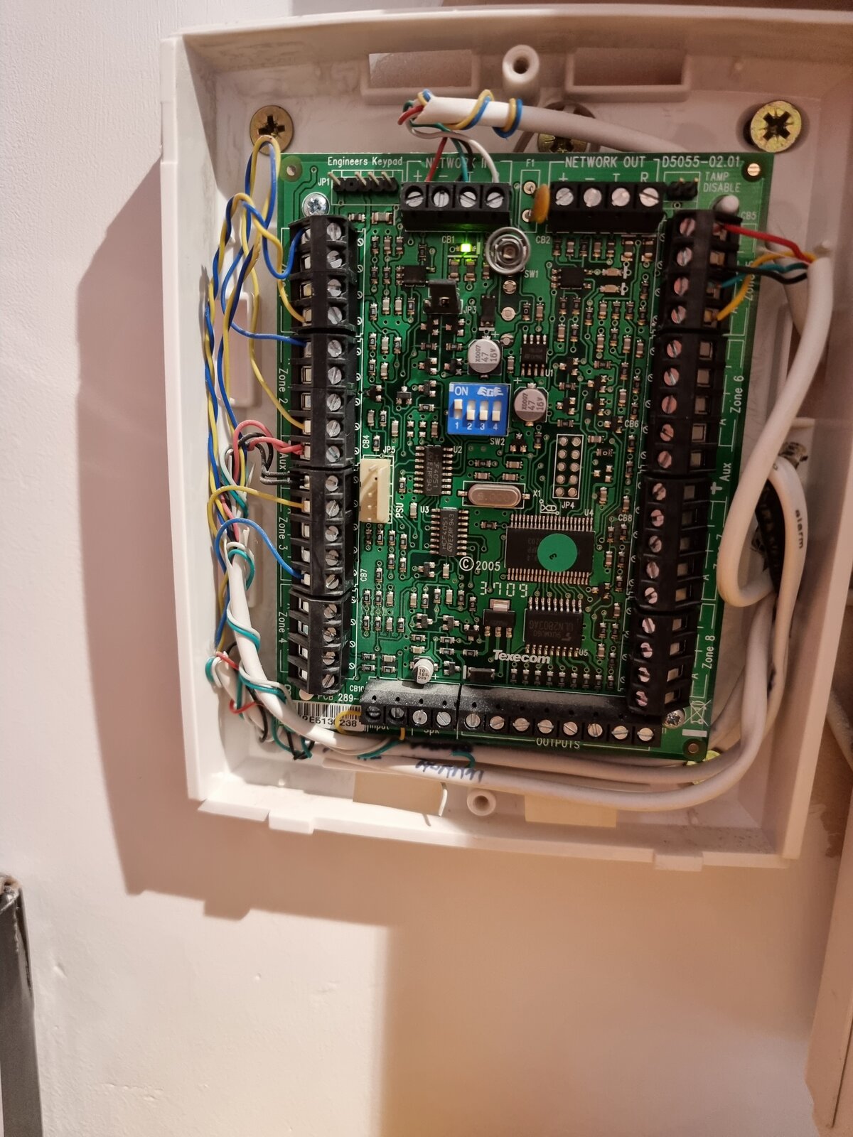

I've currently got what I presume is Premier 8XP (given the panel is a Premier 48) with 5 hardwired zones (Photo attached for info). Will this expander be compatible with a Premier Elite panel or is this another item I'm going to have to change?
