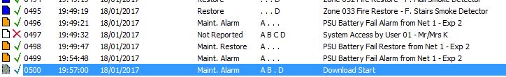

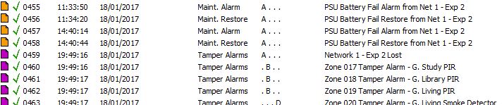

So just now my alarm went off out of the blue whilst I was in the house, put in code and there were a bunch of items.
I downloaded the log and it looked like earlier today in the afternoon there were some battery issues too:

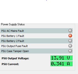

Under diagnostics for Expander 2:
So, based on this, it looks like the battery in PSU2 is faulty?

Fuse in PSU 2 was not lit red but the battery fault red light was on.

What I didnt understand is normally if the battery is at fault there will be a message on the keypads and no alarm. In the most recent instance it the alarm went off with the tamper on expanders 2, 3, 4
So right now after disconnecting the PSU2 battery it says under Expander 2 diagnostics:
Expander Supply Voltage 13.49
Expander Network Errors 0005
PSU Output Voltate 13.91 V
PSU Current 0.404A

it appears you lost the expander 2, it also appears you have lost other expanders give I see zone 33 on the list.
