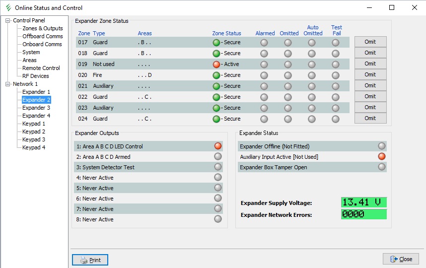

I've got a few questions regarding Wintex and other issues I've got with the alarm. It's a Premier 48 system.

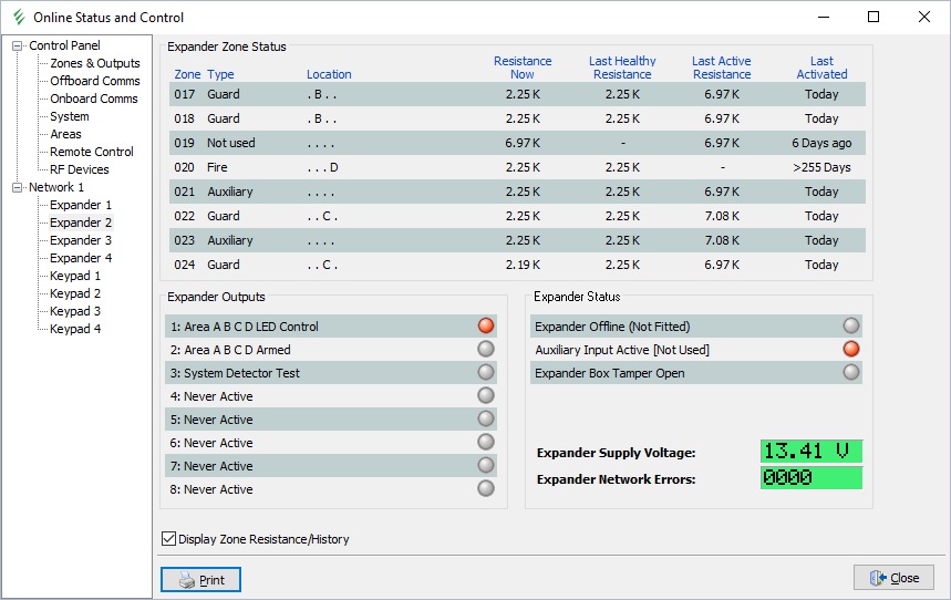

1. One of the PIRs doesn't seem to work correctly. When it is assigned an Area and set up as Guard, the keypad says "Zone preventing exit start are:" "Zone 019 Active". So for the time being I have removed this zone from the Areas list in Wintex. I've attached two screenshots from the diagnostics menu which may be of help. Does this mean the resistors have not been wired correctly? The red LED lights up correctly when it detects motion.

The resistance on one 19 is active of 6.9K so you need to look at that device, what device is it and is it selectable resistors or hard wired resistors?

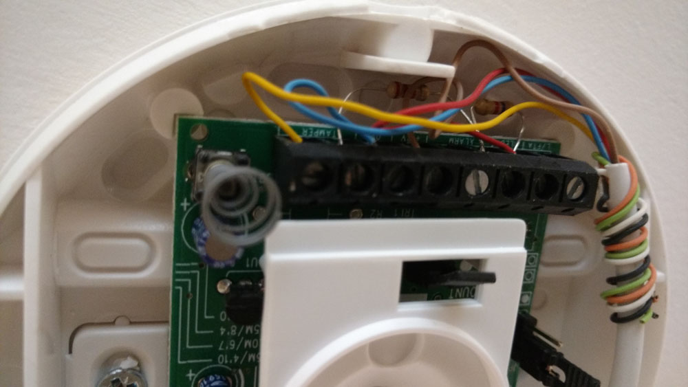

It's a 360QD PIR that has 2 resistors wired in to the terminals by the installer.
Should all the 360QD PIRs have the resistors between the same terminals? If so I can check vs another one that works if the resistors are wired the same
cant see it very well but I would check that the alarm terminals has the 4k7 resistor in it.
so we have terminals H G F E D C B A Tamper being the yellow wire in H
in G we should have a 2k2 resistor going to terminal D and form terminal C should be the wire going back to the zone in the control panel.
E 12V and F 0V
hope that helps, I cant see the wiring and terminals very well, but it looks like the wrong terminals are in use for this detector.
