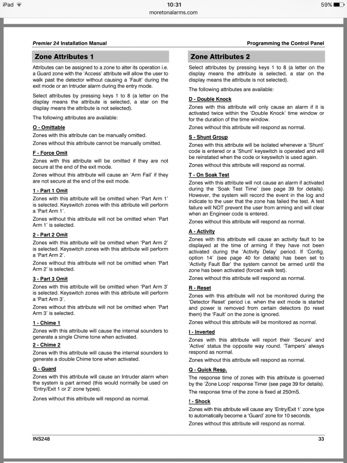

I have in my house a texecom premier elite 24 system installed with 8 old style PIR units that texecom have said are ok with the system (old system was texecom veritas). There are no door magnetic switches fitted. We have two doors used for entry and exit, no animals left in house and only need to isolate the main bedroom at night.
How do I set up the zones please using the control panel
There seem lots of options on keypad for zones and when trying to set up I see in the attributes section letters A O E etc and these seem to random in the line ie could be lots of xxxxA or Axxxx or AxxOEx that sort of thing what does the refer to please (areas?)
Looked in the manual and the seems to be lots of options I will not need, do I ignore these?

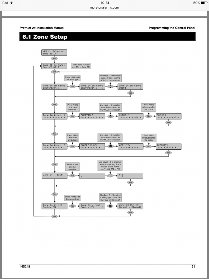

Program zone types ...e.g. Entry exit and guard access ( any zone you cross after the entry zone ) guard for the rest , landing needs to be part 1 omit ...if your struggling with this I think you have chosen the wrong panel to install

thanks for the reply, but still would like to know what xxxxA or Axxxx or AxxOEx means as reading the manual no reference to what this is and why it seems random ie not starting with each letter from the left hand side, so any idea what the A is the O is the E is as it must have a meaning.
I bothered so why the xxxA if selected and not Axxx thats what I am asking?
Each zone has.... area ....A .......Attribute 1 ....8 options .... Attribute 2 ....8 options EACH SET HAS DIFFERENT LETTERS AS PER ABOVE ....
