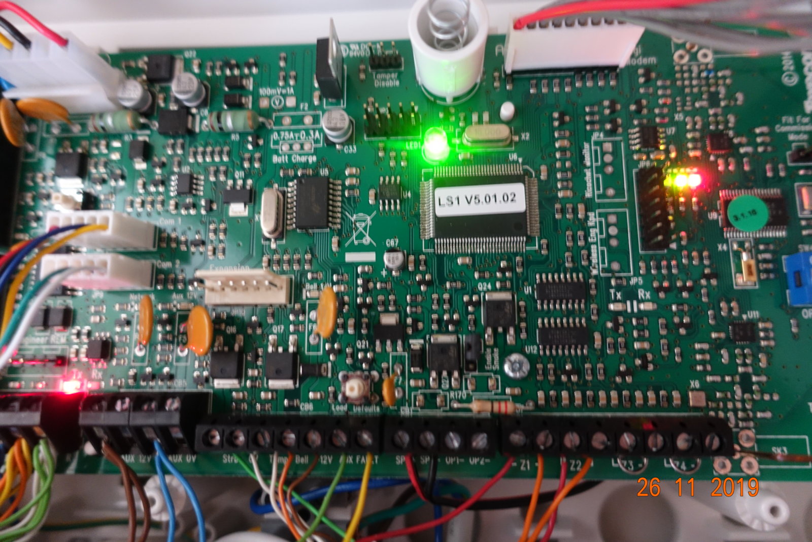

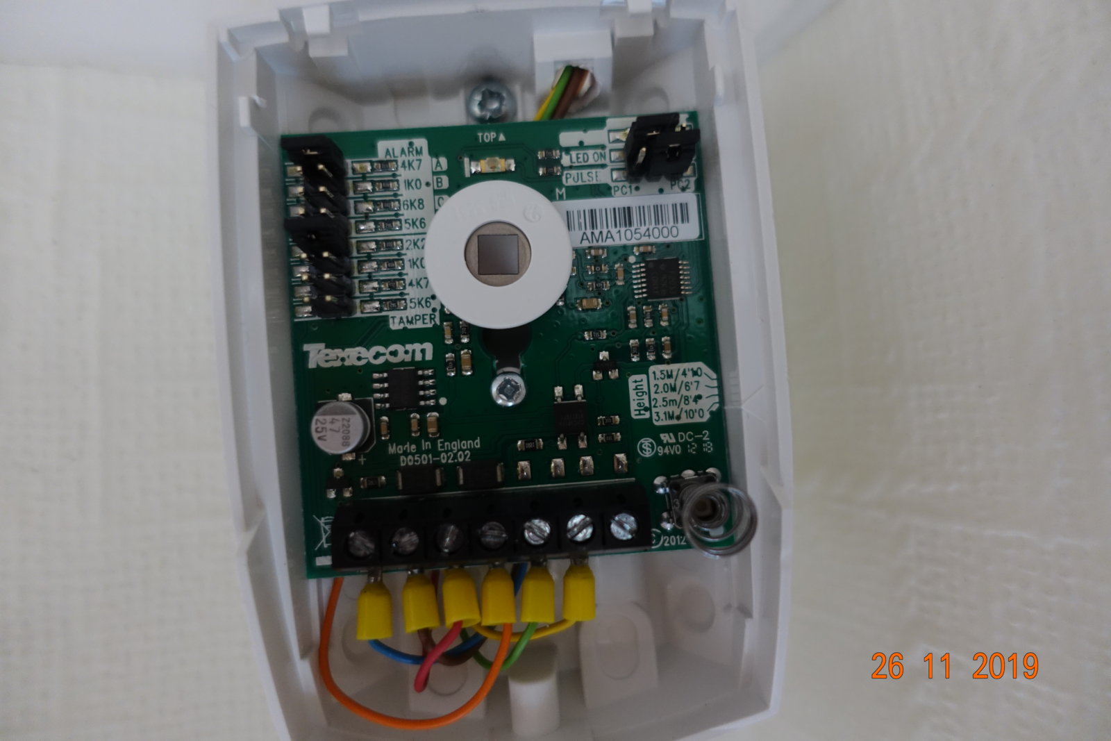

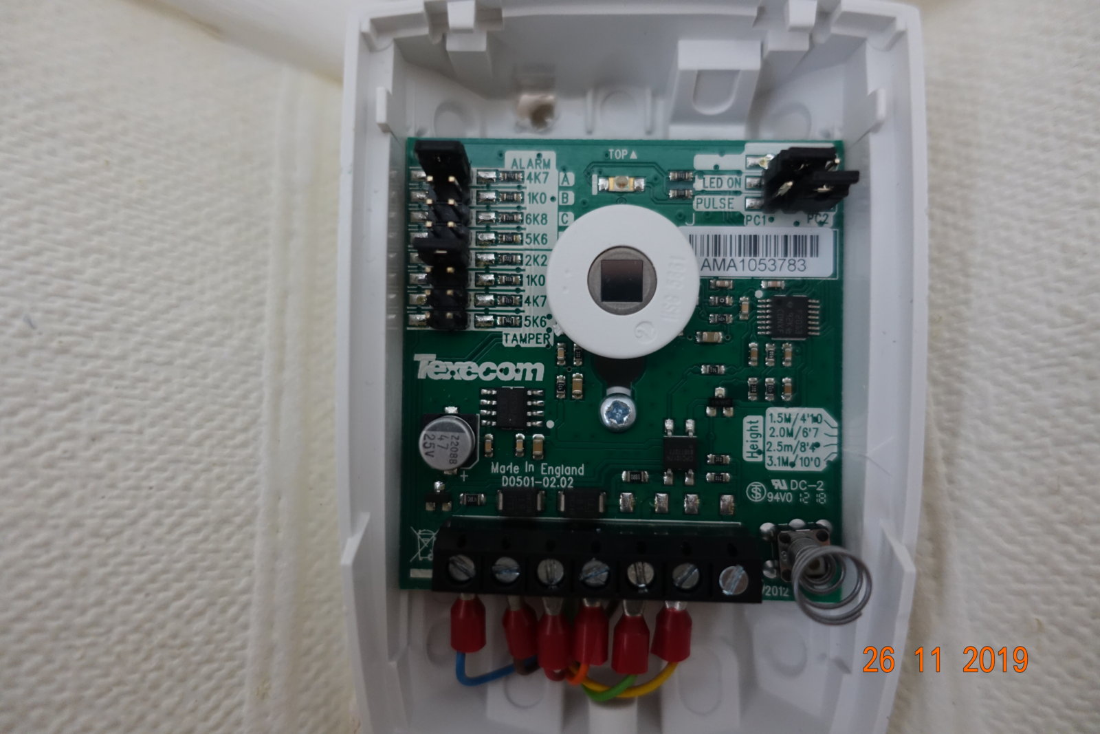

pictures of the wiring at the PIR end, and of the jumpers selected.

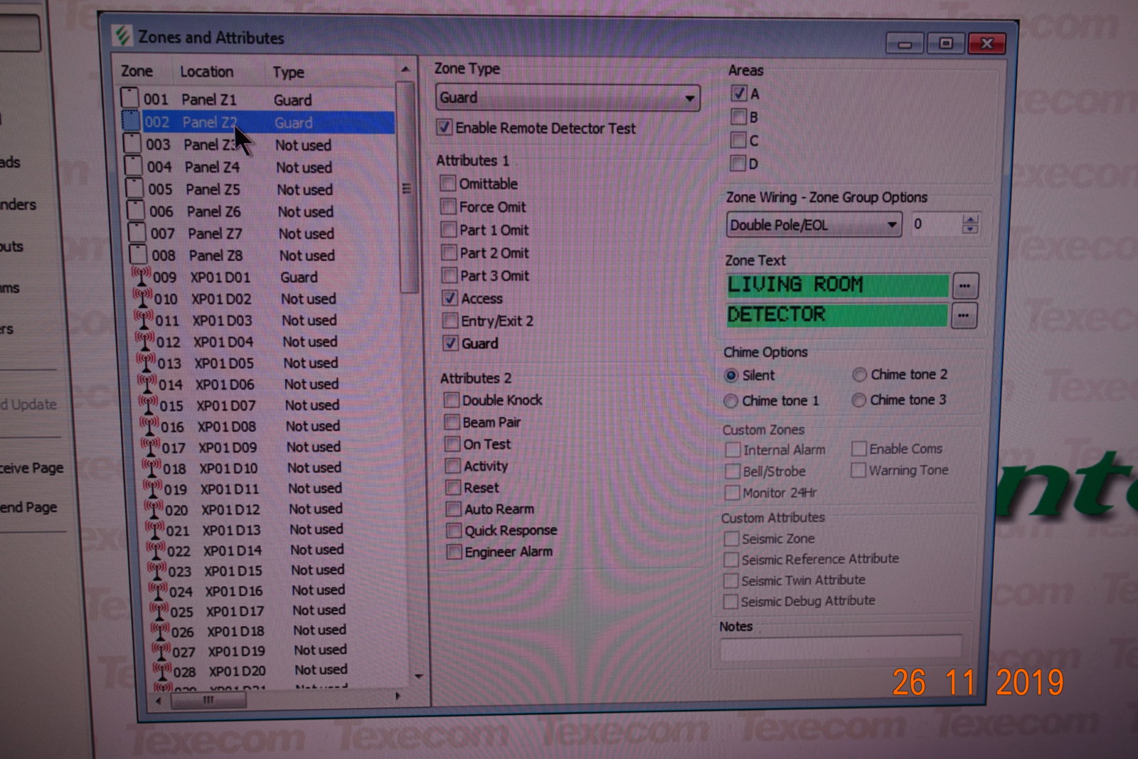

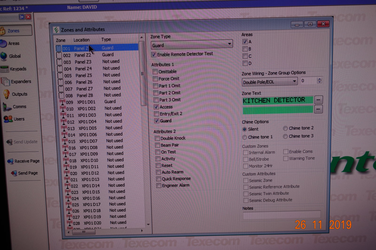

picture of the wiring type for one of the zones and a picture of the zones in the panel.
You could also go into engineering, engineer utils, view zone status, go to one the zones and take apicture of what it displays.

The 001 zone status is ACTIVE, infact all the 8 zones are showing ACTIVE.
Well the answer is your PIR is wired incorrectly.
you should have 2 wires for power and 2 wires for EOL.
You have wired 2 wires for the alarm and two wires for the tamper.
take the middle two wires out, and make sure you have red in first alarm, and orange in last tamper.
zones 3 to 8 are not being used so you can set them to not used.
looking at the picture if you take out green and yellow, and put the orange where the yellow one was, you should be okay,
Many thanks, do I have to change the wiring at the panel also?
if your PIR's illuminate hen you walk in front of them, then the power cables don't need redoing.
if you use the wires suggested then then zones don't need redoing.
The green and yellow can be removed from the panel and replaced with a link between the two terminals as the zones will not be using the global tamper circuit.
