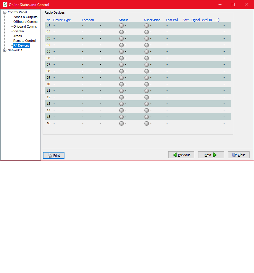

Hi,
I dont see any of my zones when i access the RF devices page.. any ideas why?
I am running Wintex_7_2_2_1 (latest), selecting Diagnostics button then navigating to Control Panel > RF Devices.
If i select Network 1 > Ricochet XP01 Devices i see all of my wireless devices as i should, just not on the RF Devices page.
Any help would be appreciated.

So it wont work for the new GJA and GHA series sensors?
How can i get battery and signal strength information?
I try to connect to my panel using the monitor software but it wont connect, i am on the same subnet as the alarm, enter the alarm IP, leave the port as default (10001) but when i hit connect it says 'Unable to connect to Premier Elite XP-W!'

Ricochet monitor connects via Wintex (elite V2 with V2 wireless expander) if connected to the panel, to connect to a wireless expander directly you must connect the usb com lead or com ip lead directly on the the wireless expander.
