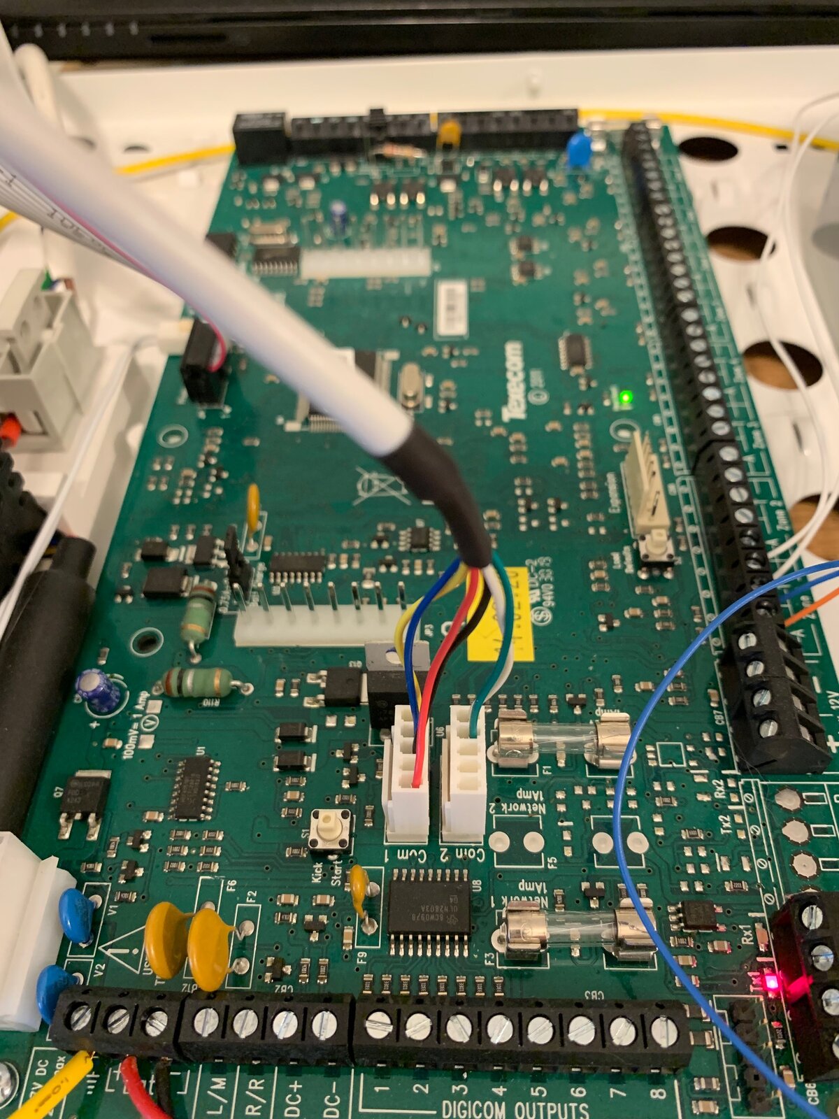

Hi,

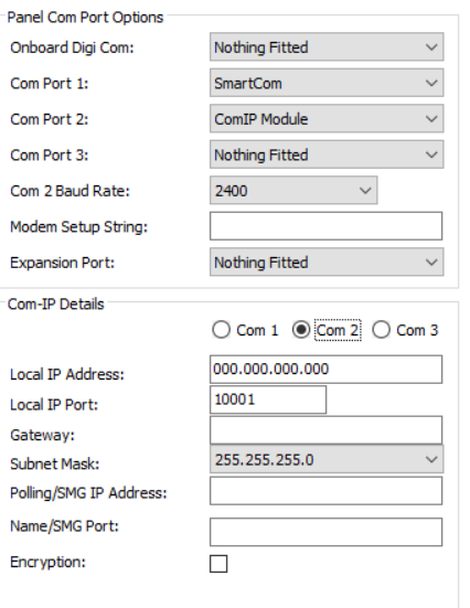

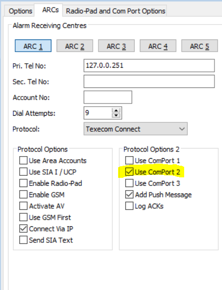

I don't know if anyone can help. I'm trying to resolve an issue with a Smartcom on a Premier Elite 88 panel running the latest firmware. The Smartcom is running firmware 3.0.21 but will not connect to the cloud services. The status light just flashes. I've tried it both via Wifi and network cable. After so long the alarm keypad reports an ATS path fault I assume because the Smartcom cannot connect to the cloud service it then generates a fault. Its configured in Wintex as per the attached photos.
A UDL password has been set.
Is it correct that once the Smartcom has been configured in Wintex and the config uploaded you can no longer connect via Wintex and USB as this seems to happen which seems strange?
Sam

Are you sure you have the device configured correctly?
'Pri. Tel. No:' is listed as '127.0.0.251'
This IP, is a loopback address - the unit could be attempting to contact itself, and of course, it won't get a reply!
Should this be the IP address of the cloud service provider?
Thanks. I can see you're thinking it does appear to be a loopback address they are saying use. My only thought is the unit has the actual server IP embedded into the firmware and the loopback address forces it to search for it. I had found reference to the actual server IP addresses 52.34.136.45/50501 and 52.212.160.114/50502 but these may have discontinued.

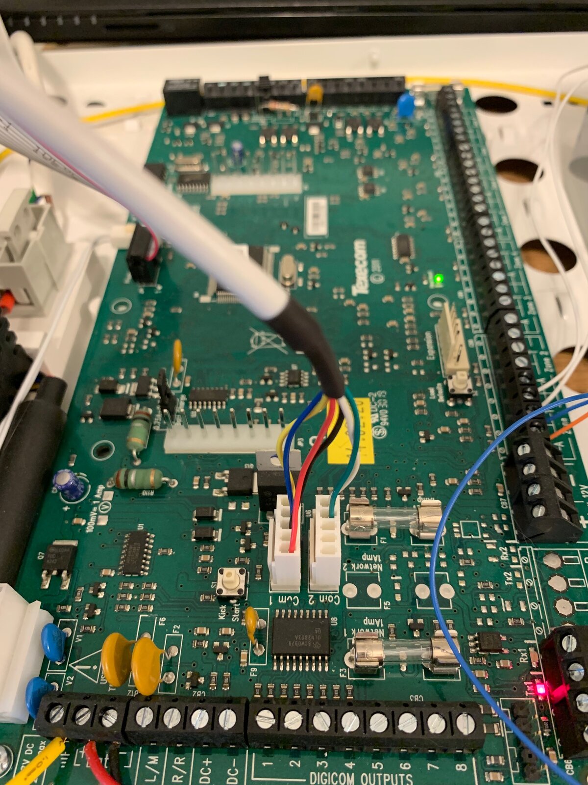

What are the smart com lights doing when its hard wired?
Do you have a picture of the connections being used?

usbcom connection can be used on any port not programmed up, so comport 3 and use the adapter that came with the smartcom in the digi modem socket

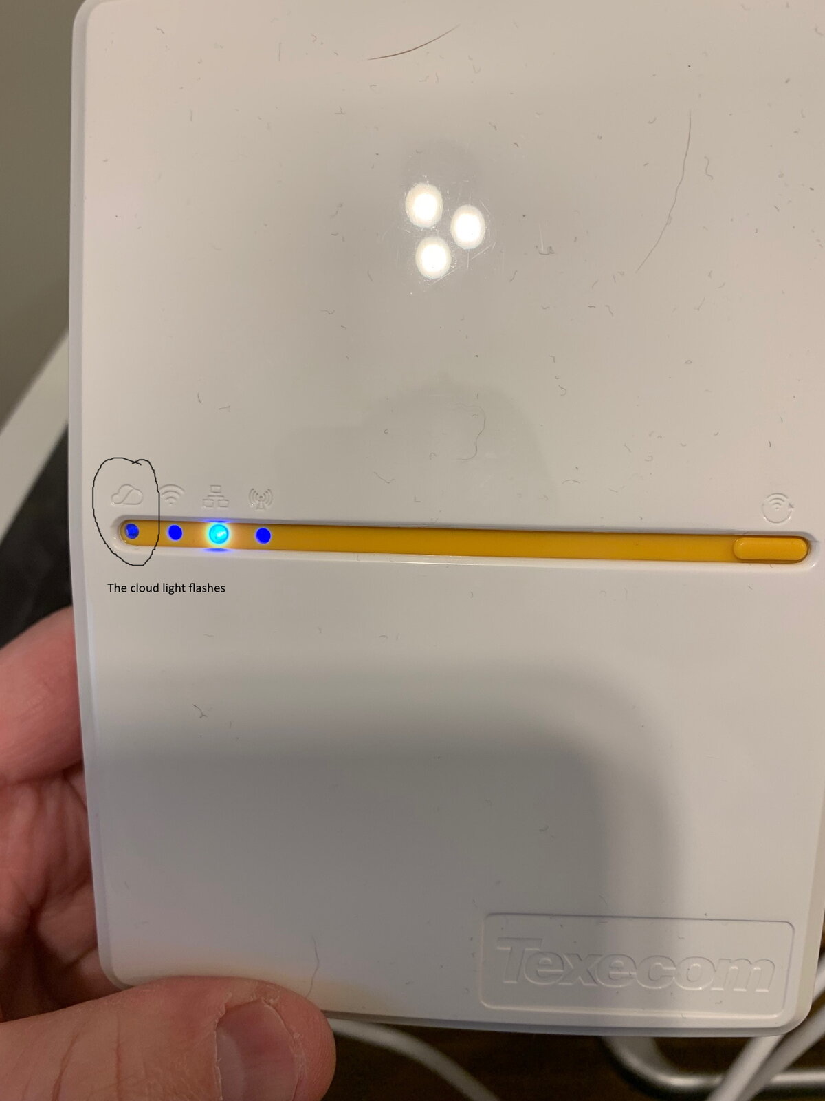

Smartcom Lights = Network light solid green
Cloud light flashing
After the alarm has been powered up for 2-3 minutes it reports an ATS path fault. Com 2 Fault

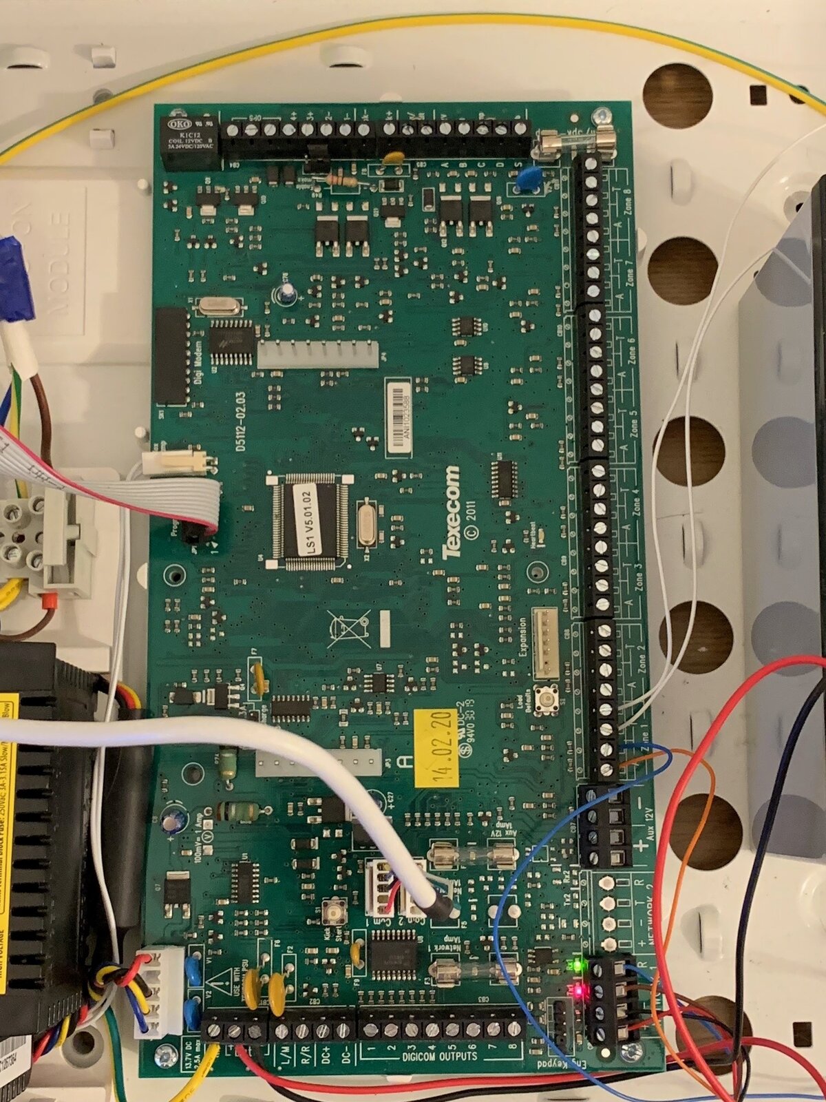

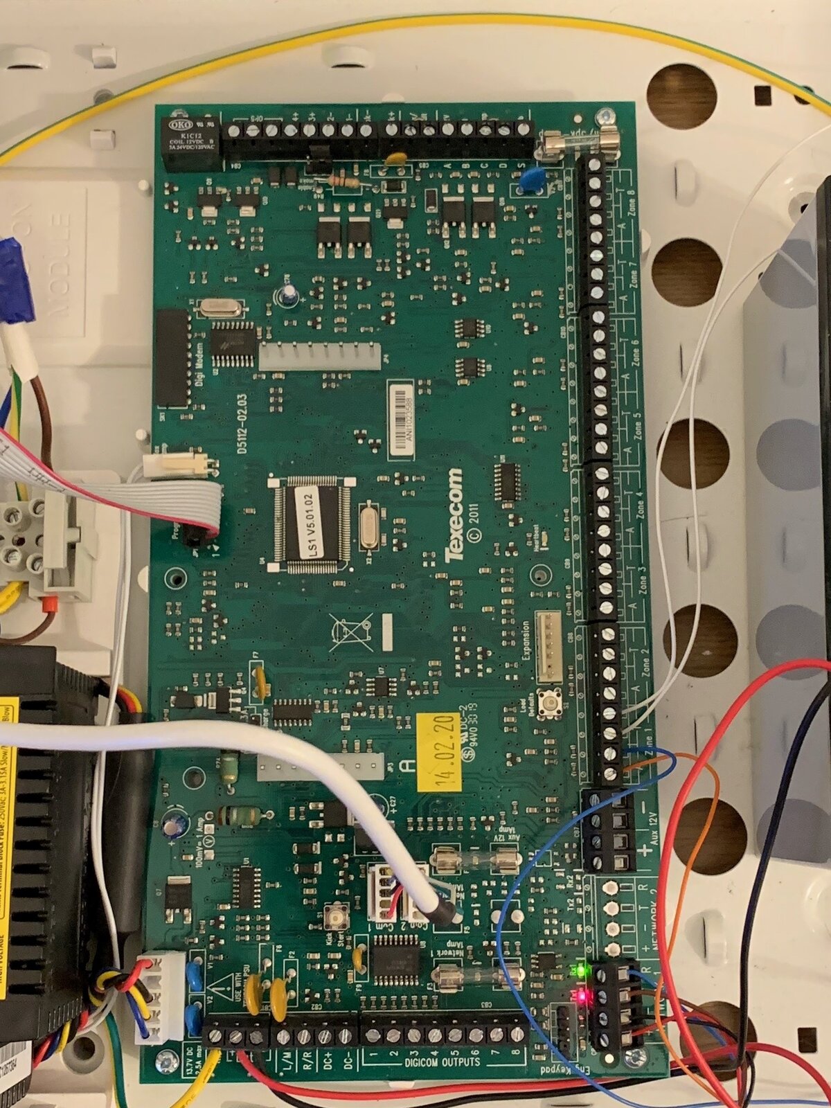

Where is com3?
It's sorted. I replaced the 127.0.0.251 with 52.34.136.45/50501 for Pri No and 52.212.160.114/50502 for Sec No. It then let me generate the app code.
After reading the config back again from Wintex it's reset back to 127.0.0.251 so it must need the above details initially to setup?
it shouldn't but some smart coms had the server addresses missing so had to point it tio the right place and the sort it out messy
