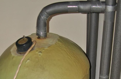

The picture to the left shows a standard indirect Stowaway Heat Bank Thermal Store.

To a certain extent yes, because there will be some losses from the thermal store itself, and the hot pipes going from it, but good pipe insulation without gaps will help. [the picture below is not not a thermal store but to show good pipe insulation]
Also, warm water rises to the top of the thermal store and as it cools it sinks so there will be some internal convection taking place inside which can trigger the heater to come on, but it if no water is being used then it shouldn't be on for very long [unless the 'off peak power' has just started and it has to catch up for previous usage] and not very frequently. Unless there is a leak or dripping tap somewhere.
If the thermal store itself has good insulation, it shouldn't feel warm to the touch.

I know that the pipes do get hot because I accidentally touched one
Then it will be loosing heat, cooling the thermal store and cause the electric heater to come on when you've not used any hot water. Foam pipe insulation is cheap available at DIY stores and easily installed, you can cut it with scissors
