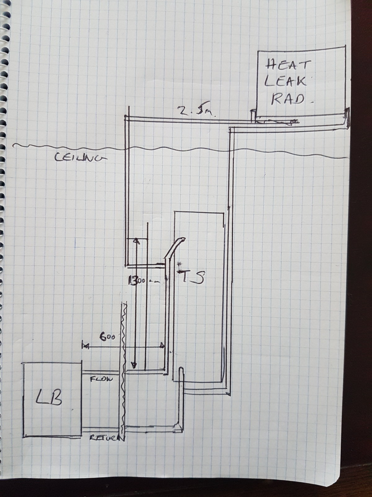

And ahh yes your assumption is correct again. They run flat on loft floor here is crude representation of current plumbing.
Not clear but bascially flow for example runs 600mm horizontal from log burner through wall to airing cupboard which sits on a slightly higher level (steps up) from ground floor. Then 90 degrees rise 1300mm to an elbow into thermal store.

Is there a feed and expansion tank in the loft? Prob only small (30 litres), should be metal, usually the feed pipe drops to the return & expansion (loop over the top) comes from the flow
And have you got a spirit level- you need to make sure those horizontal legs are either horizontal (bad but tolerable) or have a slight rise towards wherever the expansion pipe comes off. If there are any negative gradients especially in the flow then kettling could get dangerous
EDIT Looking at your sketch, there is scope for improvement- if you rerun the flow & return from the woodburner so they run diagonally up then vertical you'll get a large performance boost
