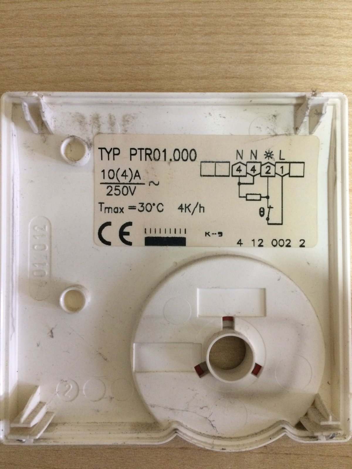

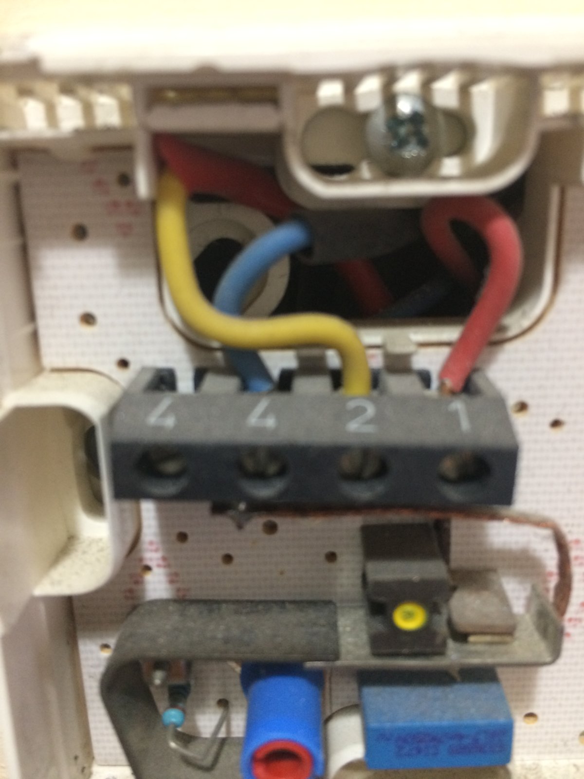

Yes there is a timer mounted just beneath the boiler for hot water (tank) and heating. I've not looked inside the existing thermostat yet.
The existing PRT100 doesn't have potential free contacts, so you won't need this.
The Potteron Suprima uses 230v for its control
Most (but not all) new thermostats have potential free contacts anyway so that they can be wired to suit either 230v and 24v
Do you mean by this the same as 'volt free' I've seen online? Does volt free mean it doesn't have an actual output voltage of its own, it outputs whatever is inputted?
Yes, it refers to two switching contacts that are isolated from anything else, so they can be used to switch any voltage applied to them. They can be referred to as 'potential free' or 'volt free'
Thanks Stem,
Could you please point me in the right direction for a suitable alternative replacment for the PRT100? It doesn't matter what website it is.
As you don't have a permanent live, any of the battery powered room thermostats with potential free contacts would be fine. (the batteries last for several years) These tend to be more accurate than the old mechanical type.
Examples would include a Drayton Digistat or a Honeywell DT90
If you want an easy straight swap, don't get an RF thermostat which has a separate receiver and a remote thermostat, or a programmable thermostat that also controls the on/off timings as you have those functions in a separate timer already.
If you do have a neutral connection to the existing thermostat, then you could fit a traditional dial mechanical thermostat if you wanted to.
If you find a thermostat that you like the look of and you are not sure if it will be suitable, post details of it back on here and someone will be able to confirm its suitability.
