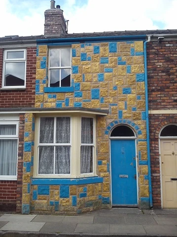

As seen on TV
359
Clearly the Coronation street house above was built from stone hundreds of years ago. At a later date the other brick houses were attached either side. I’ve seen loads of these stone houses around that have had much more modern houses built around them.
