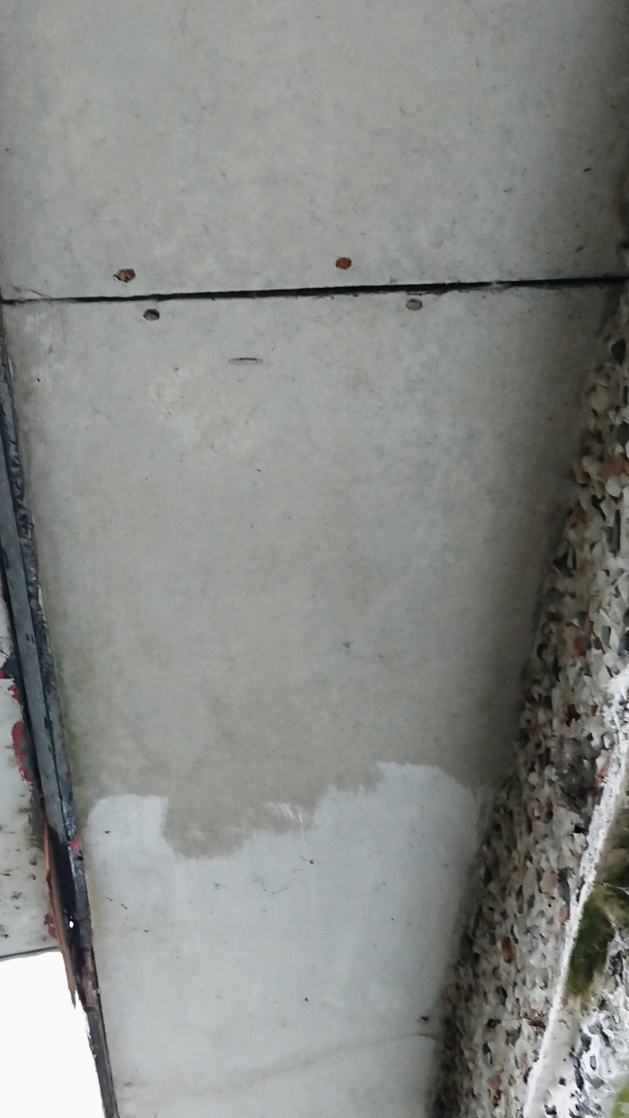

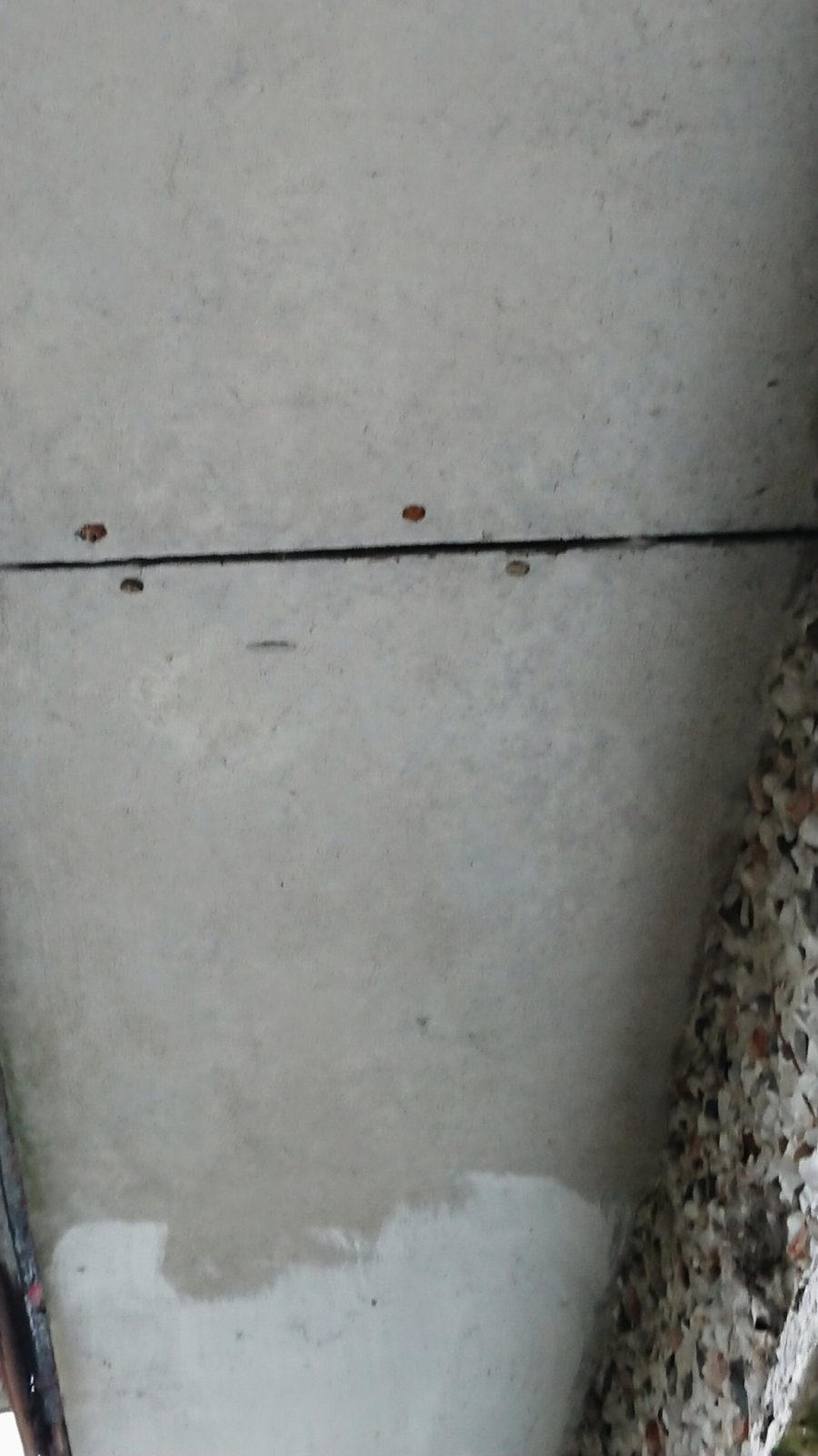

Asbestos or not??
If it's cement board (the least harmful) then if the contractors are suitably trained, then they can remove it.
If it's AIB ( more hazardous), and it looks like it may be if pre-2000, then it can only be removed by a specialist licensed contractor, and this will be different to any PVC fascia contractor.
You'll only know which it is from a test.
You may be able to over clad it
Sorry, I forgot about the spots. No, you should not drill or cut cement board (although you can potentially think something up to deal with dust as its outside), but definitely not if it's AIB.
Its asbestos cement as confirmed by a roofing contracting as I had to get work done on the roof.
He also said that it will be no problem to drill through for downlighters, I know woody said not too but do I wait until I get the PVC overcladding and leave enough space to include downlighters so I don't have to cut the existing soffits??
