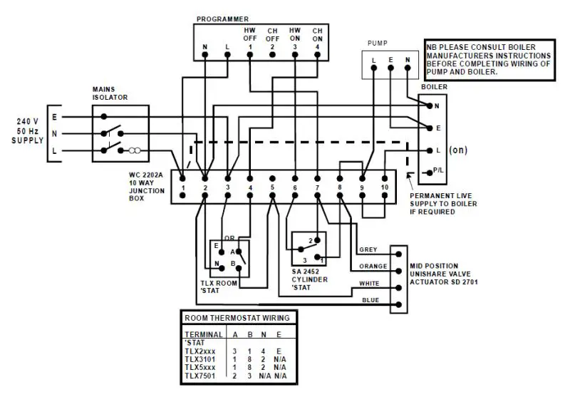

So - I have a Bosch condenser boiler and conventional thermostat, timer etc. I noticed recently that when I selec tcentral heating on the timer control, the hot water also comes on. I started a thread about it here:
OK so I removed the valve head unit (Sumvic SD2701) and checked - the valve spindle could still be turned by hand with a little effort. So - I replaced the head with an identical new model from ebay and had an electrician wire it in. The SD2701 has a slider to move between 'Normal Use' and 'Flushing Only' and this is pointing to 'Normal Use'.
Here's the problem. If I select 'hot water' on the timer the boiler fires up immediately. If I select 'central heating' tho, nothing happens, although the timer light comes on to indicate CH 'active'. I've checked the thermostat and the system pressure; both fine. If however I keep the timer on 'CH' and move the slider to 'Flushing Only' the boiler will fire up immediately. If I then move the slider to 'Normal Use' the boiler stays on.
Any idea what is going on here? What does the 'Flushing Only' setting do in terms of the valve - does it open the valve to both CH and HW ? I've read that other valve heads have a slider to move between 'heating' and 'hot water' - what is different about mine ?

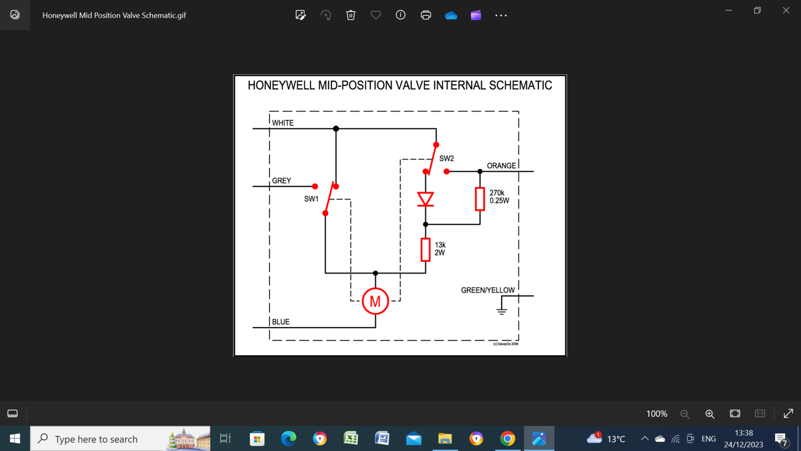

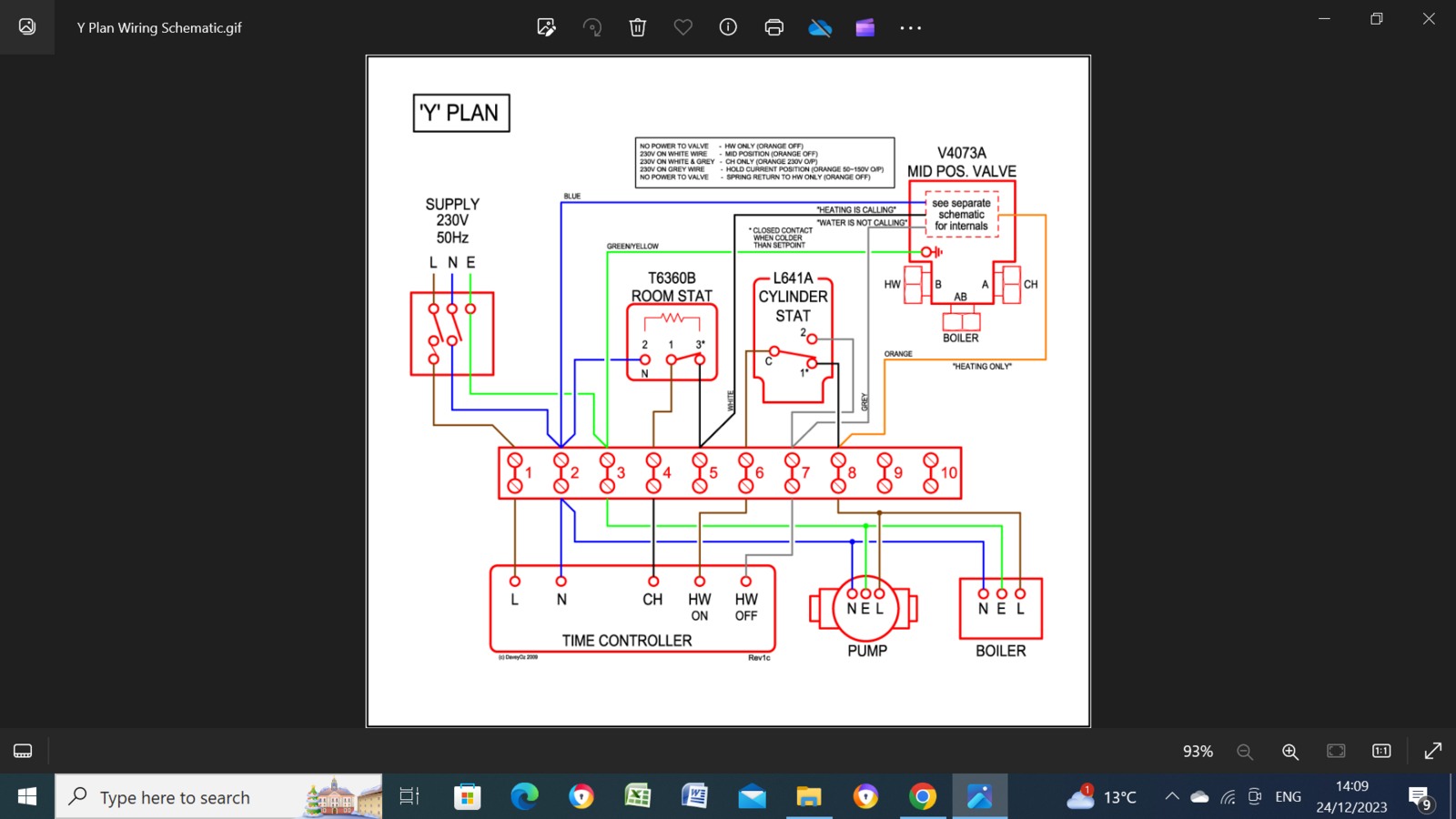

When you select CH, do you mean CH only or CH and HW?? If Ch only then and if wired like the Honeywell (below) 230V should be supplied via the programmer CH on request & the roomstat and the white wire to power the motor via internal switch1, the valve will then start moving across towards mid position and switch1 will then switch to the grey wire and if HW is not requested then the HW OFF contact (on the programmer) will supply 230V to continue driving the valve to fully over and switch2 will then provide 230V to the orange wire to fire the boiler. IF HW is/was also requested on but if the cylinderstat is satisfied then it (cylinderstat) will provide the 230C via its contact2 to drive the valve fully over with switch2 again providing 230V to fire the boiler.
So, above when you move the lever to flushing only (mid position), and the boiler fires up and remains firing when you return the lever to "Normal" does/is the valve then move to the CH only position, hard over, with onl port A (CH) open??.
IF so, it looks like you are not supplying 230V from the CH on request and the roomstat to switch1. You say you have checked the thermostat, I presume this is the roomstat?, and how are you checking it?, do you have a Multimeter that you are actually getting 230V on its contacts?.

Ah - unfortunately I haven't been able to inspect how the valve moves - I'll check that. When I say I 'check the thermostat' - and yes I mean roomstat- I only mean it's turned up - I haven't checked the output from it.

Question - Is the wiring and operation the same for a Honeywell and a Sumvic (I have a Sumvic SD2701).
All wiring for a Y plan or an S plan would be standard regardless of the make of valve, as long as the number/colours of wires from the valves and the function are the same.
Comparing it with the Honeywell it does look the "same"
Re your original post, when you get it to operate like below, is it just CH that comes/stays on and is that with CH ONLY selected? or is it with HW selected as well and the cylinderstat calling?.
"Here's the problem. If I select 'hot water' on the timer the boiler fires up immediately. If I select 'central heating' tho, nothing happens, although the timer light comes on to indicate CH 'active'. I've checked the thermostat and the system pressure; both fine. If however I keep the timer on 'CH' and move the slider to 'Flushing Only' the boiler will fire up immediately. If I then move the slider to 'Normal Use' the boiler stays on."

Yes - so if the Sumvic is in the 'normal' position and neither CH nor HW are currently active on the timer - and I then press HW ONLY on the timer, the HW light on the timer comes on and the boiler immediately fires up. I've noticed at the same time that both the HW in the taps and radiators gradually get warm.
If I then cancel HW - boiler goes off and HW light goes off. no problem.
If then as before with nothing active, I select CH ONLY on the timer, the CH timer light comes on - but the boiler DOES NOT fire up. zilch! If however I move the Sumvic slider to 'Flushing Only' and then back to normal, and try again , the boiler fires up. I've noticed that again, altho only CH selected in thi case, both the HW tank and radiators get warm.
I'm wondering whether the three-way valve is too stiff to be moved properly by the motor. I did take the head off and turn the valve spindle by hand - - and I could - but there was some resistance - it wasnt completely easy to turn, if you see what I mean.
