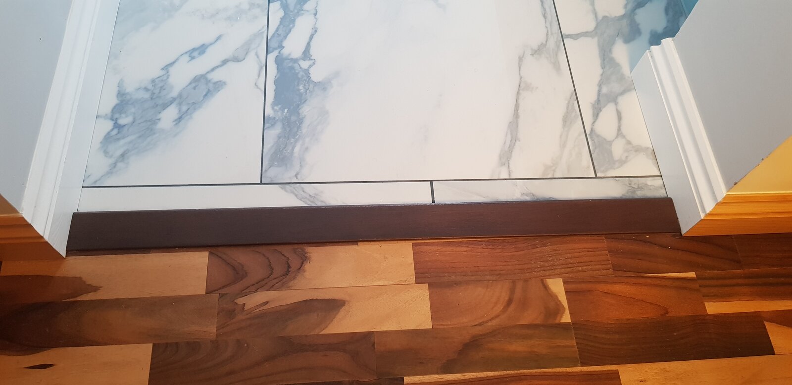

Hi There,
I have a requirement for a threshold strip to go from from bedroom wood laminate floor (lower) up to bathroom tiling (upper) - but heres the problem; the height varies across the entrance width... from approx 22 - 28 mm (the tiles are level across the gap, but the laminate flooring isn't).
Is there anything out there that might be able to cope with this ? Perhaps some sort of flexible strip perhaps ?
TIA
BB
Do you have a router?
If so, you could make your own threshold with a suitable piece of wood.
I've done hundreds in my working life and last one a few months ago.

Thanks Johnny - that looks great! I don't - but I'll have a look into getting one.
