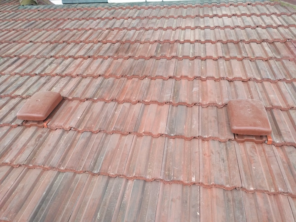

We got an ub19 from ubbink. They don't look as good but they have a low resistance. Make sure you get the adaptor and felt sleeve.
They have a version for most tiles but if not you have to use the universal one. Have a look.

In case it's useful, these are the ub19, just went up to take this photo of ours. These are on 16x9 tiles in our case.
