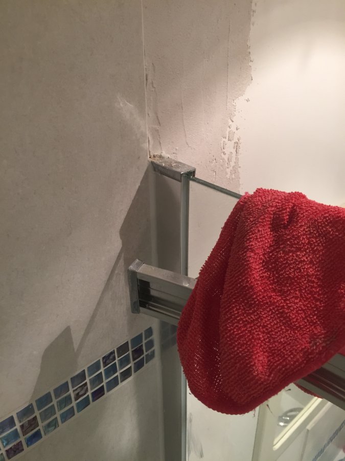

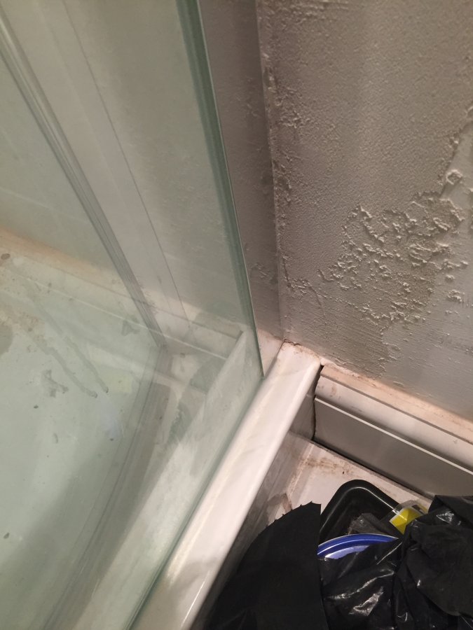

The next thing I've realised is that I think my handyman didn't realise the shower enclosure adjusted and installed it on its smallest setting, further into the corner than the previous enclosure, leaving ugly filled vertical channels on either side. Maybe we'll try removing the enclosure, adjusting the profiles, tiling further out, and re-installing everything.

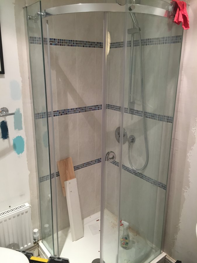

Sure. This is how it is currently. Let me know what you think.

Not a pretty sight. But, providing there are no leaks, it can be smartened up.
Is that a pic of grout covered tile?
You cannot extend the enclosure - or you will run into the rad valve.
You have caulked in the jambs - have you water tested them? Have you water tested anything?
Where are the "ugly vertical channels"?
The ugly vertical channels have now been filled up with that grey filler, which you can see on either side of the shower! That's where the old enclosure screwed into. I'm thinking it would be difficult to extend the tiles, since the one that's been cut is on the inside rather than the outside. And I'd only get a couple more centimetres because of the tray and, like you said, the rad valve.
That's right, the sides and the bottom have been caulked. I haven't had a chance to water test them yet, because the silicone was only put on in the week. But it looks pretty good so I'm confident when I do test it. The handyman also caulked the inside at the bottom, which I know isn't usually recommended, but since it's frameless, I think I might get away with it.
I think I have to at least take one or two of the middle tiles out, because the handyman used compression joints behind and I've heard that can be a problem. The bottom also needs to be re-caulked, because the handyman used that bit of propped wood you see in the photos to force the frame out so the door would fit and siliconed it in that position. I removed the wood while the silicone was still wet and managed to adjust the door to fit even in the non-forced position, so I think the bottom just needs re-sealing.
