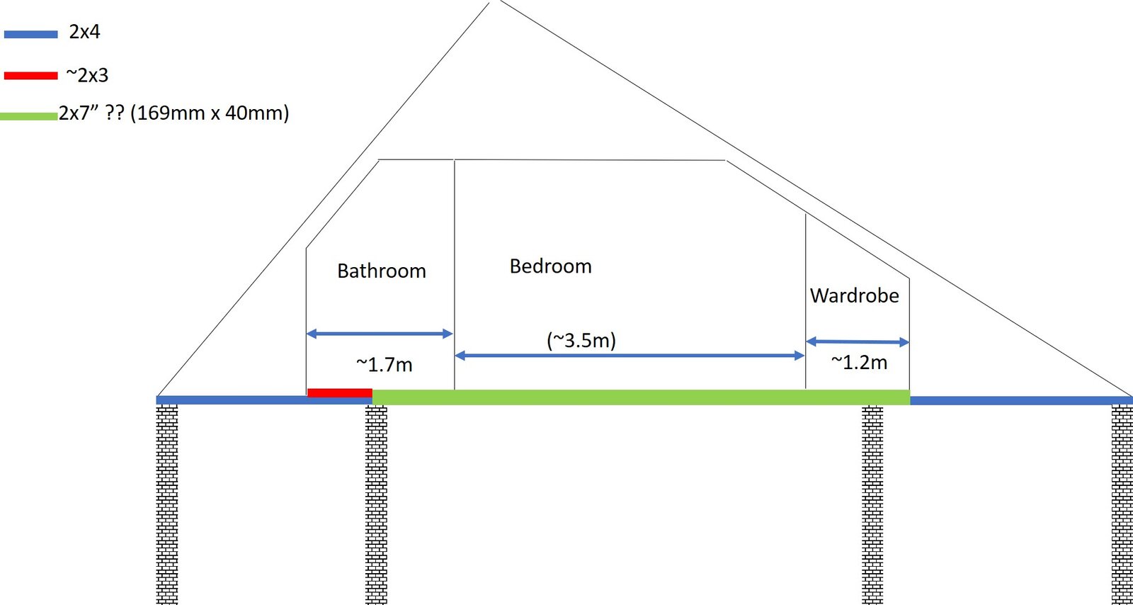

I am doing up our new but 50 year old dormer bungalow and need some advice on the floors. The upstairs floor is sagging and appears to have undersized joists (16" centres, ~5.2m span, 2x7" joists). To complicate matters, the area is divided by two partition walls (bathroom and wardrobe/storage) and in the bathroom has a section of 2x4 joist with extra timber on top to level the floor. The attached image show the layout. So I am planning on taking out the two walls and sistering the full length of the span (and the extra 2x4 bit in the bathroom) and try level and strengthen the floors, before reinstating the partition walls. Then floor with marine ply for the bathroom and regular ply for the bedroom. I was wondering if the deflection after all this will be reduced sufficiently to install tile backer board and tiles on the floor of the bathroom or will this just crack and fail in short order. I don't really have the head height to install deeper joists so this is all I can think of doing to remedy the floors, but if anyone has suggestions it would be a great help.

Undersized is an understatement. Even when you double up the calculated deflection is just above the allowable maximum of 14mm and that is using c24 class wood.
169 x 40 isn't 7 x 2in (178 x 50). That would be 6-3/4 x 1-1/2in, which is quite undersized for 16ft 5in span (it should be about 9 x 2in C16). If you go to a higher stiffness spec (C24 instead of standard C16 grade) it would be some help, as would going to a 3in (75mm) wide joist as recommended above. I'd suggest doing both and put in a couple of rows of solid strutting to reduce bounciness. Plywood flooring should be glued to the tops of the joists (D4 flooring glue not PVA) as well as screwed

Whether or not they were designed that way, those walls appear to be acting as structural elements and cannot just be removed without something else being installed in their place. If you can't increase the depth of the joists sufficiently, it looks like you may need to consider installing a couple of (sectional) steel beams at right angles to the joists to improve the strength of the floor. This is perfectly doable, but is notifiable and will require structural calcs to be done by an engineer
Well for the time being the place is being stripped. Things only coming out including a cast iron tub that weighted a lot. I remeasured the floor joists. Definitely 169...ish some measurements were 167mm some as high as 172 but for the most about 169-170. Did get the width wrong closer, to 42-43mm. Was writing off the top of my head at work earlier. The reason why I thought 7x2 was because my local providers were saying that the finished size for 7x2 was 170mm (link removed) The wood currently there has been lived in for the last 50 years and although has a bow, it isn't very bouncy to walk on. There are noggins fitted in the bedroom part so maybe they are keeping the bounce in check. With out changing the room height , I guess all I can do is get the best grade wood I can and as thick as possible. I'm guessing that tiling the bathroom floor is probably off the cards.
For simplicity in the drawing I showed two walls holding up the offending span, but in reality the prior owners have removed one of the walls and replaced it with an I beam (no pad stone - dodgy red brick and concrete!) I'd be concerned about running more steel of this rsj. Have to get an engineer to look at the steel that is there as it is. Maybe they will do a two for one, if they ever return my call. Might call a company tomorrow about lvl joists. But I suspect if I not building a great big shopping center they won't be too interested. Can I ask, what sources you are using for span tables and deflection calcs? Are they point loads at center of span or how it equates to the edges (ie in the bathroom)

I wasn't talking about running any steels off the RSJ (which wasn't mentioned until now, was it?). I was referring to the need to support the joists if you remove the two walls (which will be acting as structural supports for the joists and reducing deflection and bounce). That RSJ, dodgy or not, is reducing the effective span of the floor, and therefore the potential deflection, as is the one remaining wall. If the brick is dense enough it will probably be OK to support the RSJ, although we almost always cast in a concrete pad or insert a pre cast padstone ,(belt and braces). To retrofit one is simply a matter of propping the existing RSJ (Acrow props and scaffolding boards) cutting out a masonry pocket, screwing a plywood shutter to the wall (sealed with expanding foam), then filling with concrete. Takes 2 to 4 days to cure, then the whole procedure can be repeated at the other end. Gaps beneath a steel are generally packed with slate and mortar or steel shim stock and gaps at the sides (if any) are filled with brick and mortar

You could of course put extra 170 x 40 joists in to give 133 centres which would just bring you within the 14mm deflection limit although your existing joist will no doubt have long term bow effects and will not spring back to the same level as any new joists.

Worked on C24 as if that failed so does C16. Doesn't matter if you use 1 solid joist or 10 thinner joists, if the overall block dims are the same the results are the same.
Calculating deflection using different grade of woods a bit complicated but assuming all the wood was c16, deflection = 16.4mm, assuming c24, deflection = 13.4, so actual deflection somewhere in between but more to 13.4 (based on 133 spacing). Again all based on theoretical 150kg/m2, in reality probably a lot less. Assuming no load except for a nominal 25kg/m2 wooden floor loading deflection = 4mm
