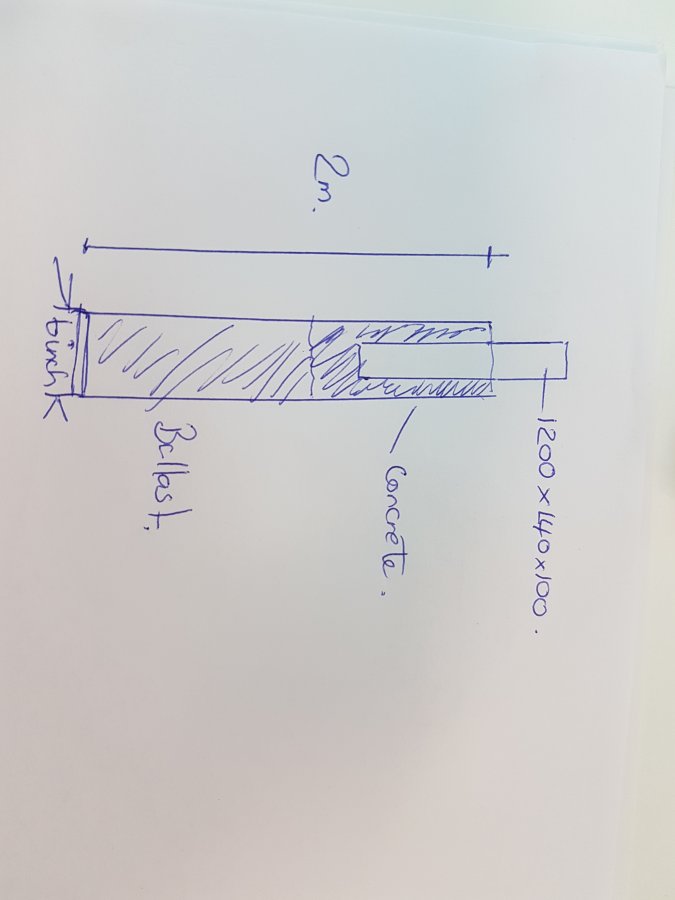

HI I have attached a few rough sketches for base any thoughts appreciated!
Intention is to hire digger 6inch auger go down 2metres fill with 1m ballast then concrete piers in.
Build timber base and bolt to piers using 2 x m120.
Personally, I wouldn't exceed 1.5M between posts, I think your centre and 8M run are a bit long at nearly 3 and 4m unsupported.
Also 8 x 5 is over the 30M2 limit allowed, so do you have your Planning and BC sorted?
Thanks buddy yes reduced it to 6x5m as a tree was in the way. Going to take your advice and keep 4 across and add 4 across middle also so 12 piles, 1 every 1500 on 6m and 1250 on 5m.

What I'd do:
Make up the external parts of the frame "the box", attach at least 4 of the posts to the frame (the corners) drop them in the holes, prop them up with blocks or whatever from ground level until level, use a couple of standard beam levels to get the levels right on the long beams which you'll screw/bolt to the sides of the posts. Mix your post crete and concrete those 4 in, give them a good rodding to fill the air gaps, check the levels and gently tap down if needed, leave it a couple of hours (or over night), attached the remaining posts and fill.
Personally I think it will be friggin hard to get the post depth right for a level floor and you'll probably want them suspended and let the concrete fill the gaps. As long as you've got 4 set right the rest should be easy.
