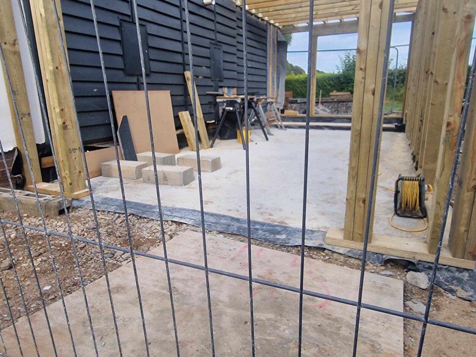

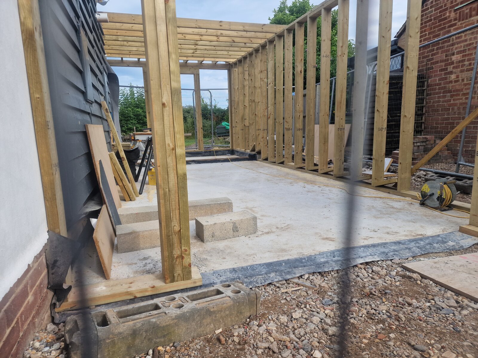

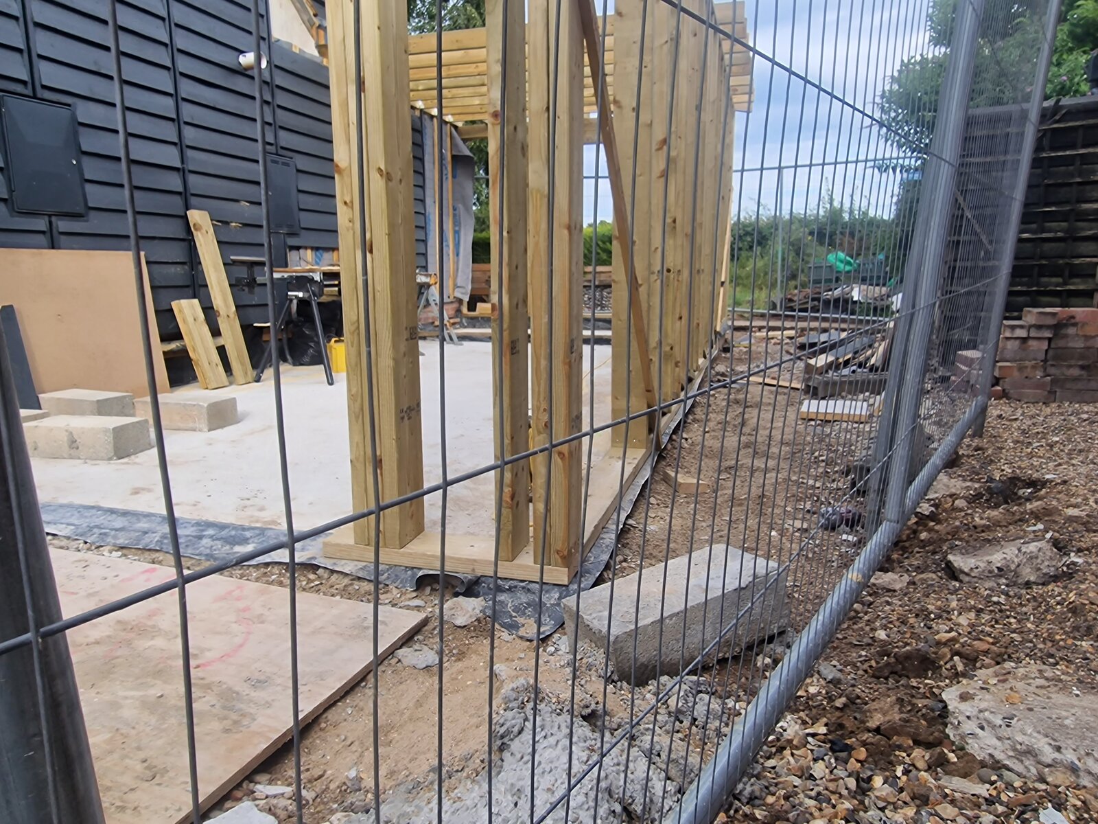

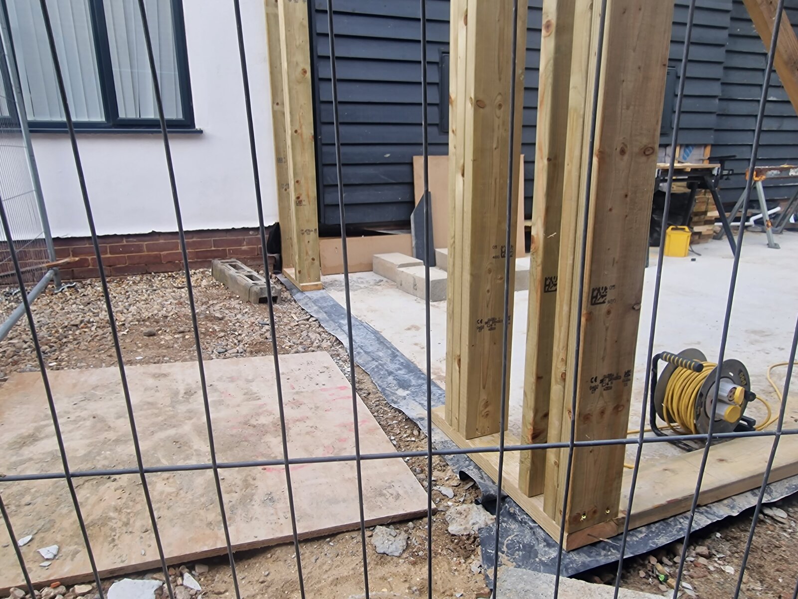

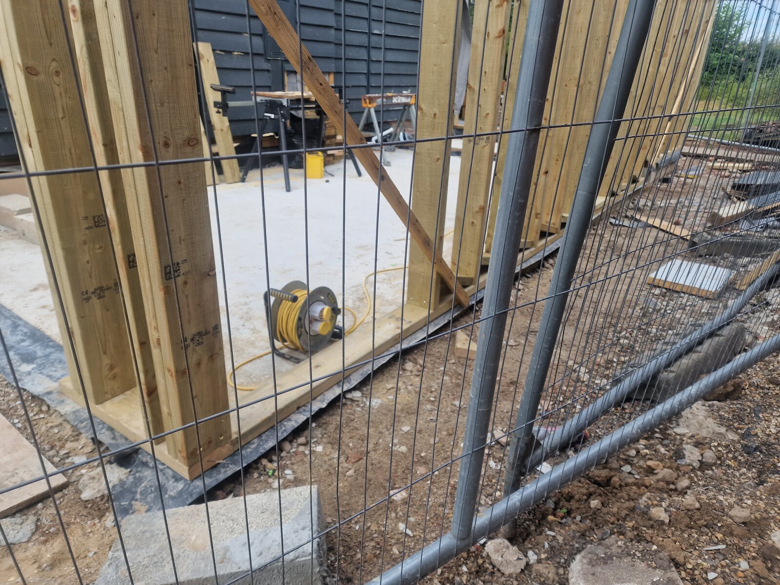

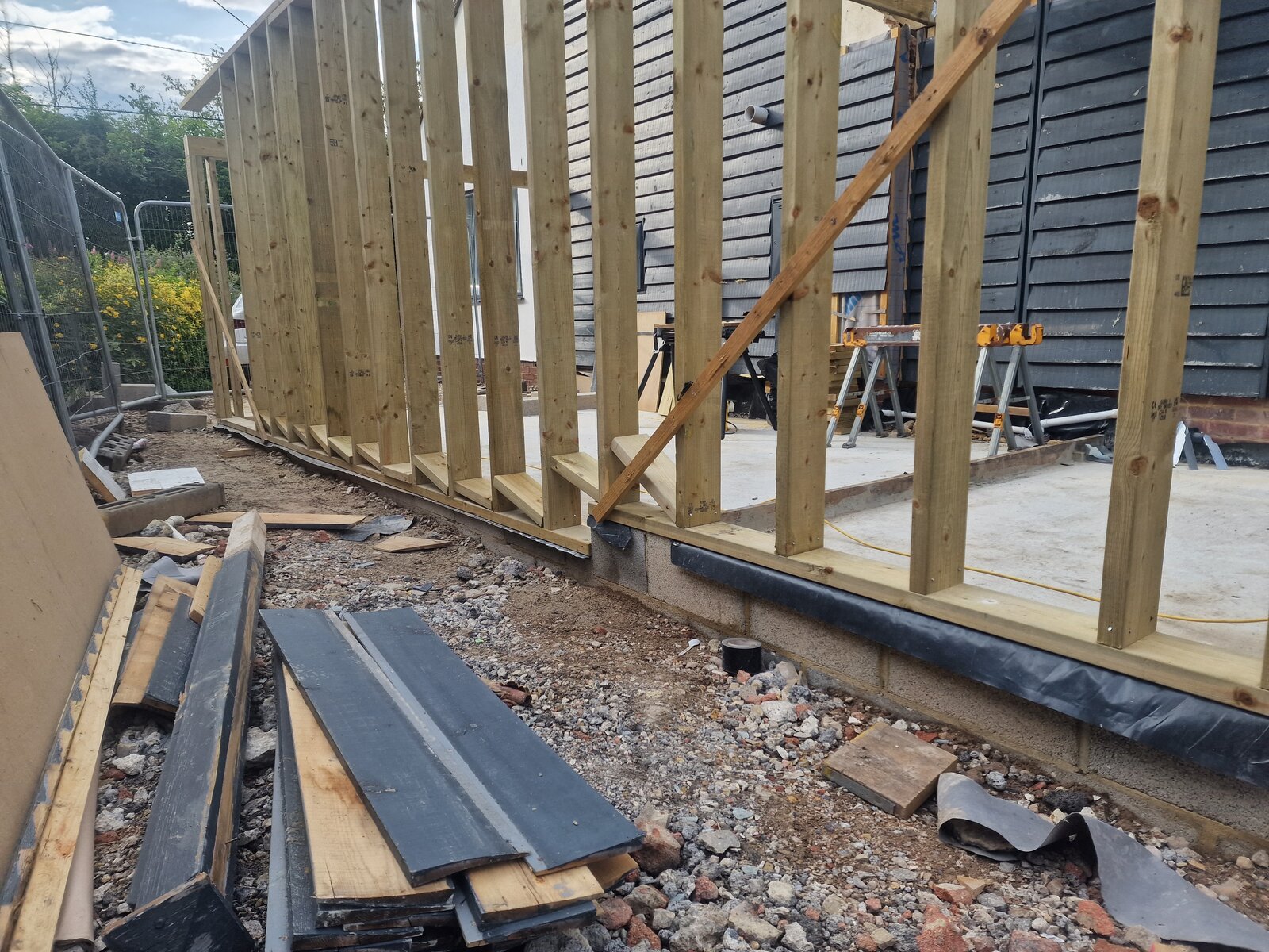

Hello all,
My mum is having a timber framed extension built on to her house (side extension).
The extension has a utility room at the back and garage at the front.
The damp course around the utility matches the house as you would expect.
However, the garage wall drops down 150mm where the damp course is barely 10mm above ground.
The builders said a garage floor has to be 150mm lower than the house which turns out to be correct (some fire regulation).
While the floor has to be lower I don't see why the wall should be lower. In my view it should match the height of the extension with only the floor dropping.
The builders have accepted that the damp course is low and said they would put in drains.
I would love to hear your opinion on this. My view is either 2 things should happen:
1. Pause construction and have the plains changed to a habitable room instead of a garage (my mum does not intend to use the garage as a garage, only storage).
2. The walls of the garage should match the wall of the utility so damp course follows through. This will not effect the concrete floor which will remain 150mm lower as the utility will be insulated and screeded.
I have attached some photos and would love to hear your opinions.
Many thanks.

The last photo shows how the wall/damp course drops down between the rear utility and front garage.
The first few photos show how low the damp course is.
Many thanks
Garage floor should be lower or a raised step 75mm between the garage and the house.
The DPC does not need to be lower.
A timber frame (where the frame is the external wall and is clad) must be at least 150mm above the external surface level irrespective of the DPC level - although the two are normally the same.
What do the plans say?

The base timber plate is about 20mm above ground level.

In places that base timber plate is BELOW ground level.

He said this wasn't a issue. Well building control disagree and they have now been forced to re-do the DPC following the block all the way through.
