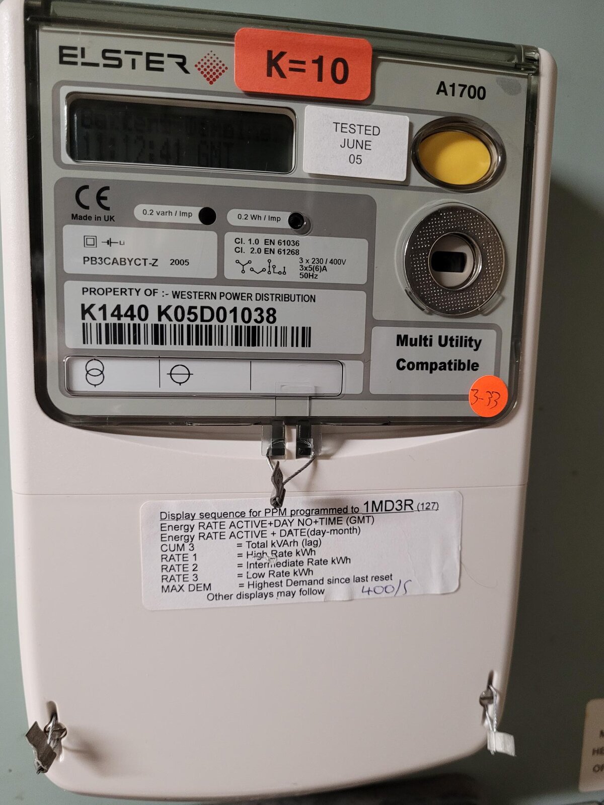

I am chairman of owners' committee for timeshare development of 11 apartments. All heating is electric night storage radiators and we are on a dual rate tariff. I've recently obtained half-hour meter reports from the electricity supplier and noticed a metering/billing anomaly. The night rate period is 0000-0700 daily (I believe this is standard). When I look at the HH report, consumption in the final HH period each day (2330-2400/000 jumps significantly, clearly showing that the heaters are energised at 2330 (day rate) instead of 0000 (night rate). My question is - what switches the night-rate circuits? Is there a central time clock for the development that is on the "consumer side" or is there a time switch installed and owned by the DNO or electricity supplier?

Could you post a photo or 2 of the incoming meter(s) etc?
Sounds like the off peak isn't being controlled by the supply meter so there could be a timer / contactor involved
This is the supply meter.

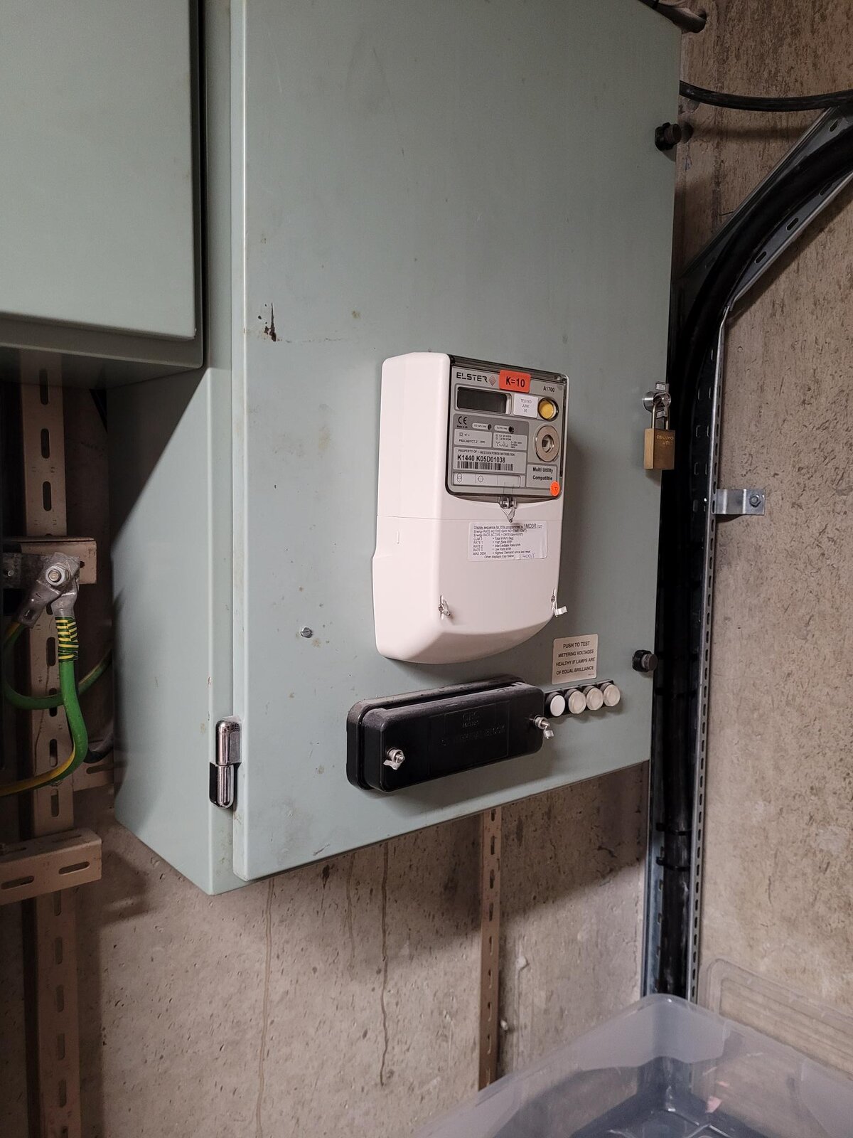

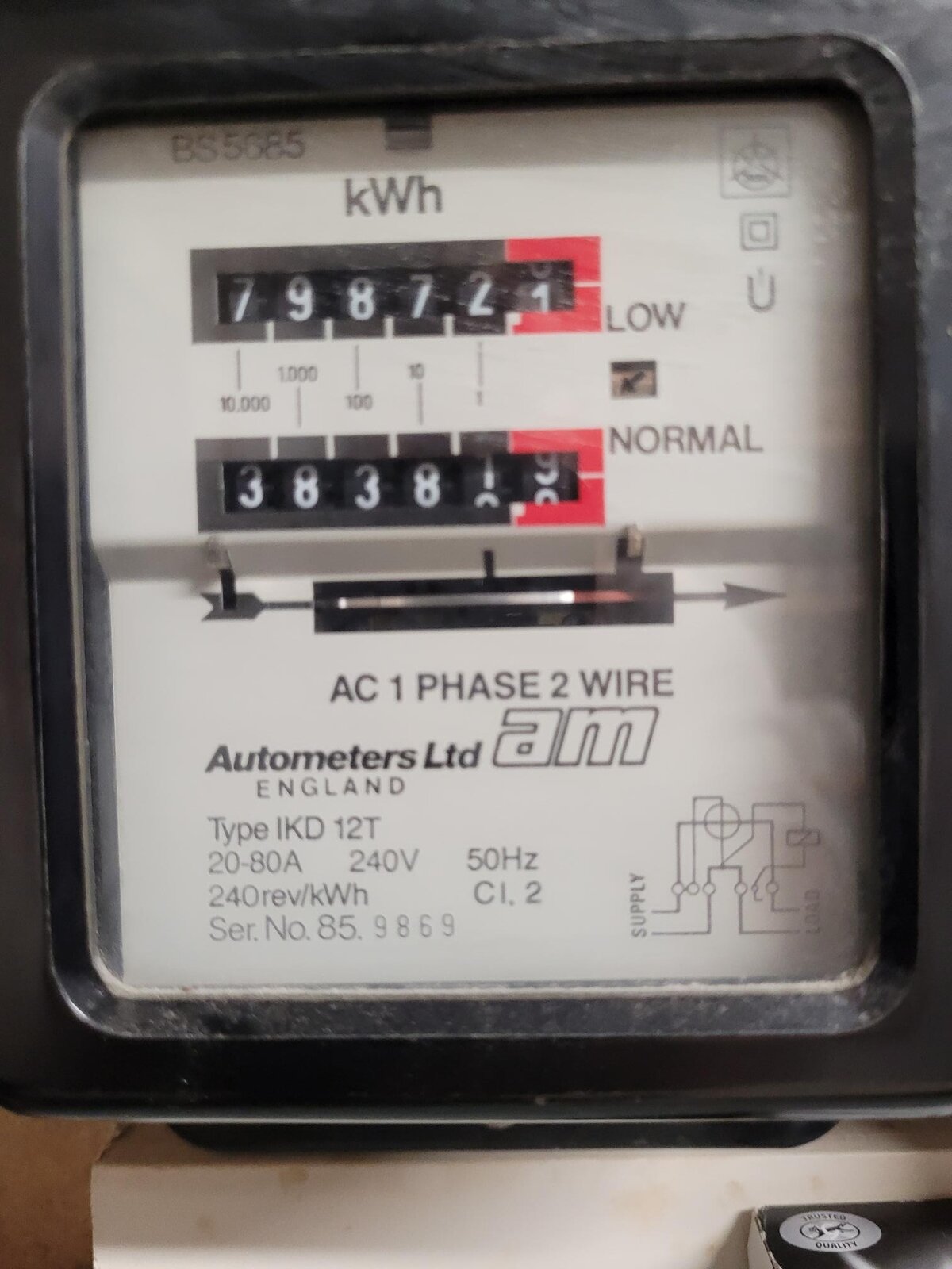

Couple more pics:
1. Supply meter location
2. Bank of sub-meters used to recharge weekly consumption to owners/occupiers.

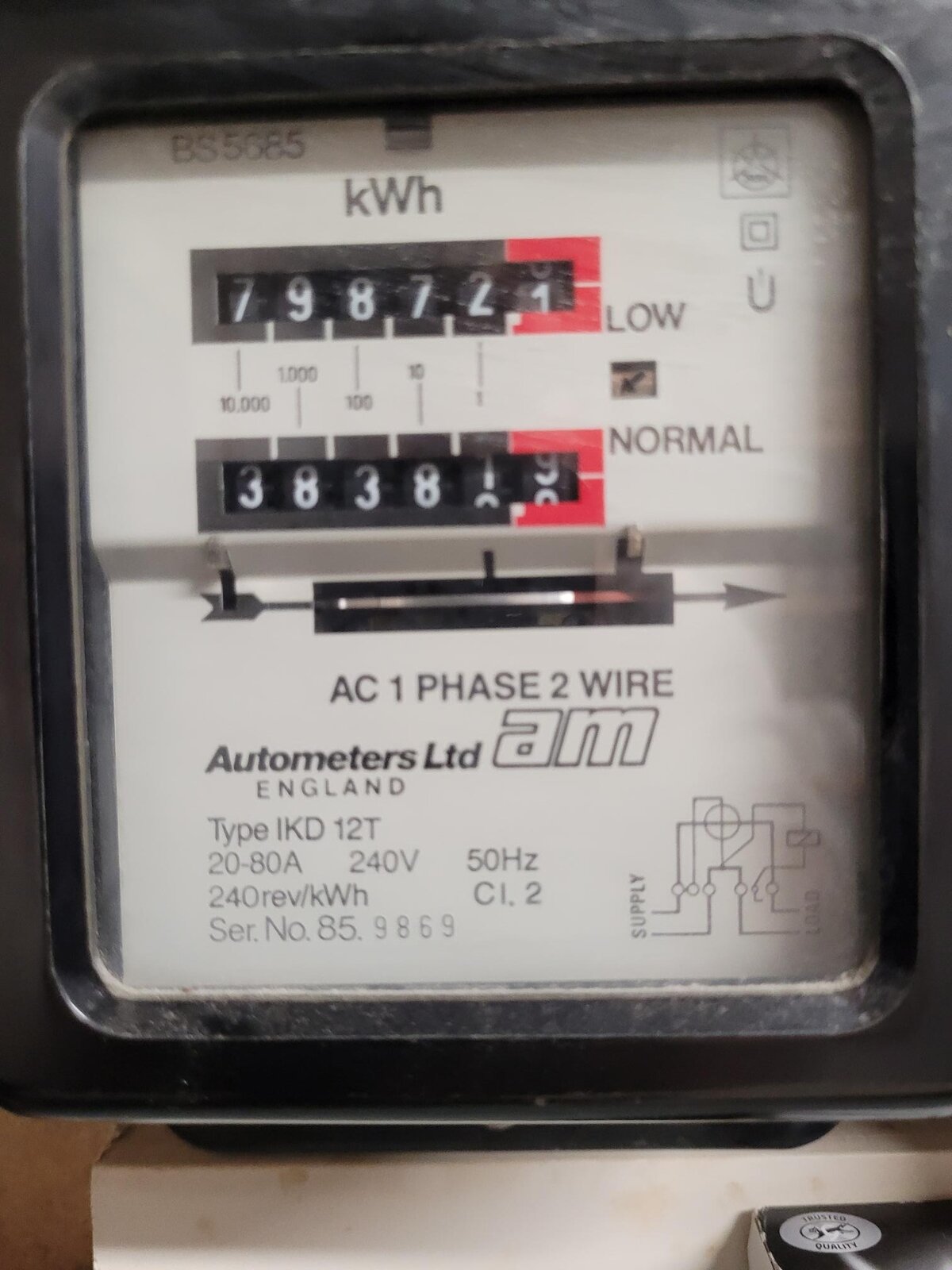

3. Close-up of one sub-meter
With regard to 2, I presume that the 'low' and 'normal' registers of the sub-meters are separately wired to the 'day' and 'night' circuits at each apartment's CU.
No, those are 4 wire meters and just switch to one register or the other, so whatever is used is either at the day rate or the night rate. They do not have any load switching capabilities.
There are either timeclocks at each apartment, or a central one which switches the storage heaters via individual contactors. Possibly in one of the grey cabinets where the modern meter is.
That metering room is not a suitable location to store items, those batteries, television, cardboard box on a shelf, the shelf itself and whatever else is in there needs to be removed.
Check the timing statements - is the timing in BST or GMT?
