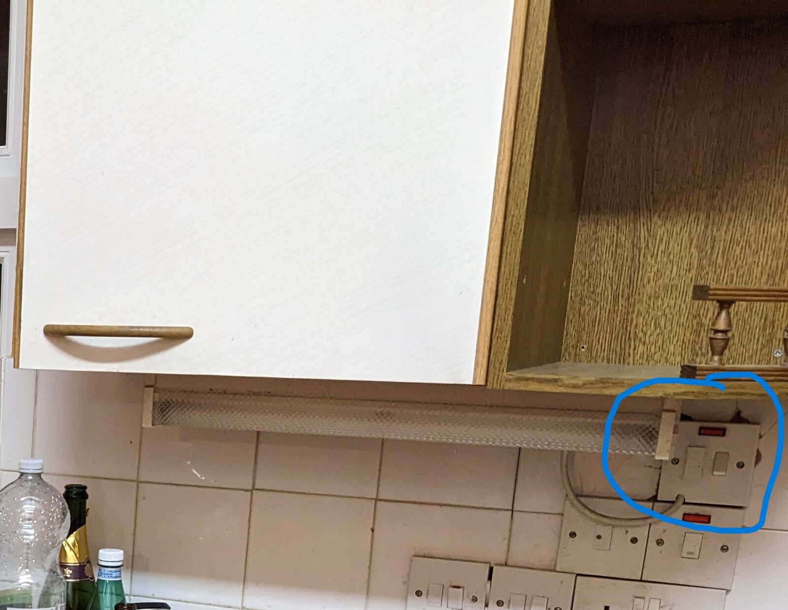

Hi everyone, electrics novice here!
I need to remove a wall unit in the kitchen. Attached to this unit is a light, which is connected to the wall. The wall socket it is connected to has a switch and a fuse.
Any tips on how I might be able to disconnect this (safely!)....or is this a job for a pro?
Huge thanks in advance and hope the photo helps!

do you fill you could take the front off the spur and remove the load wire - isolating the supply at the consumer unit to be safe
Take off the face plate and disconnect the cable serving the light but make sure you isolate the supply first and test for dead. Ideally replace the switch cover as the entry hole is now exposed
Are you planning to put the fitting back?
If yes, I would just take the fuse out of the holder (in the fused switch unit) in the meantime.
Thank you! So turn off the electrics at the main board/consumer unit >> then make sure switch turned off on socket >> open the socket >> and then detach the cable that runs from the light to the socket?
Should I also remove the fuse too? Not intending to use the socket again so should I do anything to make sure this is all safe when switching the electrics in the house back on ?

Just to confirm, to "test for dead", I would need a voltage tester?
and to "terminate the main feed cable", what would need to happen here?

yes a voltage tester - you could just have the light on and then isolate the consumer unit and make sure light has gone out \
BUT a good tester is whats needed to be safe
also if have rcd then touching the neutral & earth may trip those or neutral touch an earthed back box
blanking plates are at screwfix or tolstation
various styles available
i would use something like this
but the correct size for the cable,maybe 30a if connected to a 6mm cooker connector or smaller if ringmain 2.5cable - as no current flow, can be a low amperage , providing cables can easily fit and be screwed up - and as you can access it - then no need for a maintenance free connection
or wago connectors
