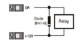

I am looking at upgrading to texecom (wired) 24 or 48 + 8xp I am wanting to switch outside lights on when the alarm is actavated.
the 48 has the capability of the RM8 board. but the 24 has not I am lead to believe, I would never use more than 10 to 12 zones so think the 48 would be over kill, is there an alternative way of triggering relays on the 24
thanks matt
Just wire a standard relay to an output ! , elmdene do a mains switching relay or my favourite a gjd lighting system ( you can override with a relay input )
thanks for the quick reply:) . I think I might go for the output as in the manual I just down loaded with a 12v relay . but the gjd systems do look good ,
