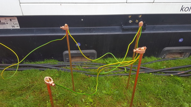

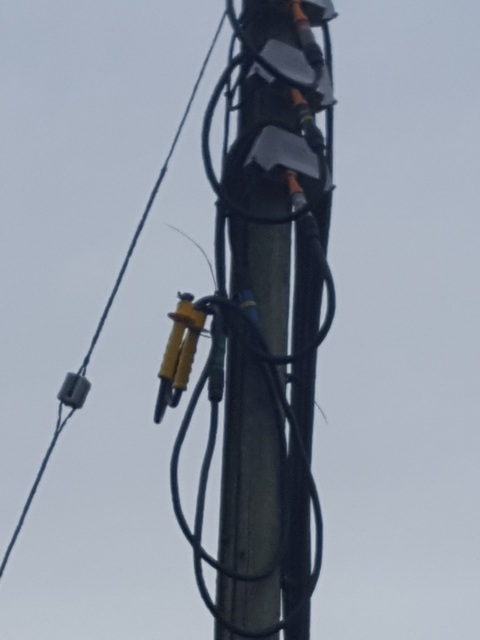

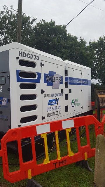

As title, UK power networks were doing some pole replacements locally so our little bit of Norfolk was fed by this "little" genny" and the 150mm csa cables were plugged into the links/fuse holders at the top of one of the poles . Nice arrangement of earth rods with what looked to be 10mm cable connected to the genny!
Perhaps someone on here might like to enlighten me and others about exactly how the temp set up is "set up"

Interesting did the power go off to change over?

Yes the power went off for about 5 minutes in the morning and about 5 minutes in the afternoon both at the time we had been prewarned about. so well done to UK PN. I took a drive round to see what they were actually doing and I saw at least one pole in the process of being replaced. it was about 100m into a field. a muddy field! thanks to last nights heavy rain. Nearby the overhead cables were joined together with Large " jump leads" and were tied down to another earth rod array.

This is a link point, the fuse carriers are where two circuits meet, fuses can be inserted or links to ‘back feed’ one circuit and the fuses removed at the transformer end
Obviously in this case the two transformers serving each circuit were affected by the outage so they had to use a generator. They’ve possibly connected it here so they could get it all set up, then drop the fuses at the transformer, and then switch the generator on with minimal downtime. They don’t tend to synchronise grid and generators
Normally on the ones I’ve seen, the earth rod is usually just pushed or hammered into the grass verge, it’s only a reference point for the centre point of the generator, obviously on the overhead line there will be other earth connections as part of the network. They should test to confirm phase rotation and earth loop impedance as well as polarity, but quite often they just connect and switch on, which can have issues. It’s not uncommon on older networks to have odd phase sequences
The synchronisation used to be done with either lamps, or meter between the two supplies..
No what I meant was they switch off the mains before switching on the generator so a short interruption. Rather than synchronising the generator and the mains and then switching off the mains, so no interruptions

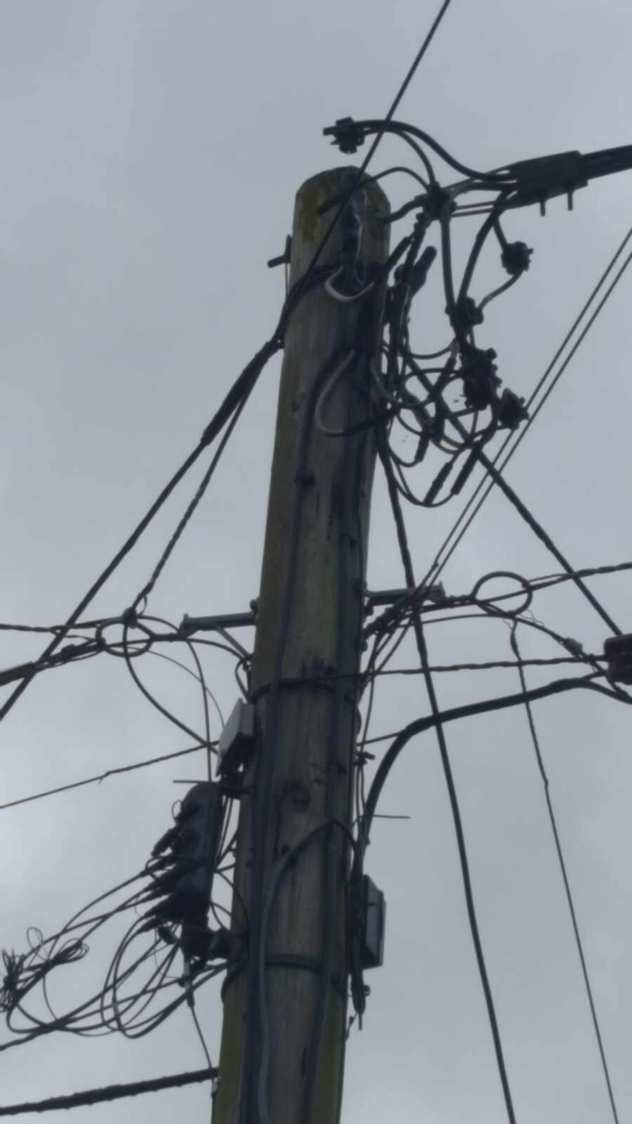

Is it just me or do others agree that "up-the-pole" cable installations of the 21st century are really untidy compared to that of my younger years (1960s onwards)
dont know what you mean.... this is the elec and bt pole in my front garden20230923_140733 - Copy.jpg
